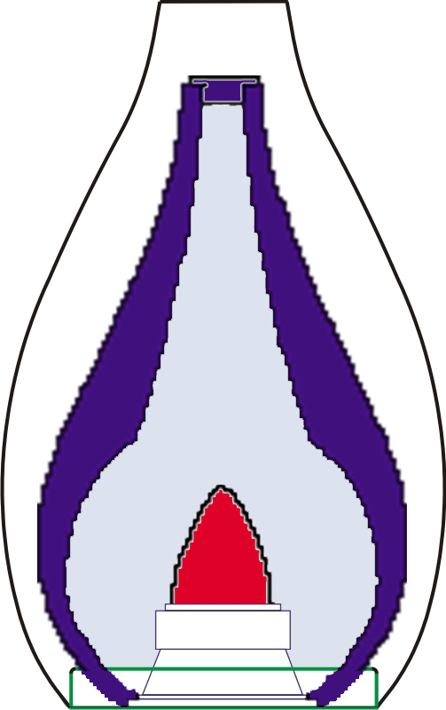

I think B&W research on spherical enclosures with tapered tube rear wave absorption is one of the best midrange and tweeter designs. The B&W website has technical information and measurements.
A friend took large styrofoam shapes - sphere + cone - cut them to mimic the B&W shape, sealed them with primer paint, and hand coated this shape with sand-only cement plus fiberglass string mat. When it had hardened he used acetone to melt away the styrofoam. The midrange sound was excellent.

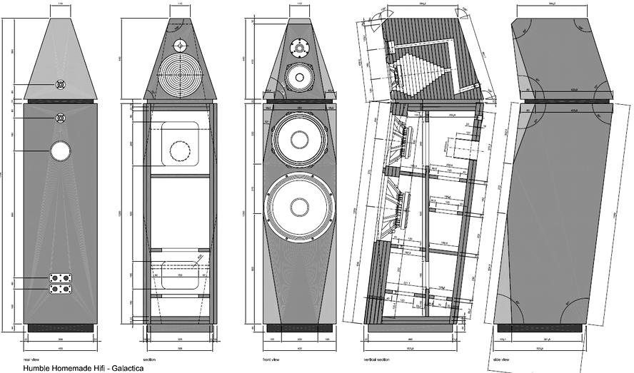

Tony Gee produced a similar shape in his Galactica speaker by stacking MDF cut outs.

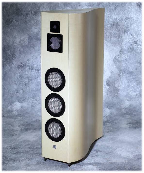

The Lumen White Light speaker uses a bulge+taper in a more traditional cabinet claiming it removes the reqirement for (any? most?) stuffing

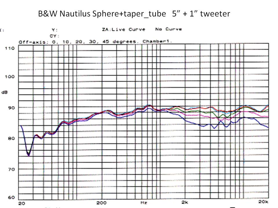

Do you have a link to the measurements on the B&W website? I cant seem to find them.

The B&W nautilus designs are for the most part an acoustic labyrinth that has been coiled. So for waves that travel back from the driver, it works... waves that travel perpendicular to that plane, it's not quite as wonderful, except to the extent that the "back wall" appears to be nearly infinite.
Round walls are reflectors that focus energy back... so the effects and the problems are different, the pattern of nodes inside the enclosure is different, more so as frequencies go higher.

B&W has a few white papers on the development of the Nautilus 801 speaker which include measurements for the midrange and tweeter sphere+taper_tube.
Some of the white papers have been mirror'ed.
http://www.hifiportal.co.uk/Articles/Article0026-Development of the Nautilus 801.pdf

As they are now, I made the best possible copy of B&W shape. Teardrop on the outside with the inside a sphere with cut of back and prolonged to a funnel with exhaust (insert better description here....)
