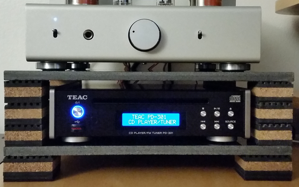

I needed a simple stand for my office/Den system so here is what I came up with.
The tiles are 12" x 12" Black Granite from Lowes $4.98 each
The corners are Rubber/Cork Anti-Vibration Pads a box of 48 for $12
I glued the pads together and ran then through my saw to skinny them up to the CD player would fit.
I put felt pads under the bottom pads (feet) so I could slide it easier to get to the back of it.
