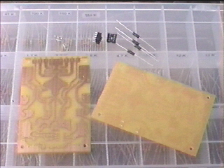

Thought I share this amp to my fellow diyers. Not that hard to build but it sounds good enough for me. 😎
I've tested it with an OPA134 but even an LM301AN will work. Outputs in the prototype are MJL21193/4 (TO-264) but I've tried/tested MJ15003/4, MJ15024/5 (TO-3) with good results. That means it will work with anything you have laying around 😉 .
Supply for the prototype is only +/-50V but has also been tested with a +/-70V. If you use the higher supply, better use a bigger heatsink.
Sound is, as I said, good enough for me. I'm planning on using this for mid-high applications but have also tried it for a 10" dual voice coil subwoofer.

Nice work, I like the way the amps are sat on top of the heatsink with the drivers either side. Also the fact the the heatsink fins are verticle giving the best cooling. When ever I build an amp I always end up with the HS upsidedown or some such poor configuration.
With +-50v its should be good for approx 250Watts into 4 Ohms well within the capabilaties of two pairs of MLJ21193/94.

i was too excited to post the amp and forgot to edit the schematic. however, you can find the values of the resistors in the pcb parts placement guide. The values for the caps are at the schematic.
Hope you guys don't get confused!
The amp is working and playing as I post this message, it has been four days and still no problem.
Anyway, this is actually the second prototype.

Did you try local feedback at the opamp and only a DC feedback for offset compensation ?
A long time ago I made amps like that and they sounded better than the conventional way but measured poorer.
Not negatively meant but I would always decouple supply lines with some caps and around the opamps I would place them very near the supply pins. With the more modern opamps a small cap ( 10 to 100 nF ) directly from + to - pins of the used opamp might be necessary.

Nope, I haven't tried tinkering with the feedback since I am still learning the basics. Happily, I can only measure +0.001Vdc at the speaker output. I have to switch the DMM to the lowest dc setting to measure that. Also, I haven't connected the Zobel and the RL on the output going to the speakers.
I haven't measured the output power since I am yet to find where I can borrow an oscilloscope.

nice work. I'm working on same type amplifier right now. I will use 3pairs of MJLs, and one more driver stage to drive them.
I planned to use with +/-60V to get some 300W/4ohms.

Hi, I did put a 100nf cap on the supply rails of the opamp as can be seen on the pcb parts placement guide. I'll post a more detailed pcb parts placement guide soon...

Killer Amp!!! I am watching the discussion with much interest. May also want to build a version. Do you intend to include short circuit protection in this amplifier (VI limiter). Can anybody out there say how this could be incorporated.

in the late 60's daniel meyer came out with an article in "popular electronics" magazine, 'tigers that roar', then in 1972, he came out with 'tigersaurus' featuring the same output stage as the one you built, even bryston has adapted this design. my experience with this topology is that it is prone to oscillation at high frequency, the output stage trannies heatup even though the bias levels seems to be correct, i would be very carefull with this type of amps, this amp though packs a lot of punch in the low end, thus i would reccomend as suitable for bass speakers, mid and highs are not as good as with leach amps, i would say.....
