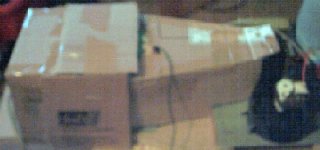

Ok got the psone lcd and it is so easy to strip apart (was a little worried after ruining my last lcd). Set up the light and made a mount for the lcd having trouble finding the fresnels though I have one but really need 2nd. I think I may have to invest in a larger triplet lense as suggested but will look around for a better one. Got it all set up (just holding the triplet) and got a picture on the wall but not great. will work on holding the cables secure tomorrow so I can move things around without worrying about breaking them. I thought the heat of the light might cause a problem but the fan seems to be keeping everything cool nicely.
heres hoping for a productive day tomorrow.
cost so far £77
cost so far £77
(sorry about the rubbish photo's my camera is way old)
Try focusing it, then the pics wont be like looking through glases smeard with vasoline.
Trev🙂

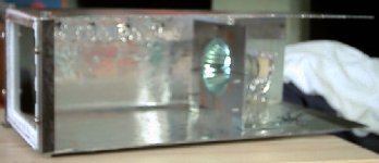

ok restarted using a 75watt halogen now after obtaining inspiration from Markoh this one is looking small enough to shoehorn into a desktop box which will come in handy when I get hold of the gear to make my media centre. I am planning to seal the box with a fan sucking out of the back and have drilled 15 holes in front of the lcd so the cool air will come into the box as close to the lcd as possible.
Oh yeah I smashed the front lens of the light fitting and put the uv filter out of my slide projector in there I am hoping this wont dull the light too much.

I was playing around with the light tonight and it fell face down onto the living room carpet. I didnt notice right away and now have a 50mm burn hole. Wife is not talking to me now 🙁. I am not having much luck doing this.
On the plus side it works pretty well hooked it up to my camcorder and used a simple magnifying glass held in front I was really impressed with the image once I get a decent triplet it will work great. Will post some pics asap altered it a little from the one above.
