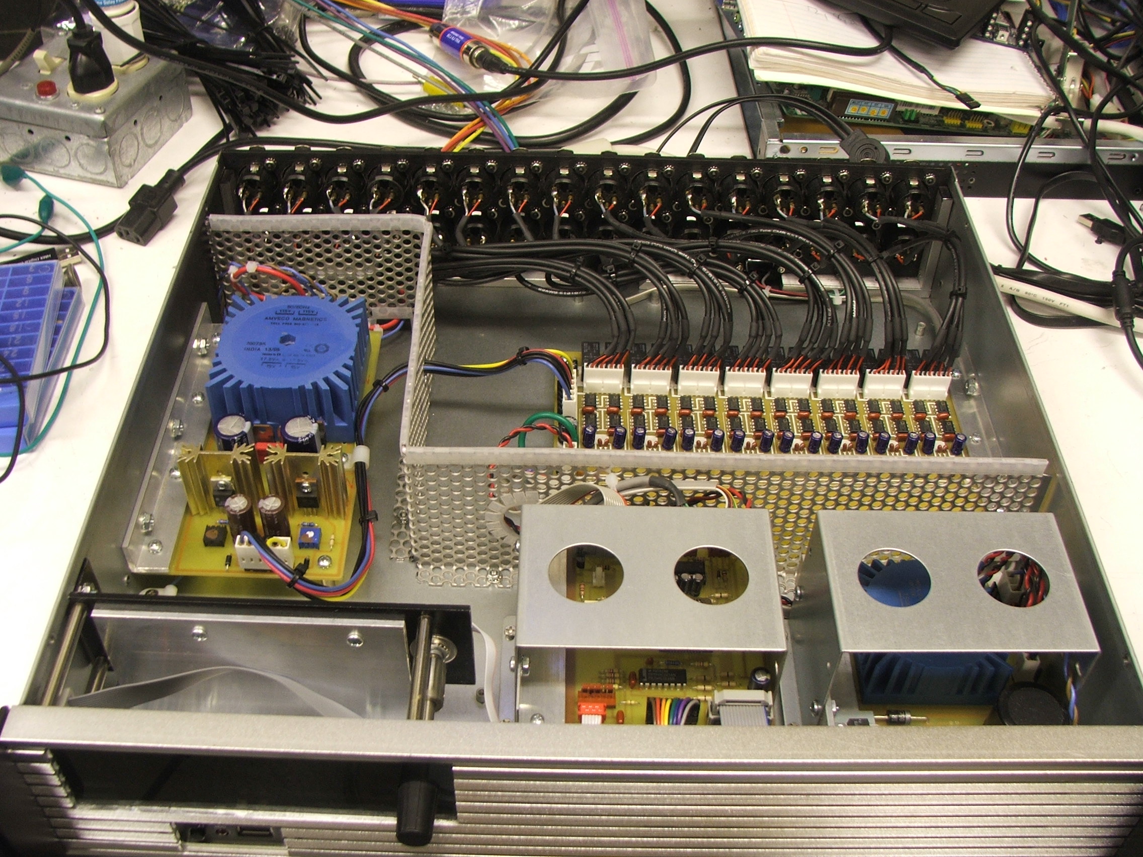

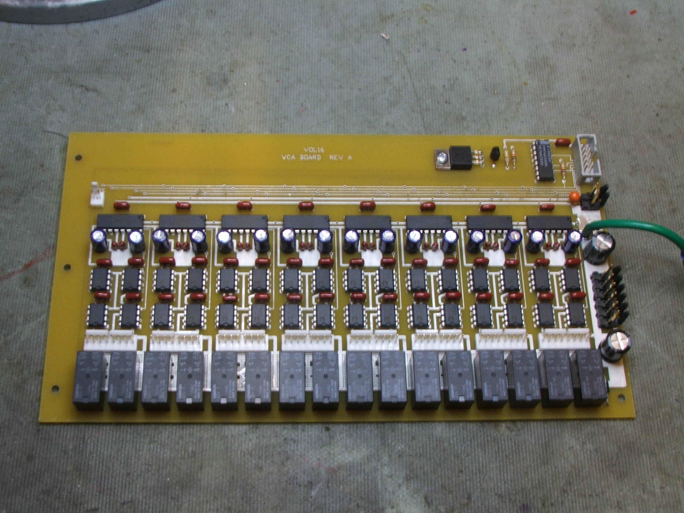

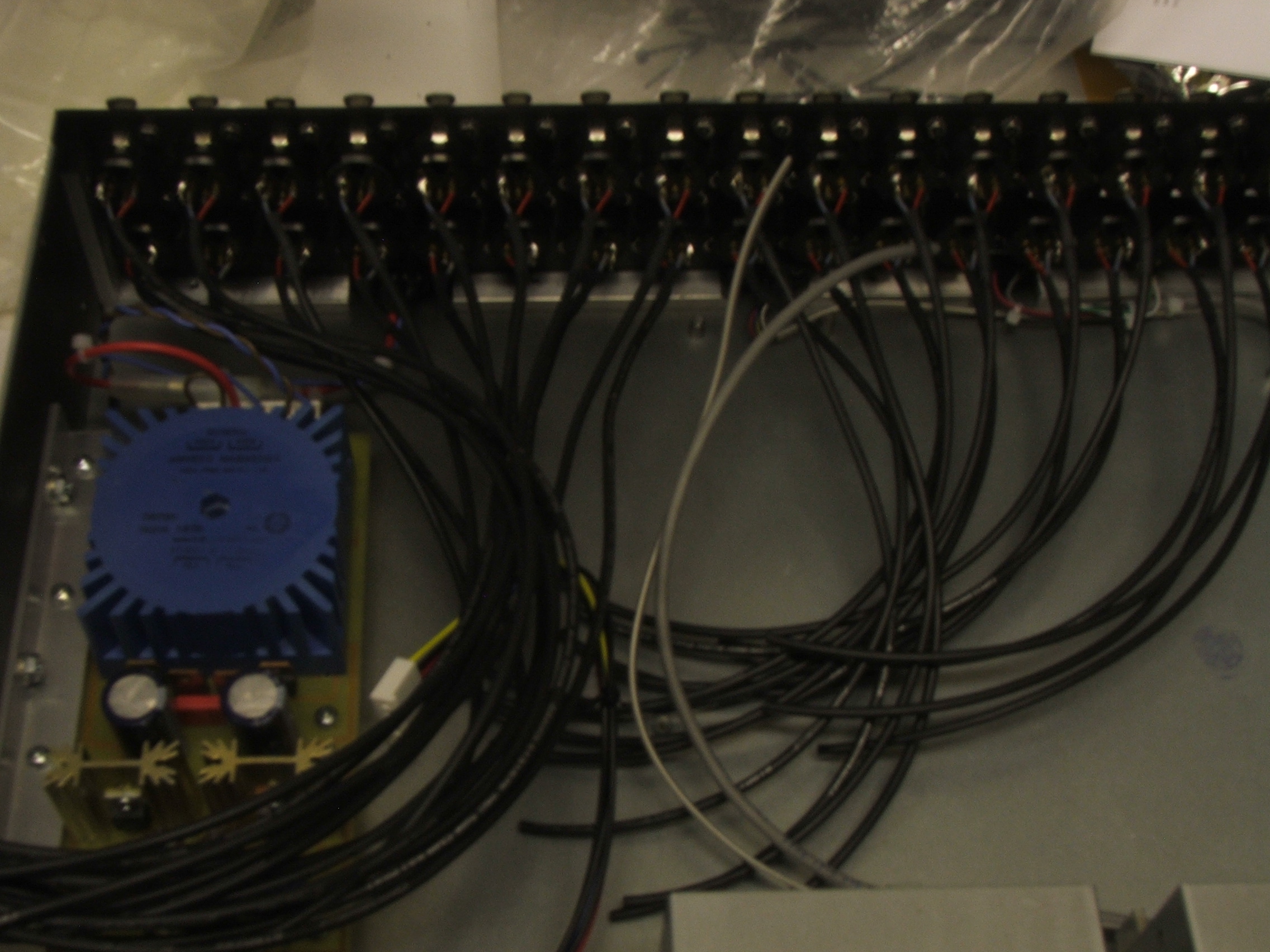

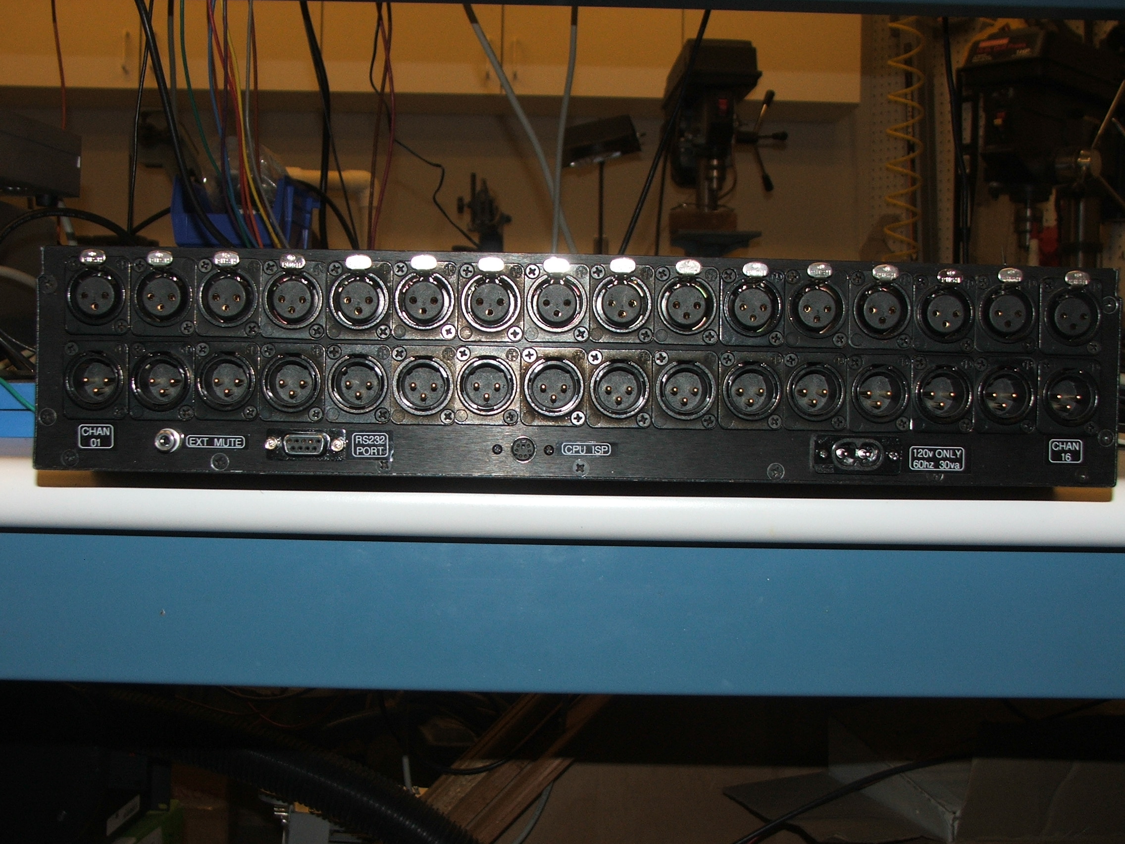

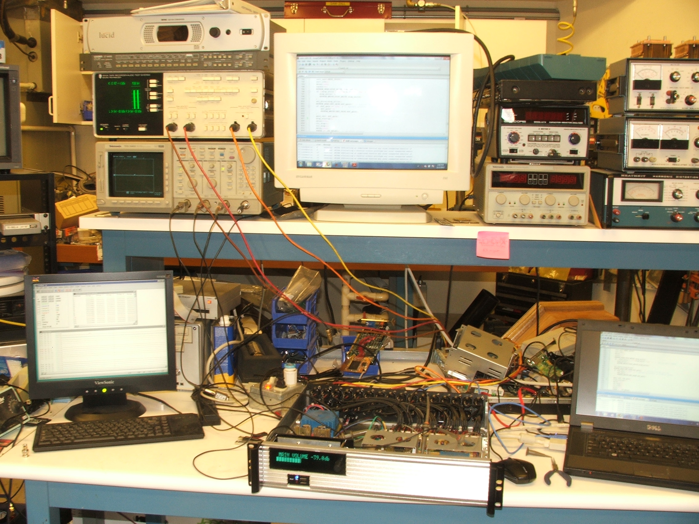

Very neet design, but how did you manage to get 16 channels of balanced signals from just 8 x PGA2310s? I would have expected to see you use 16 PGAs.
Well the PGA2310 is a stereo 2 channel device albeit single ended. The SSM2141 and 2142 chips are balanced to unbalanced, unbalanced to balanced converters. Burr Brown also makes an equivalent part.
They are a tad expensive but as you can see, need no external RC components and are very good performance.
