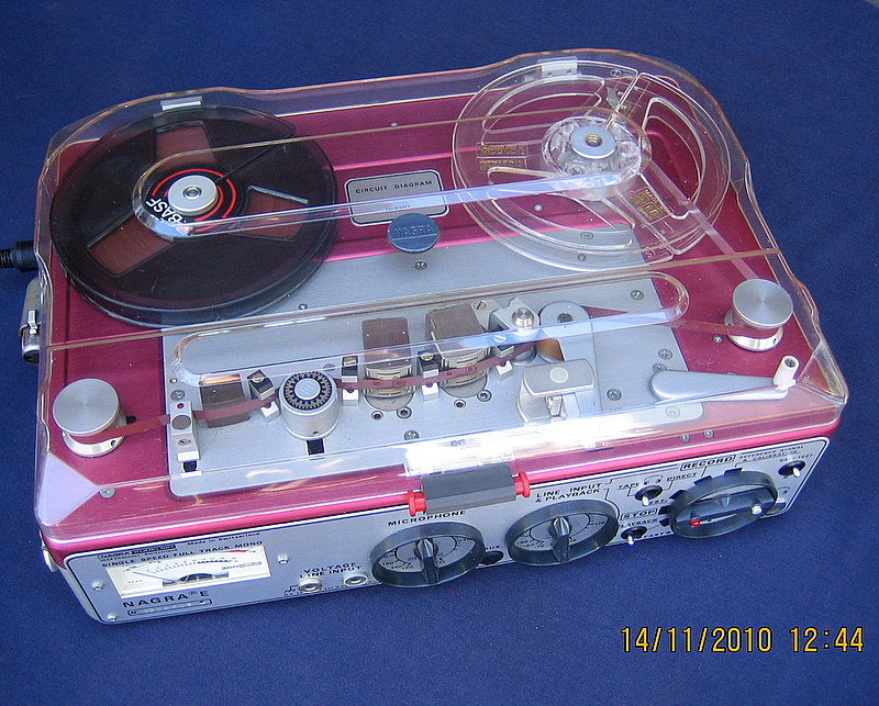

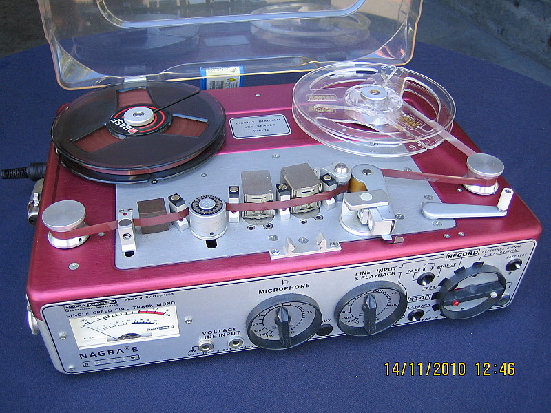

A couple of years ago, I posted something about my Nagra 4.2 recorder. This one was one of 5 Nagra recorders I bought about 12 years ago when the national broadcaster sold off or dumped their analogue equipment.
Shortly after I bought the 5, I sold 3 to a UK collector and kept the 4.2 and this model E. Restoration on the 4.2 is ongoing and it is working now but there's still a few cosmetic things needed to be done.
A few days ago, I again got "the urge" to look at the model E which reposed in its leather bag since I bought it.
One thing led to another and I couldn't resist a bit of tittivatin', lubrication and so on so here's my E (for economy!) mono beauty.
I also needed to make up some leads (one din to rca's and a second with 4mm bananas and rca's to connect to one system needing a tape deck.
It has limitations such as the small reels (33mins) but I'm looking for bigger ones now.

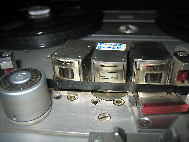

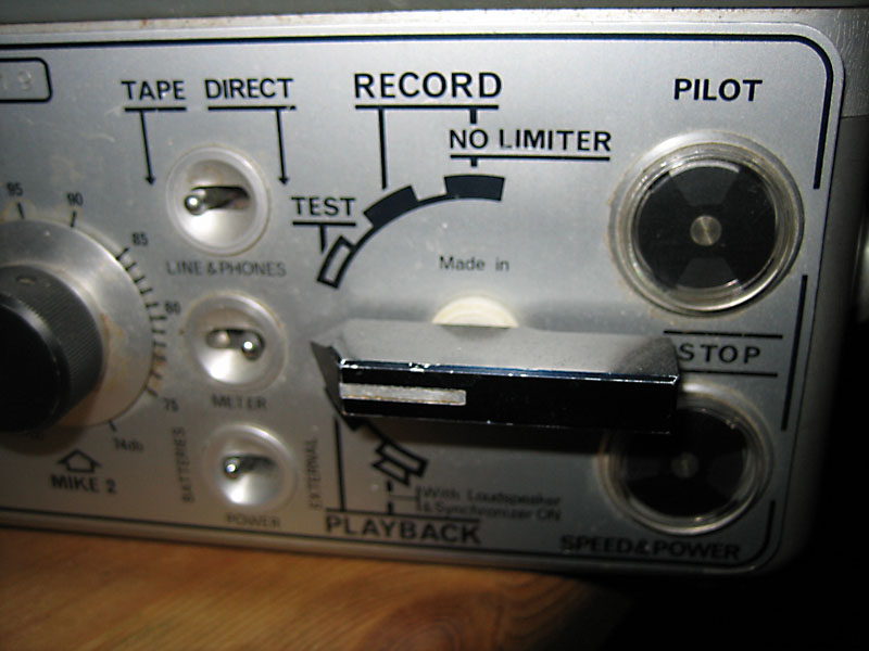

Nice to see that deck of yours come back to life again, bulgin. I guess I'll have to find some space for my 4.2 an connect it to my equipment. My 4.2 differs a bit from your 4.2 in that it has a fourth head between the record an playback head: the pilot head. It records two narrow tracks with a 50Hz pilot tone in opposite phase, so it does not affect the audio track.
The pilot track was a necessity back in the 16mm and 35mm film recording days, to keep sync with the picture.

Yes, the E now at least looks presentable and everything works correctly.

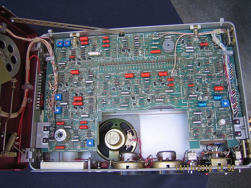

There must be lots of inspiration flying about here and over at err...another forum. The 12-year-old job which never got done as I didn't know how to, is 'mission accomplished'. The modulometer's replacement glass on the 4.2 just got done🙂
No glue was used. It is a kind of interference fit. I scribed a slightly oversize 50mm circle on the lexan and first removed some excess material with an electric file.
Nothing sucks like a dustbug sucker and this is what I used to chuck the disc in my lathe, make it perfectly round and removed small amounts of material until the new glass snapped firmly into the bezel, resting on its original o-ring.
On the negative side, there was rather more D-cell corrosion once I removed some of the boards. Two tracks were almost completely destroyed but I can bridge them. It also took several hours to remove and neutralise places inside the cabinet contaminated with leaking battery chemical.
Once the Nagra is more presentable, I will post a pic or two.

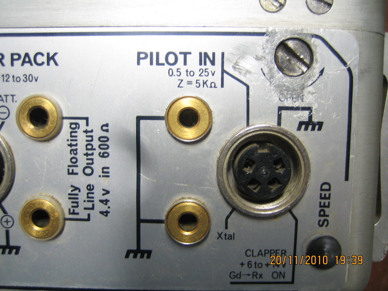

The power I am using is the Nagra ATN2, it gives 21,5V 0,8A , + at pin 2 and - at pin 5. You can use anything between 12 and 30 V.
I am not sure that you can use the same power for Nagra E, but I would not be surprised if you can. My ATN2 is marked "for Nagra IV and 4.2 only NOT NAGRA III", but that was before Nagra E was born.

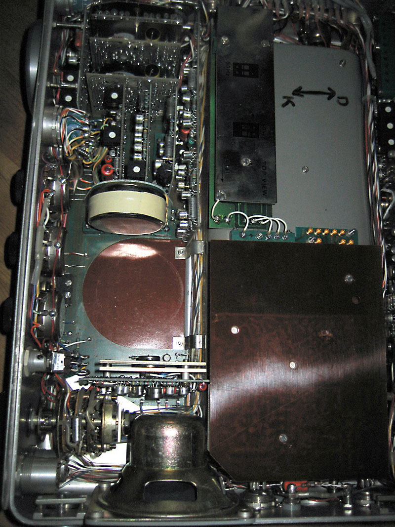

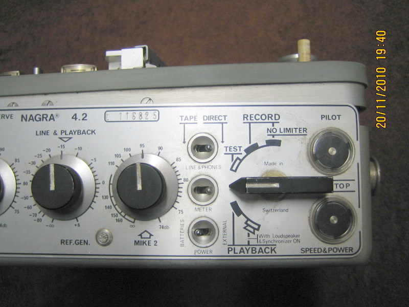

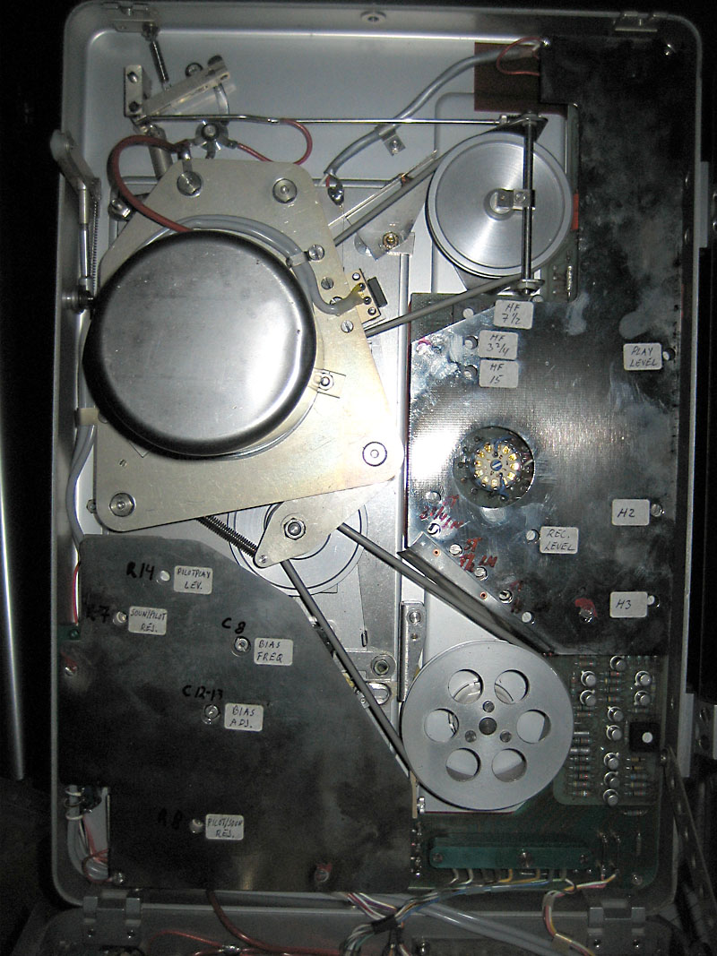

Here a few pictures of my Nagra 4.2:
On the headbridge you see the pilot head with the two narrow tracks. Same signal, opposite phase, nothing out on the audio head.
