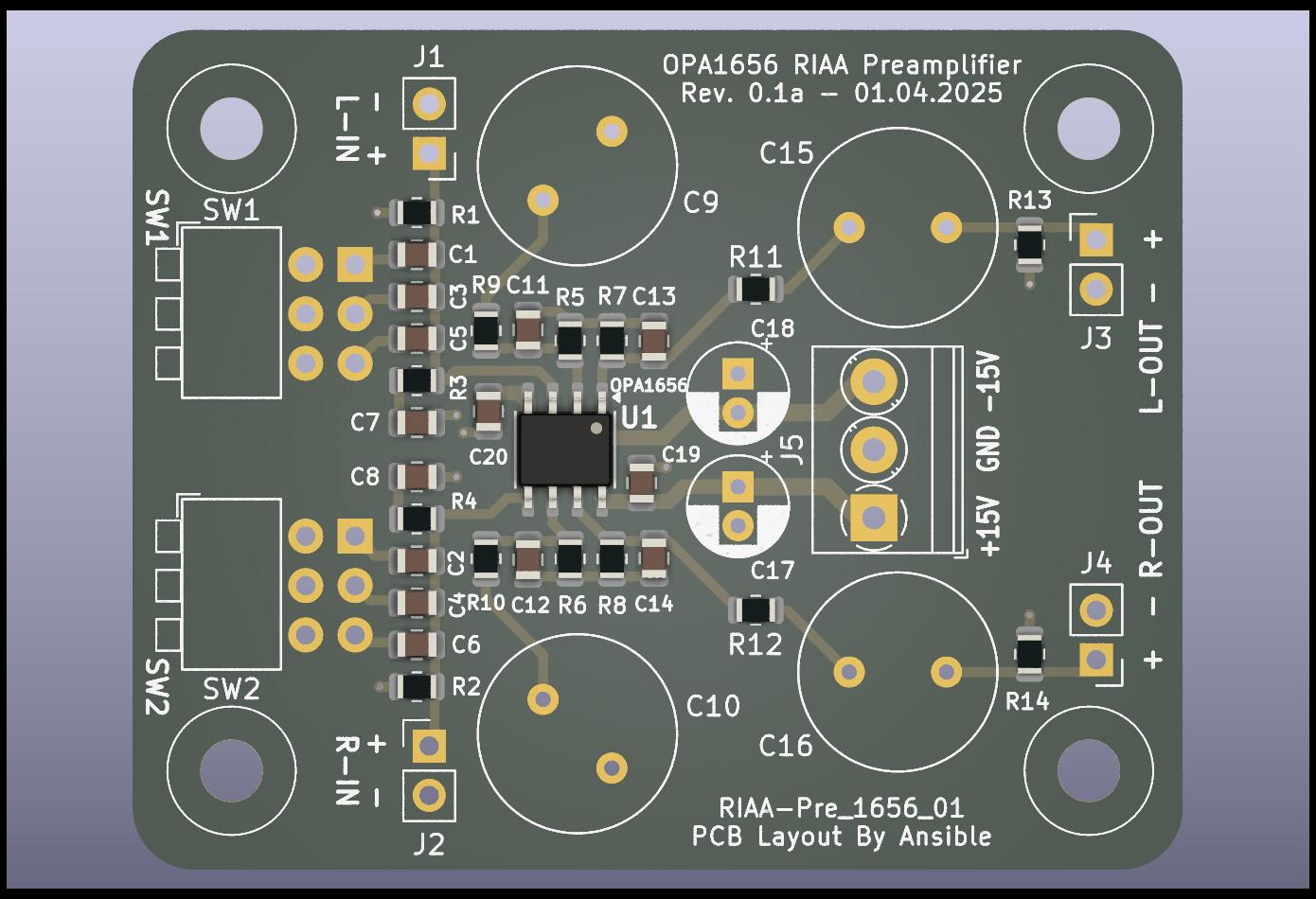

Hello everyone,
I decided to build my first RIAA phono stage, using OPA1656 and the schematic shown in the datasheet.
Where possible, I tried to use 0805 smd components for resistors and capacitors (exclusively Thin Film and C0G/NPO), except for the two 100nF that decouple the power lines. These are X7R. About the four 100uF capacitors, I chose Nichicon UES Bipolar.
The only change to the circuit concerns the removal of the 150 pF capacitor (for the capacitive load), replaced by three capacitors (22pF, 47pF, and 100pF) selectable or not, through a 3x SPST Dip Switch, for 8 possible combinations of capacity (0, 22, 47, 69, 100, 122, 147, 169 pF).
Considering that an average interconnect cable has a capacity of around 100pF, being able to add values between 0 and 169 pF, allows you to optimize the right input capacity in the most critical range of many cartridges (100 - 250 pF), especially those that prefer low input capacities.

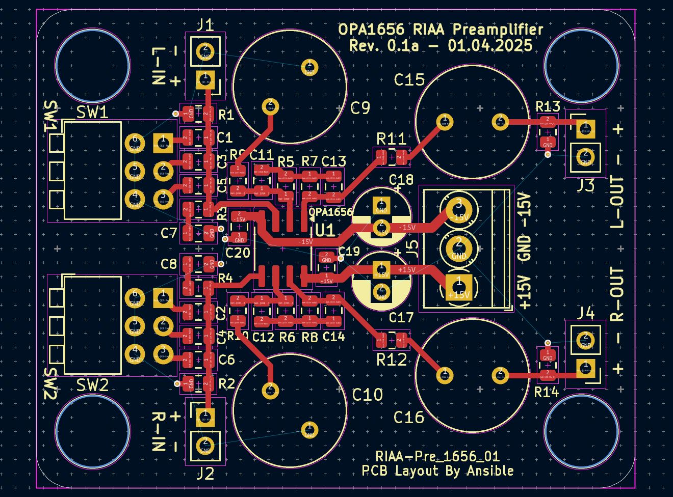

I attach the schematic and some images of the PCB layout, in its current state. I have already made all the connections, but I have not yet added the ground plane on the bottom, so as not to confuse the traced tracks. I used 20 mills traces for all the signal lines, and 30 and 35 mills, only for the power lines.
But before completing the PCB I would like to hear some opinions on the layout and ask some questions:
1 - Is this preliminary rooting good enough, or are there obvious errors? Can it be improved with small changes?
2 - For simplicity I used classic 2.54 mm connectors for inputs and outputs. The input RCA connectors will be the standard through-hole type, fixed to the rear panel.
If placed at a distance of about 35 mm from each other, they will be located almost exactly above the two fixing holes of the PCB, on the input side, with the advantage of being able to use really short input cables (15 - 20 mm or even less). Slightly longer cables for the outputs I think are less of an issue.
From a sonic point of view, would it be better to use different connectors?
3 - About the Output capacitor, the last two lines of page 21 of the datasheet, state:
"... C5 is chosen to be the same value as C4; for simplicity however, the value of C5 must be large enough to avoid attenuating low-frequency information."
In my schematic, C5 corresponds to C13, C14 (100uF).
How do I check or calculate if the value is large enough, to avoid attenuation at low frequencies?
4 - Any other suggestions or criticisms, will be useful. 🙂
Marco
I attach the schematic and images of the pcb in its current state.

Hi!
Regarding capacitor size, the frequency response can be calculated by the following formula (it will be 6dB/Oct, so 1st order):
Fc=1/(6.28*R*C).
You have 2 high-pass points in your circuit: R4/C4 and C5/R5/R6/(impedance of next stage), but in this case, the impedance of the next stage will be much more relevant.
Let's check:
R4=127ohms, C4=100uF ->>> Fc = 1/(6.28*127*0.0001) = 12.5Hz
For C5, if you next stage has 10kohm of impedance, the frequency will super low:
R5=10kohms, C5=100uF ->>> Fc = 1/(6.28*10000*0.0001) = 0.15Hz
I would leave this 100uF since we don't know which is the next stage impedance. and it doesn't matter much if the capacitor is large as 100uF.
It's better to have lower frequency cut to not influence the overall frequency response.

Hi Ron68,
Thank you very much, it is exactly the calculation I wanted to verify. 😎🤚
The 100uF tht capacitors are the only components that will be installed after the pcb printing, therefore the only ones that can be easily changed in value, if necessary.
I wanted to understand their role in the calculation of the cutting slopes.

I updated the circuit to version 0.1a
  • Fixed the schematic with the new RC network
  • Now all the resistors are in 0805 pack.
  • Shortened the paths and optimized the distances between the components.
Now the PCB measures 43 x 54 mm.

The layout looks nice and compact to me. When you put it in an enclosure, you have to keep hum fields away and keep the loop area from the input connector to the amplifier input and back small, as is always the case with phono preamplifiers. (The alternative circuit Chris referred to is my design. I think it's the simplest way to add a fixed subsonic filter, if you should want one.)
Hi MarcelvdG,
Thank you.
And to answer your question, I had already considered building Rod Elliott's subsonic filter, once the Phono pre was completed, but the possibility of incorporating this functionality into the pre phono circuit is a special added value.
And also the modification suggested by Nick (Hi Nick...!🙂) is definitely intriguing, despite the higher cost and the less easy availability of the OPA2192 (which on JLCPCB, always translates into a higher cost).
But I'm very curious about the possibility of comparing two very similar circuits, with and without a 100uF Bipolar electrolytic capacitor on the signal path.
They are three nice versions, each with interesting strengths.
What can I say, I would like to have all three available, to be able to compare them , more with my ears, than with the oscilloscope, at least until I buy it. 😎
.So MarcelvdG, if you don't mind and you agree... 🙄
... I could also prepare the PCB for your circuit that incorporates the subsonic filter.
Then we decide which ones to print, also depending on the availability of the parts.
The most boring and delicate phase is the selection of components, to balance costs, availability and specifications.
Basically, apart from particular needs, I would only use thin film resistors, 0805, 0.1% tolerance and no more than 25ppm.
Ceramic capacitors only C0G/NP0, always 0805, possibly at 2% or better.
