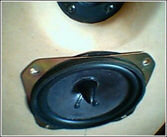

Coating the speaker cone with something. I used a light coat of modge podge glue (puzzlecoat, etc., seems to all be the same thing).
Im experimenting with removing the dust cap as well. Just taking the cap off doesnt seem to help. A phase plug would be good, but I need to make one first 🙂
Make a phase plug from a wine bottle cork. Like this.
