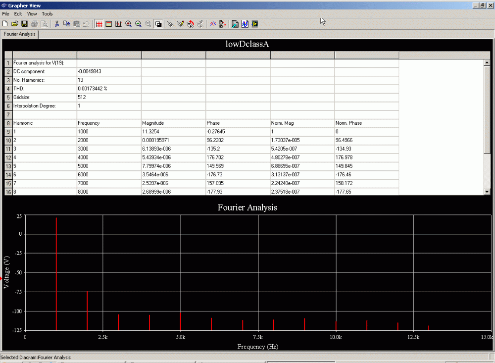

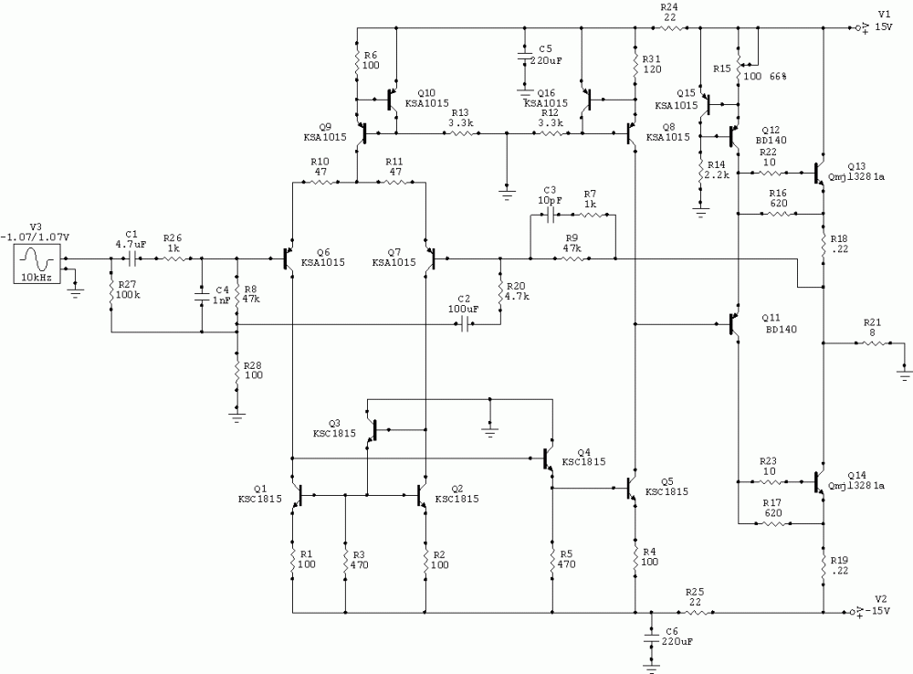

Just wanted to share the plans for my next little amp project. It's a small 8 watt class A amp. Waiting for the parts from mouser to get started. The sims for this circuit are excellent. It should turn out to be a very nice sounding little amp.
good amplifier, jerluwoo
the 2SC1815 and 2SA1015 small signal transistors are very good ones
they are still possible to find and buy
the supply of this verision is low (+-15VDC), so I imagine a Class A output?
input has got ~3mA in each
and a good current mirror (Geln Kleinschmidt will be happy 😉 )
second stage works ~5 mA
the output arrangement is a typical Jerluwoo design
Quasi complementary N-Channel
simple but working!
the input rolloff freq is <= 150.000 Hertz
R28, 100ohm, connects the input to 0V
Thanks Lineup. I thought you might reconize this output stage. Of course it runs class A at 1.25 amps idle current, a little extra than needed to keep the output transistors in their linear hfe curves. I've yet to find another that is as simple and stable that sounds better. The current mirror of course was modeled after the discussion between Glen and others about the the same subject. With simulated distortion of .001% , I would expect somewhere around .05% or better real world with good beta matching of the input stage.
