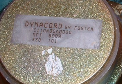

Well, I managed to blag these drivers for free today, they are out of an old PA system. I got 8, but only 4 are working, so I am thinking of knocking up a 1.5 way system for my computer, depending on their specs.
Obviously I need to measure them first, but I was just wondering if anyone had seen similar drivers before. They are 4" jobs, with a 1" voice coil and a hefty magnet, and came out of a box built in the mid nineties. The only other identification I have is that they have a code 804x on the magnet. Anyone seen anything like them before?

what does it say on the back... the small print?

planet10 said:what does it say on the back... the small print?
Not Suitable For Use As A Bipole 🙂

Easier to post a blow up rather than type it all in!

I was going to say that the basket looked Japanese, and if Japanese, the 6-legged basket screams Foster... and there it is written on the back :^)
This is likely a pro varient of the FE103. Bigger magnet & surround goes the wrong way. Should make a good little FR... might need a little help above 10k.

pinkmouse said:Easier to post a blow up rather than type it all in!

Well, I ran them all up with my trust test GC today, and one of them has a little bit of a voice coil rub at high volumes, hmmm.
I think I will do a dustcapectomy on it tomorrow and see if there's any rubbish in the gap that I can clean up or hoover out. If that doesn't work, I may have to give up on the push-push idea🙁
Unfortunately it's been raining all day, so I haven't had chance to take them outside and do some proper measurements, however just sticking a mic on them while they were sitting on the bench seems to give a roll off at about 14k at the top, and 100Hz at the bottom. These could be quite fun🙂

Main thing is they seem well made and Fostex aren't the kind of speakers I'd spit at.😉

Well, I finally got round to testing these drivers, and I'm a little put back. The computer monitor speakers idea will be delayed, as these are very definately mid range drivers...
Fs 167Hz
Qms 7.16
Qes 0.83
Qts 0.75
Vas 4.96L
Oh well, I'll stick them in the cupboard till I have time for another 3 way😉
