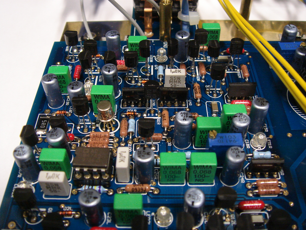

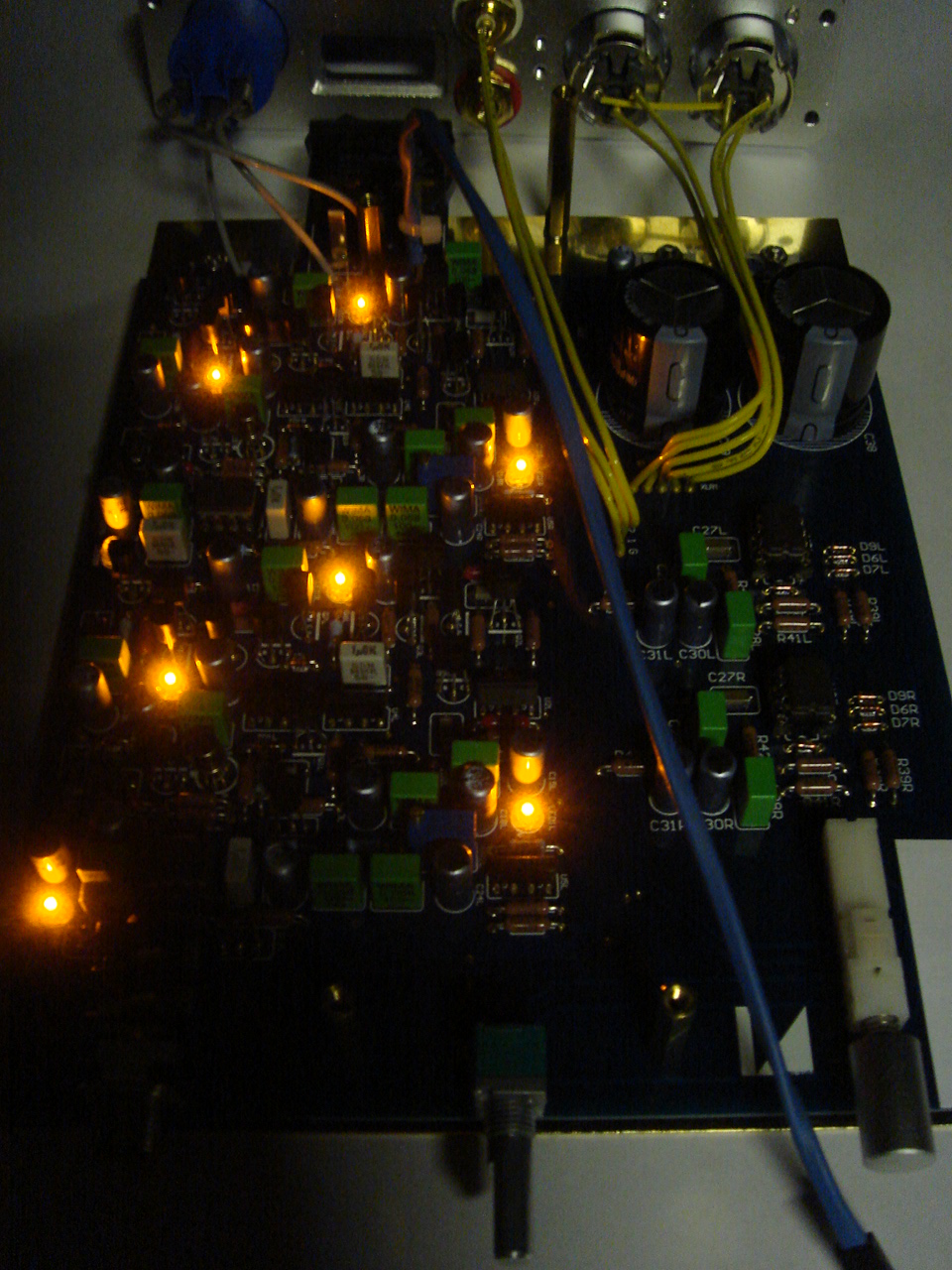

HPA-1 uses Dual FET input, Dual transistor and Class A transistor. It has one balance and one unbalance input. The 4 layers circuit board is sandwiched between two copper templates. External power supply is convenient to choose any kinds of power supply.

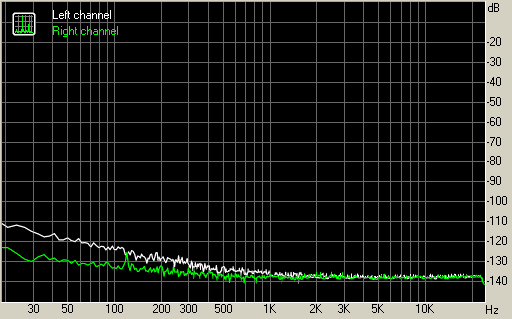

Noise
10Hz -110dbm 1K -130dbm 10K -135dbm
(Neutrik A2D-Audio Measurement System)

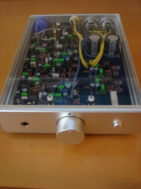

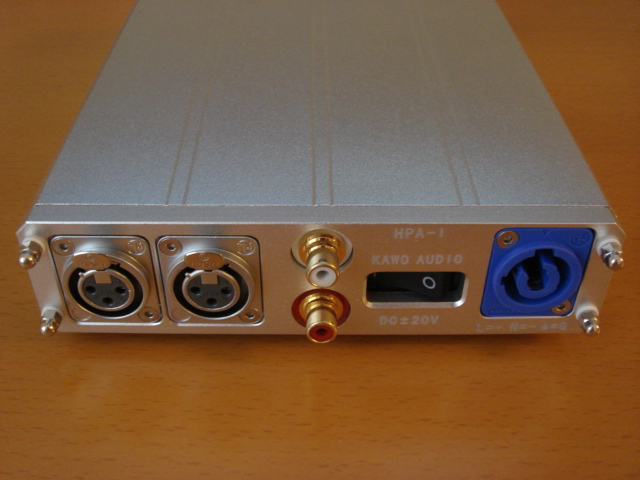

Hi kawo,
Nice realization. I don't see any output on the picture except headphone on front panel! Is it only a headphone amplifier.My new Preamplifier
...It has one balance and one unbalance input...
HPA-1
... means usually Head Phone Amplifier, HPA
A good headphone amp can of course be used as a preamplifier, too.
Can it drive headphone, it can drive most other low level loads.
Hi: Eric
Yes,both headphone amplifier,Preamplifier.
replacement the RCA to Fischer connector S103 -3way,than have one output and two intput.
