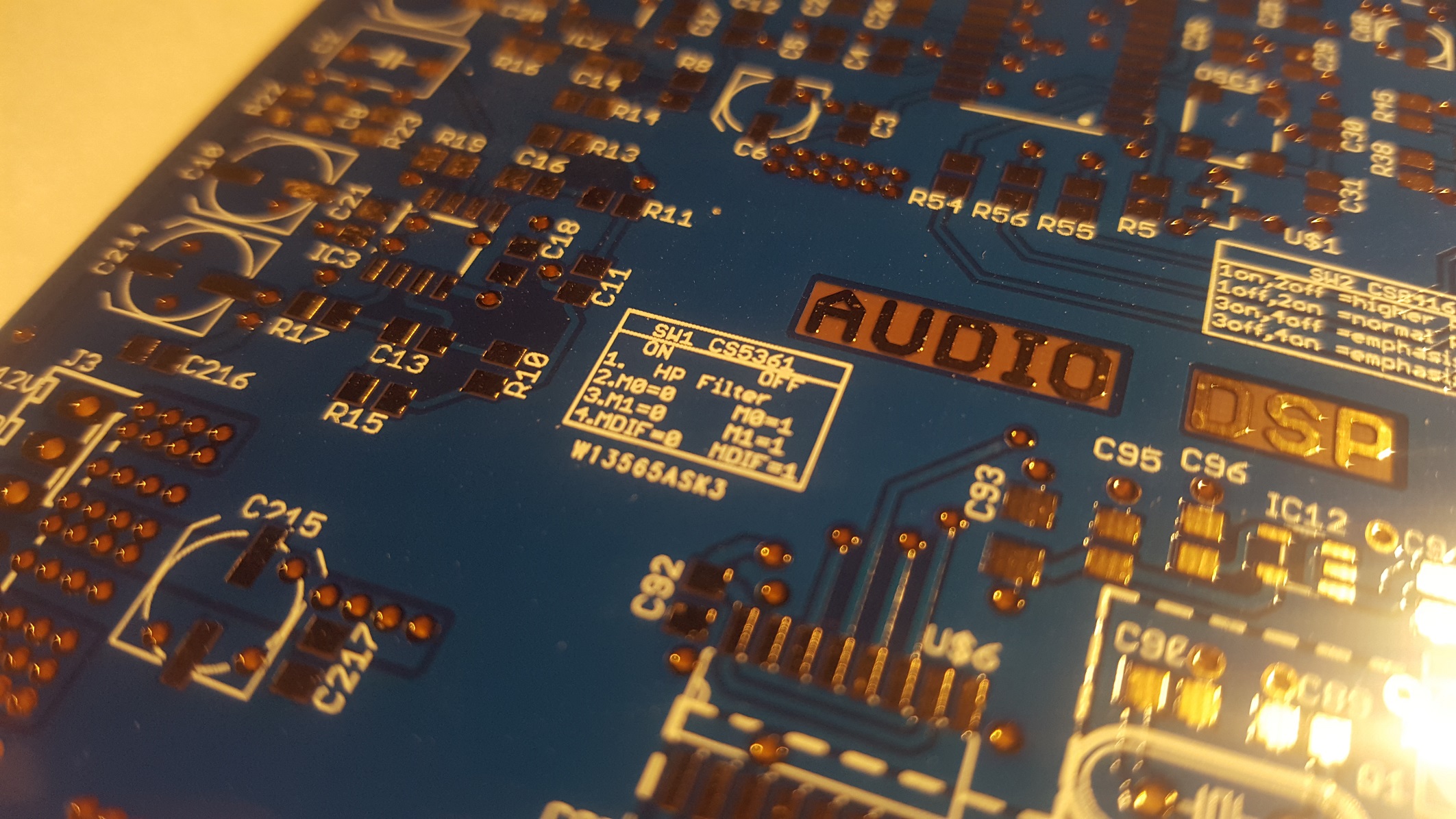

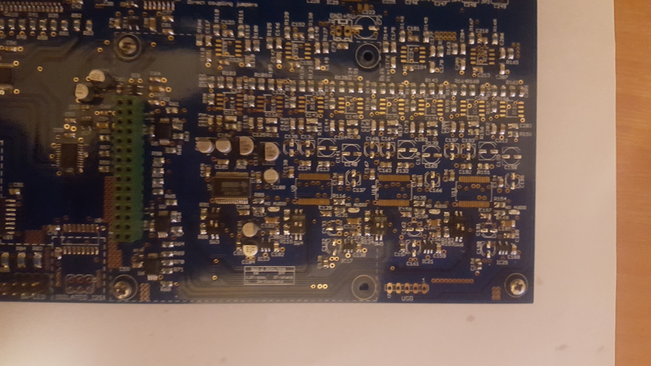

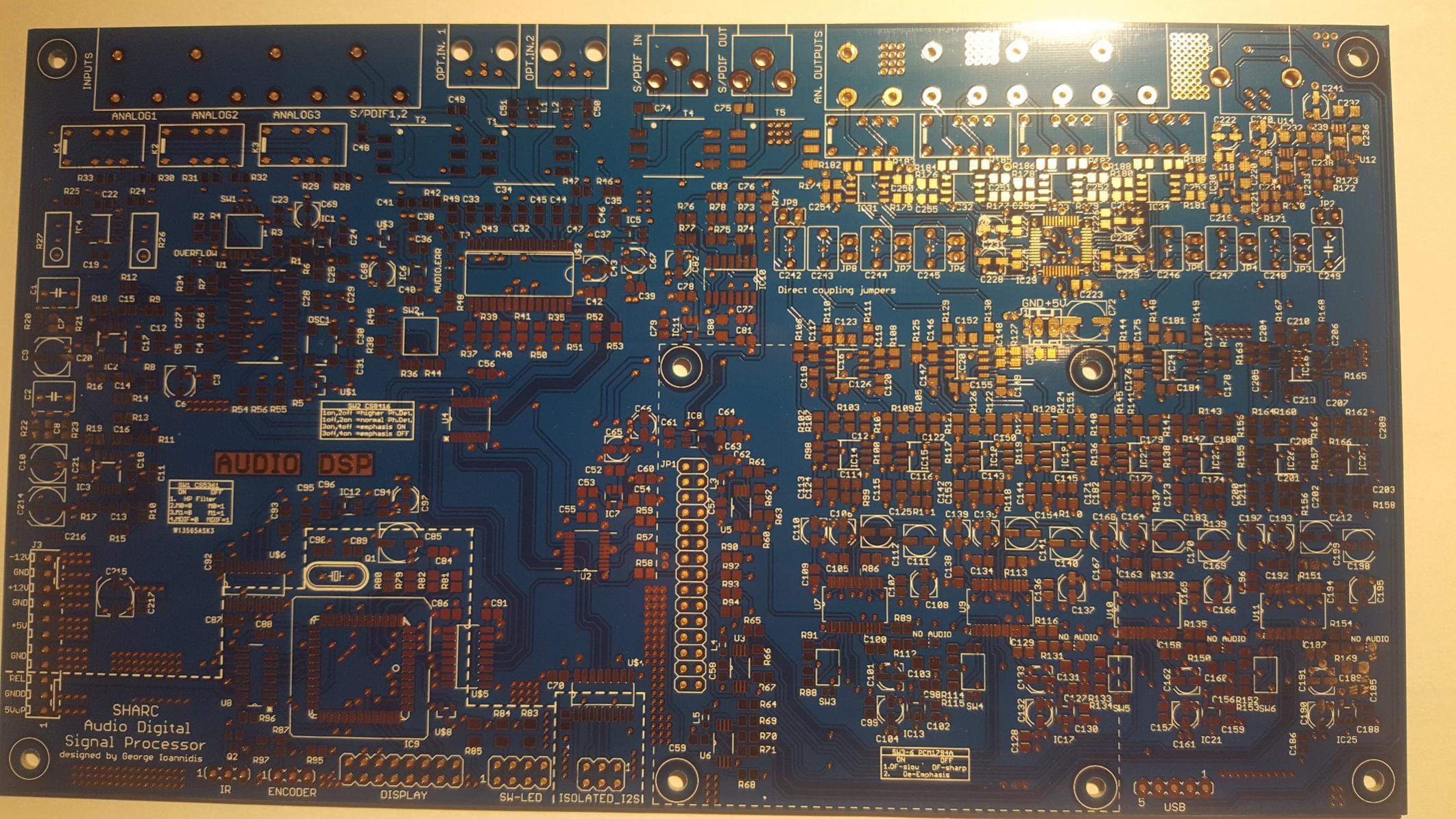

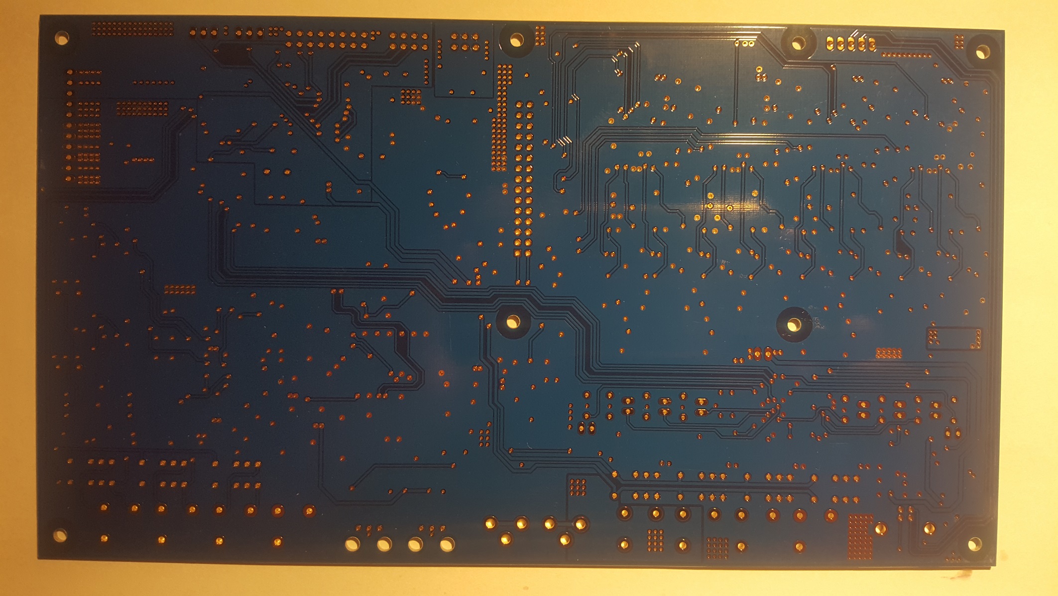

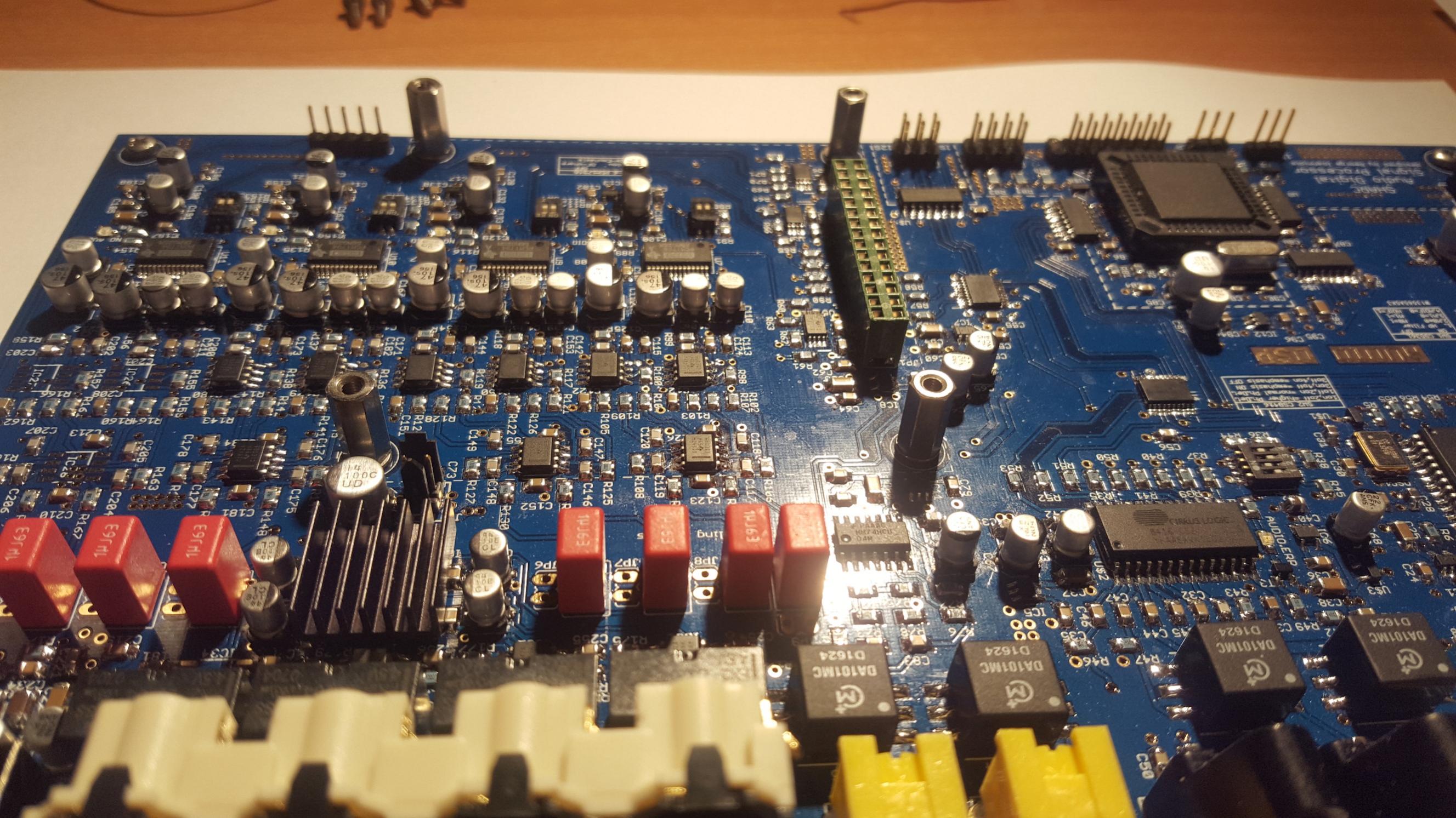

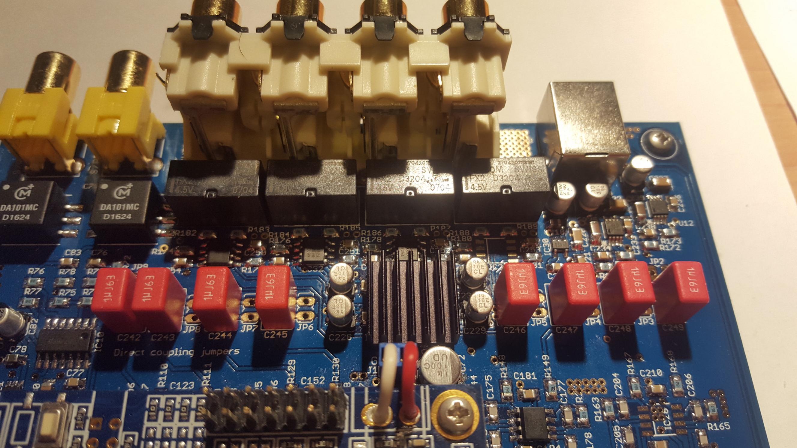

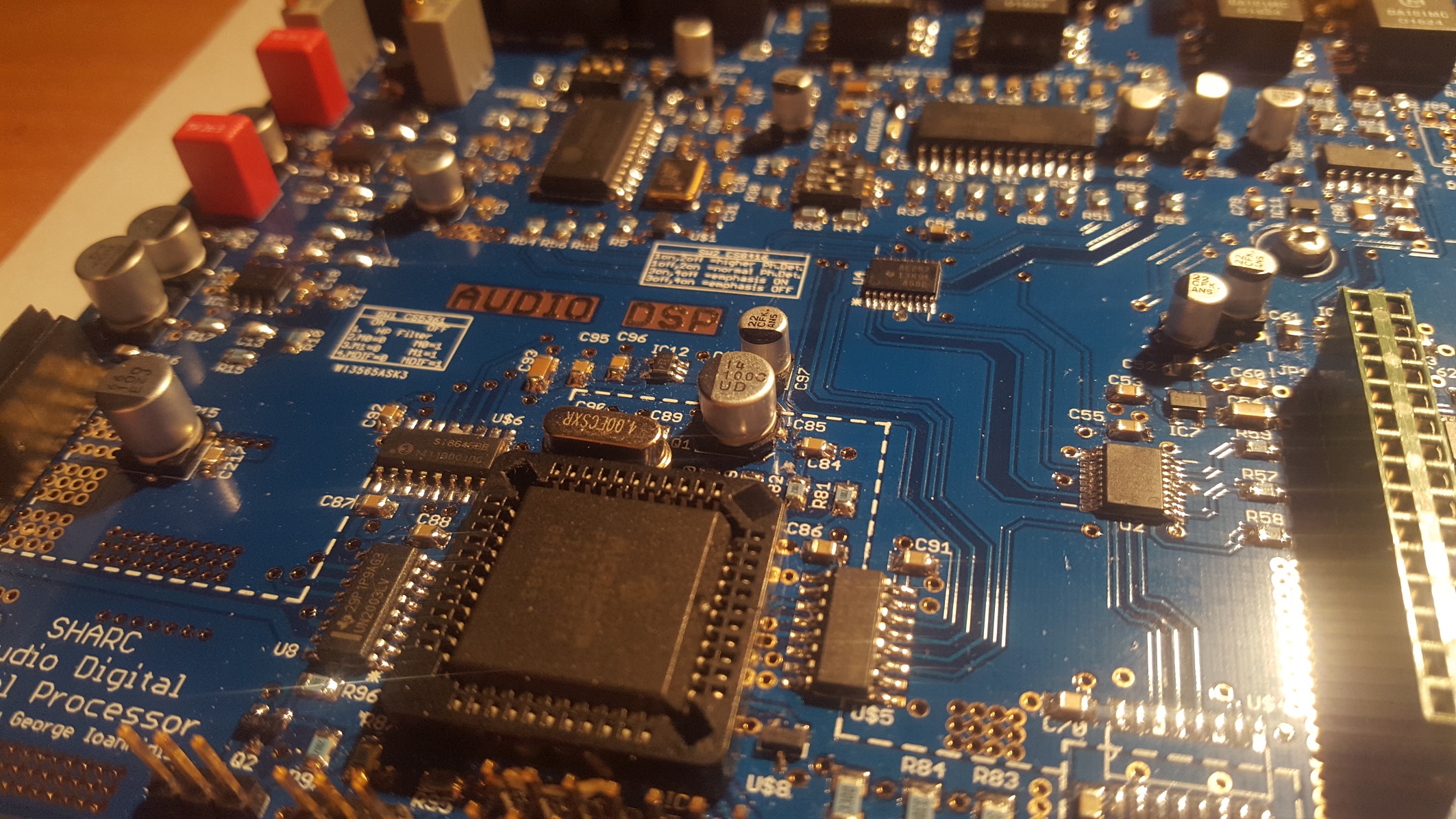

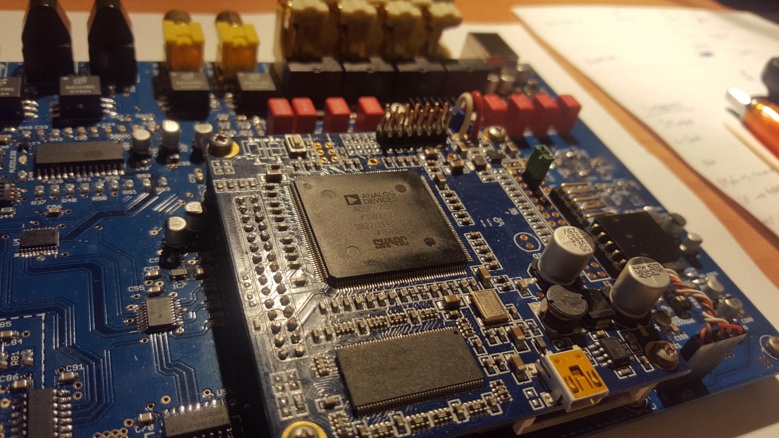

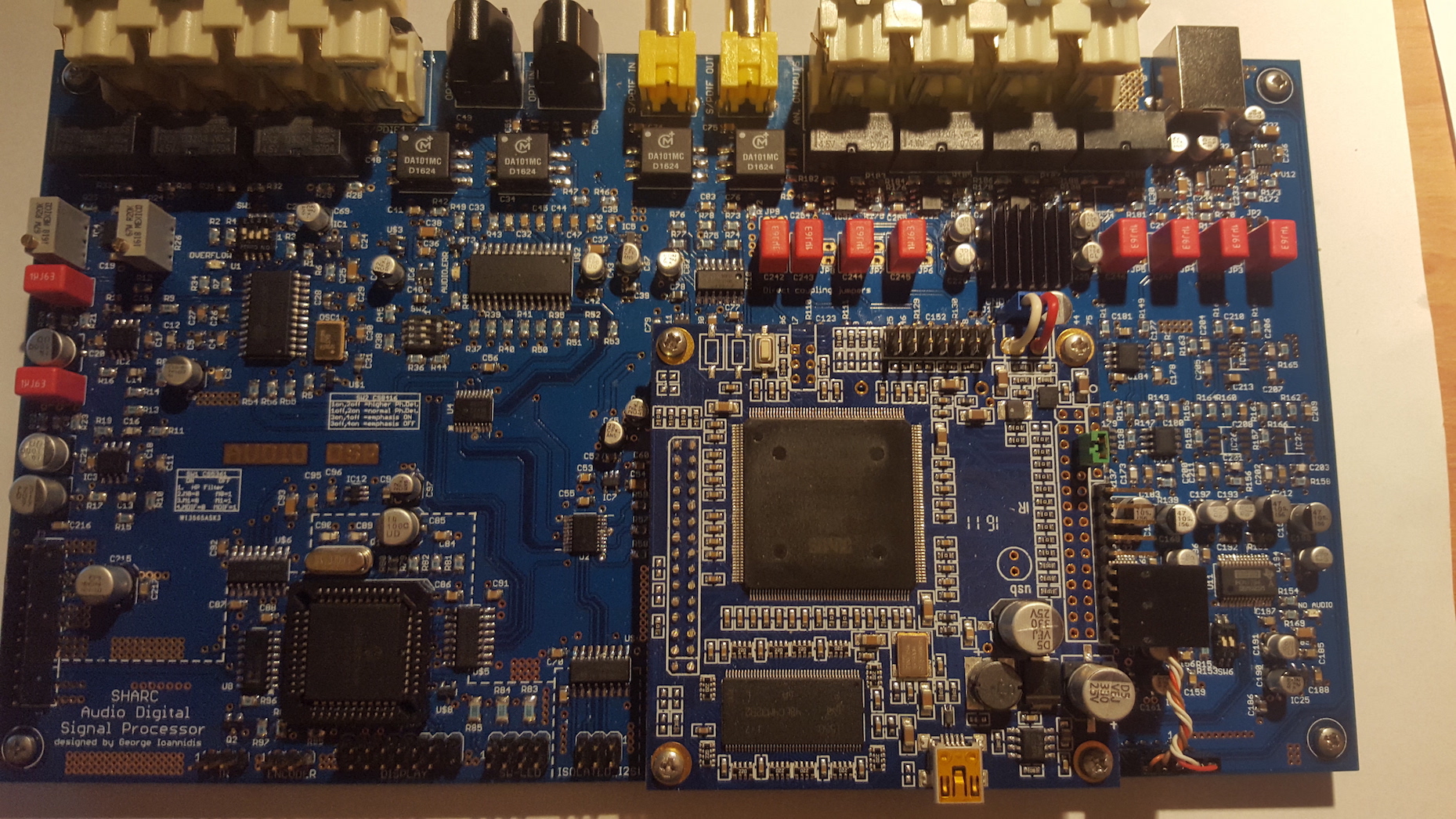

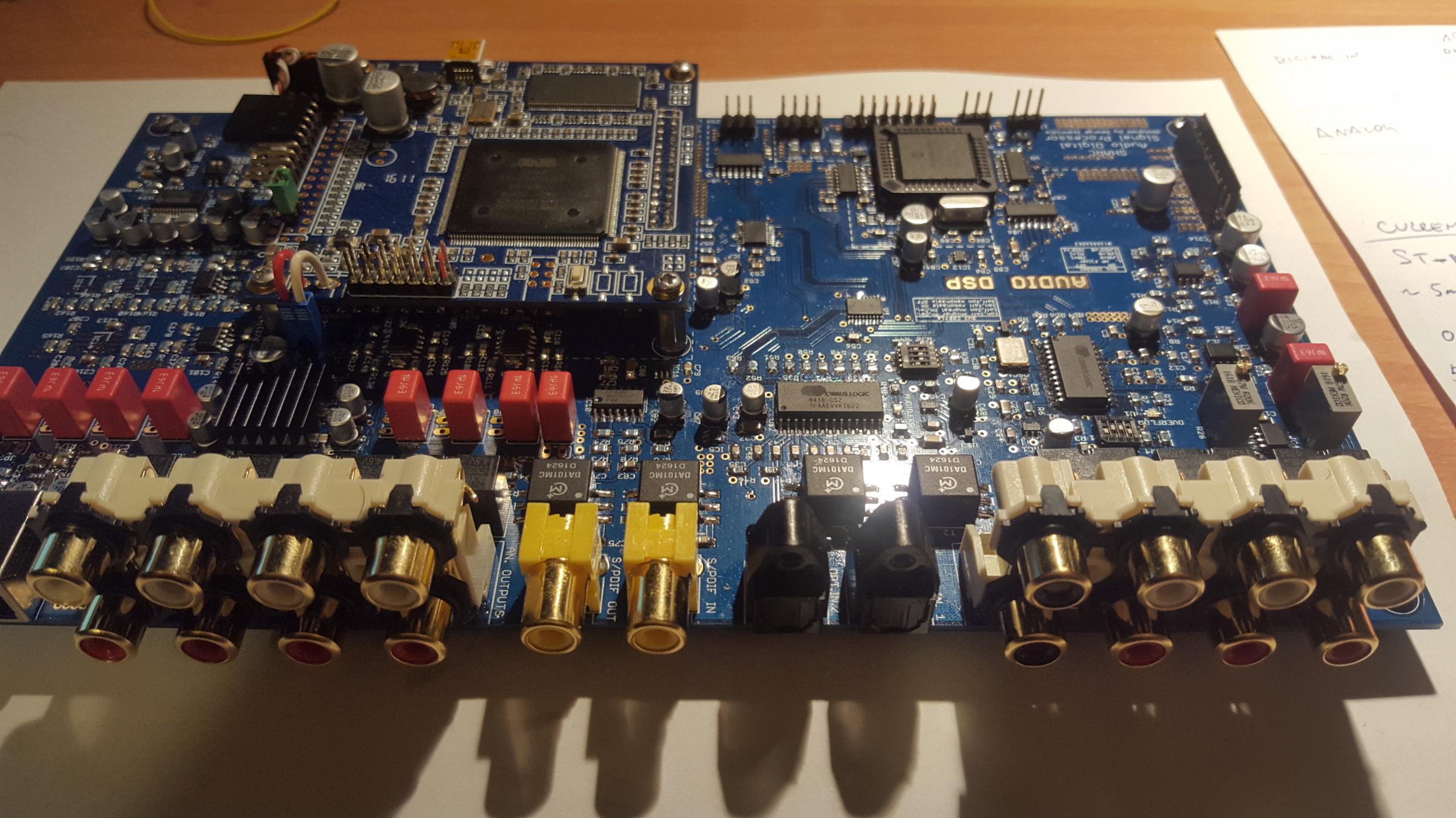

hi again,
finally i found time to design the pcb. I send the pcb files to pcbway.com as always for the pcb manafacturing. The cost for 5 pcb's was about 150$ (4layers gold plated) On the photos you can see the pcb quality. The soldermask and holes are very well centered and the silkscreen is fine. The size is 130x230mm. I have already soldered a few components on the board. Soldering 805 size and tsop ic's is little difficult and time consuming. So far i have completed the input part of the board. I have working adc (cs5361) and digital receiver (cs8416) and spdif in-out level converters. (the minisharc need level 3,3v so level converters are needed). Also the pic microcontroller is working fine (lcd, infrared control, encoder and communication with the other ic are ok). So far i have only checked the waveforms using oscilloscope - i dont have the minisharc yet. the next week i will have the minidsp unit so i will be able to test the input signals with it. Now i have to solder the output components (DAC's with pcm1794a, opamps and the CS8316 for volume control).
For opamp i finally choose the opa1642 and everywhere on this board i am using this type (total 19 opamps). I hope that when i receive the minisharc everything will be fine because i have invested a lot of time and money in this unit. The purpose of doing it is because i want to make my speakers, (active with analog crossover) time coherent and see the difference. Later i will add a usb to i2s pcb so i can stream audio from my pc. For that purpose i have a i2s isolated input already on this pcb. So, what are yours thoughts about this design? it is waste of time-money or it is worth it? My speakers are 3way Seas excel units whitch needs some equalizations. My purpose , as i already mensined before, is to use this board as FIR filter. Do you thing that if i will use the 96khz plugin for the minidsp it will have a sound difference vs the 48khz plugin? Using the 48k i will have more taps available so which will be more suitable for me?

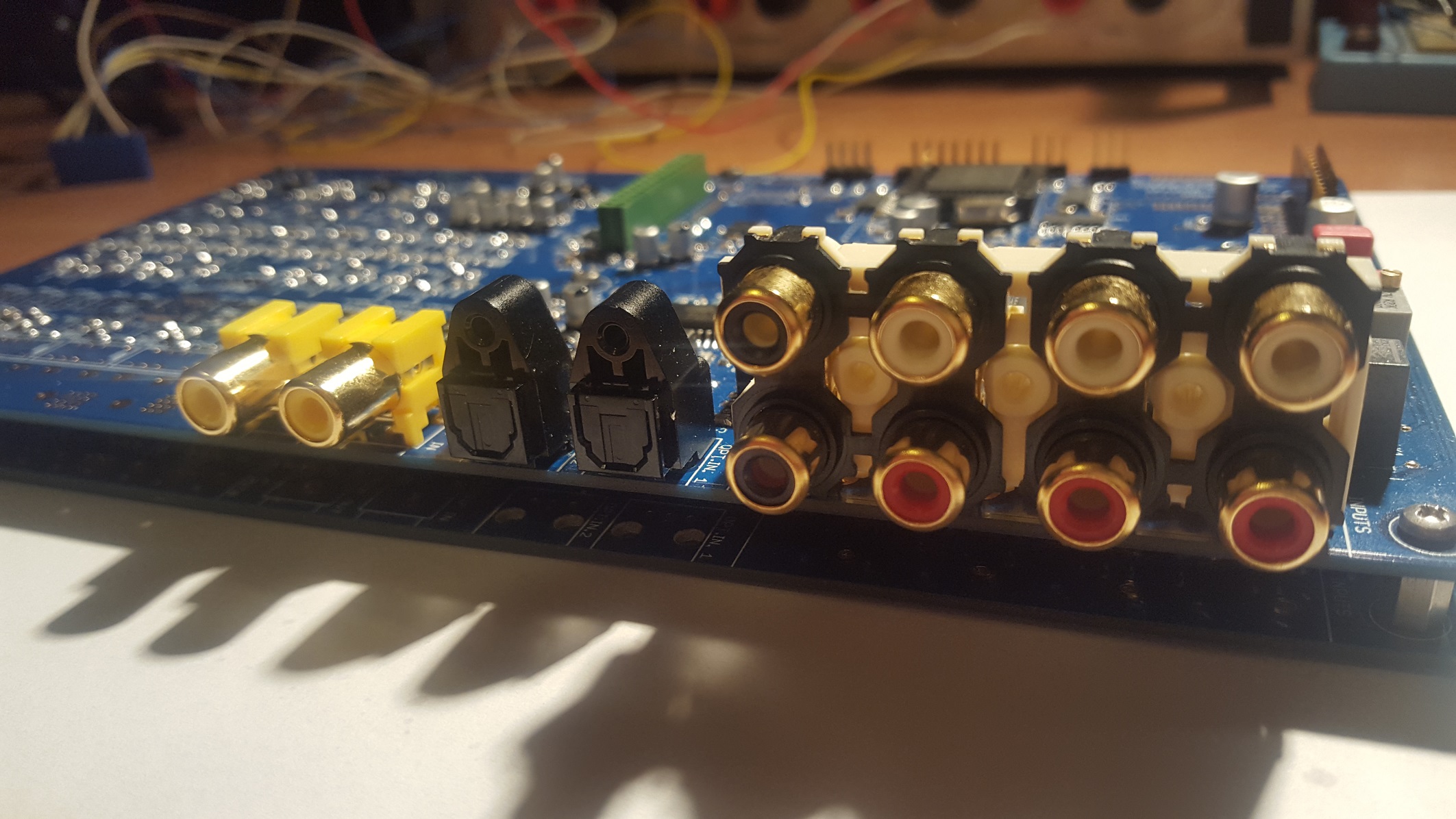

On the photos you can see the input connectors, 3 analog stereo inputs, 2 coax inputs, 2 optical inputs, second independent direct to minisharc coax input (yellow) and one coax output (yellow). I have already designed the power supply board (which i will build after the completion of this pcb and only if everything will be ok). The power supply will have three outputs. The first +5v for the microcontroller section which i isolated from the rest circuits, second +5v rail for all the ic's which needs +5v (from this +5v almost every ic's have a dedicated 3,3v low noise voltage regulators-total if i remember 13pcs on this board) and of course third output +12V and -12V for the opamps and the cs3318 volume control chip which again have its own ultra low noise regulators to +9V and -9V.
That is a very impressive I/O board!
You ask if it is "worth it" and that's a question that is so utterly subjective that only you can answer it.
The cheap and easily available analog I/O add-on boards from MiniDSP are really not bad to start with, so you could have saved a lot of time and money potentially, but that's not really what this is about, right? Doing it yourself, your way is half the point.
So in that sense, once you have that beautiful PCB fully populated and tested, the DSP board connected and programmed, and you fire up the music for the first time...only then can you decide for yourself whether or not it was worth the time and money.
I'm betting that you're going to decide that it was. ;-)

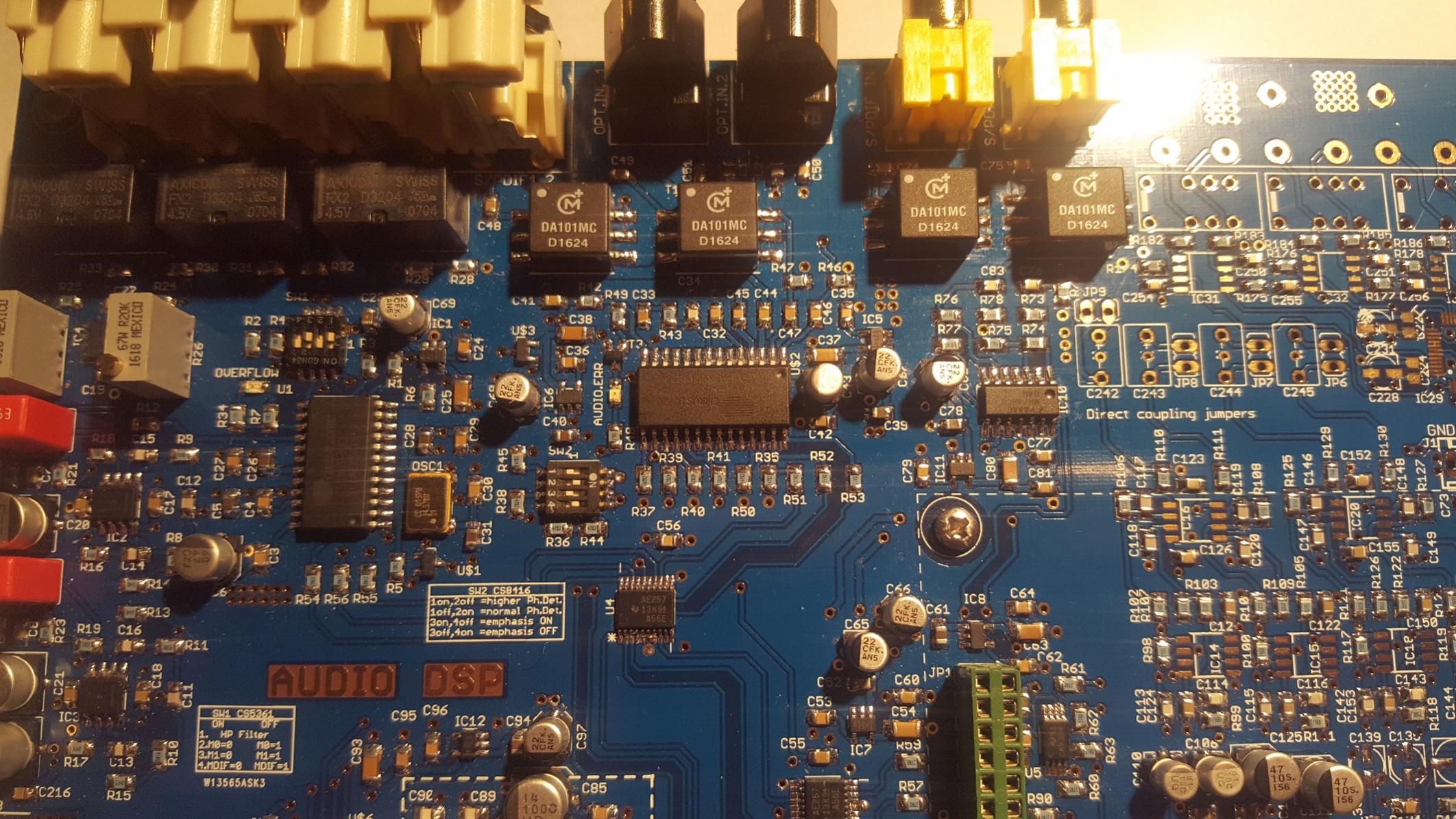

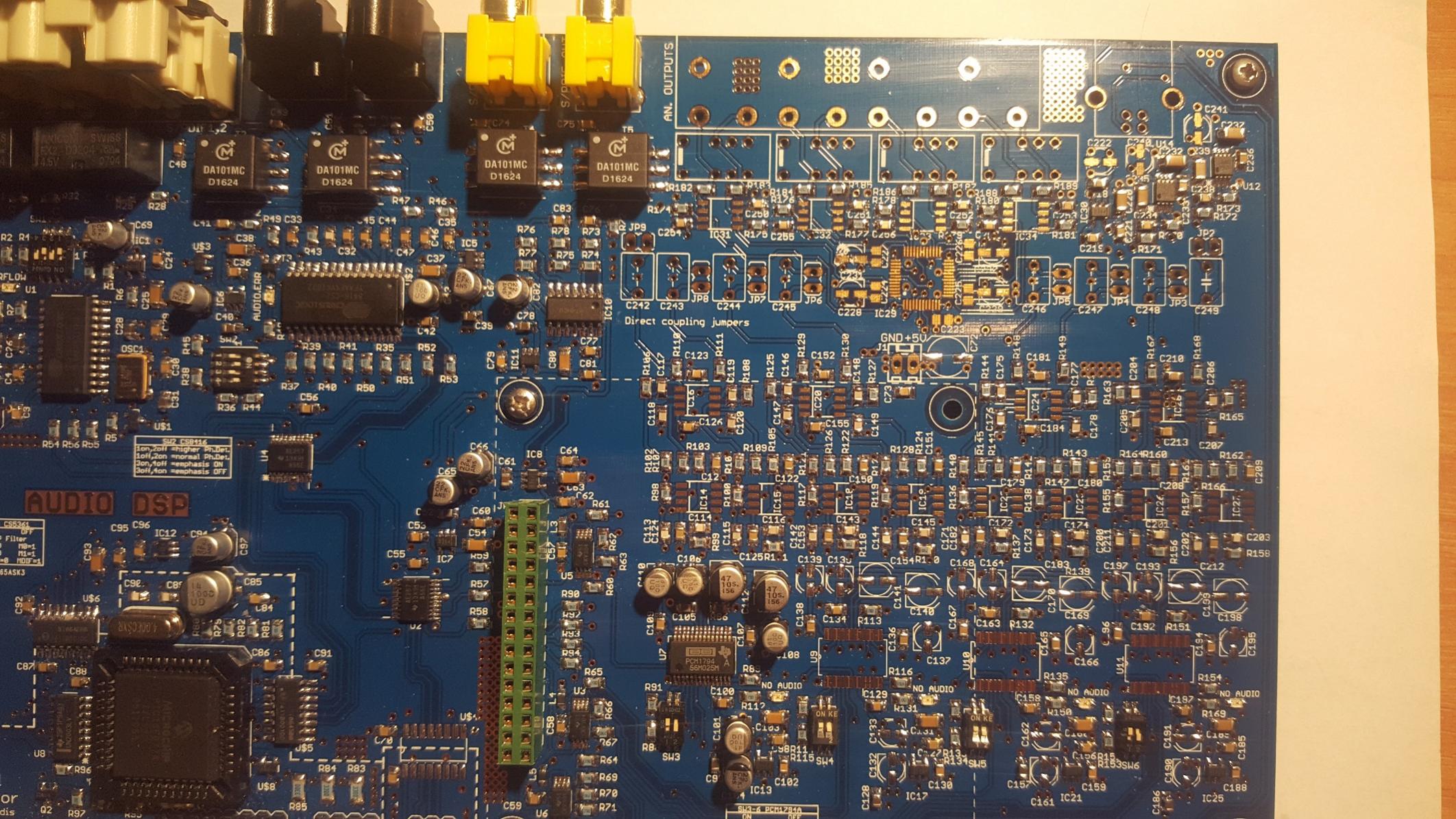

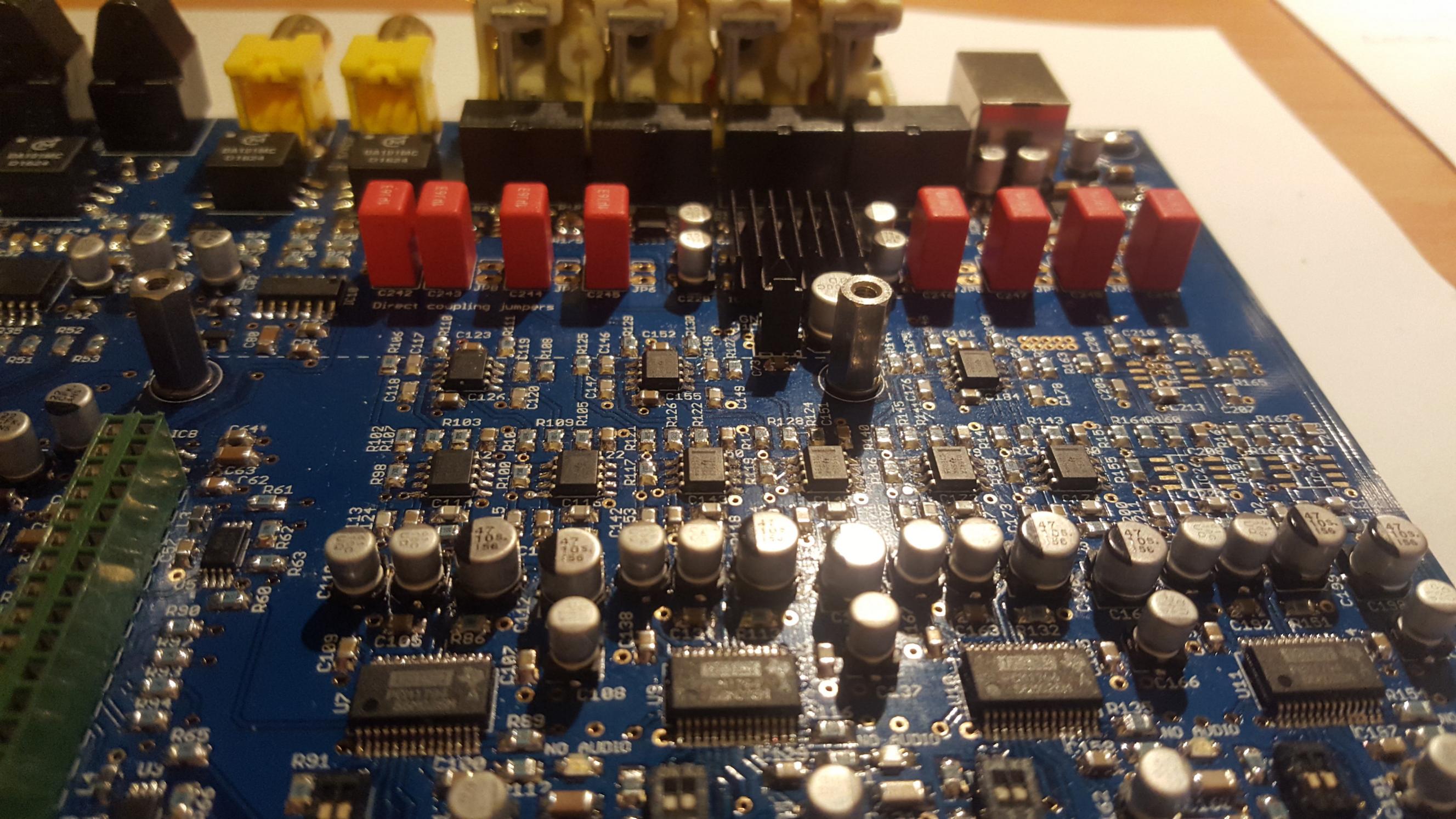

today i soldered almost all remaining parts except 4 pampas which i don't have yet. So, after i put all the parts i had , including the minisharc i fired it up and start checking if and how it works.
The mini shark is working at 48k sample rate, the analog to digital converter also (but it can be changed to 96 or 192 via on board dip switch). The shark recognise the i2s input and shows input level. The cs8416 is working fine also. All the inputs can be switched via remote or rotary encoder and be displayed on the led display. The communication to the cs3318 digitally controlled volume control ic is working fine. With the oscilloscope i can measure about 1mVpp noise at the analog outputs when there is no signal at the input and with the volume at max level (+22db) Of course i will never use that level with my power amplifiers. When the level is lower (for example -20db) then the noise is about 5 times lower but again that volume level is high. The sine waves i tried from 20 to 20khz have no visible distortion at all (always using only oscilloscope).
I noticed that the opamps in the dac I/V stage get quite hot. (of course you can keep your finger on it). I measured the opamp current drawn and on the negative rail the current is higher.
Also the cs3318 is hot too so i put on it a small heatsink (but it is really not needed) which i already had from other circuit.
Now i am designing the power supply for this unit. It will use low noise low drop linear regulators. The power supply board must give the following outputs: +5v for the microprocessor circuit that will be always on (stand-by), one 5v output (from this output are powered all the ic's and almost each of them has it own 3,3 low noise regulator on the dsp board) and the +-12V for the opamps. The cs3318 is powered from the +-12v rails and via ultra low noise LDO regulators (tps7a4901 and tps7a3001) to +-9V and 3,3V from separate regulator for it's digital power needs.
I am designing now the power supply unit because i was not sure if the dsp will work but now i know that it is working fine the supply board can be build.

hello,
i believe that it is better for the following reasons:
1. one board without wires and cables means shortest connections and better noise performance
2.ability to choose the components you want - better quality components (dac,adc) better design (for example separate ultra low noise linear regulators everywhere etc.) - without the cost limit factor
3. using the minidsp components i could not have this combinations of in-outs
4. multichannel analog volume control - the benefits are well known
5. using muting relays on outputs to eliminate any power on-off noises - very important
that way i design it i will have only 2 pcb's one the mainboard and the other one the power supply which i have already designed. 🙂
using the minidsp boards i would need many separate pcb's plus power supply pcb (minisharc, input boards, dac's, clock buffer/driver for dac's, output relay and many more.)
i believe that is much better to have it all on one well designed pcb using very good quality component where needed.
Sh0velman than you for asking i am always happy to hear others member opinion. 🙂
Did you check out the new nanosharc board on miniDSP site?
It uses a newer generation SHARC processors clocked at 400MHz.
also noticed that this has 6 analog outputs. 8 Ch for 4-way loudspeakers would have been great.
Just a theoretical technical question:
Is it possible to bank two nanosharc boards running synchronized from the same I2S inputs and driving 4 DAC channels each.
Basically is this a feasible way to achieve higher taps?
I believe clock distribution and keeping the channels synchronized is a serious board design challenge. Just looking for your thoughts.

I can't speak to whether ioannidis' solution can do this, but using, say, an AD1938 codec, you can have the I2S targets run in slave mode against the '1938's internal clock source, or clock them all against a high quality crystal, so "yes" is the short answer.
ioannidis can speak more on what the ICs he is using are capable of doing.
hello,
