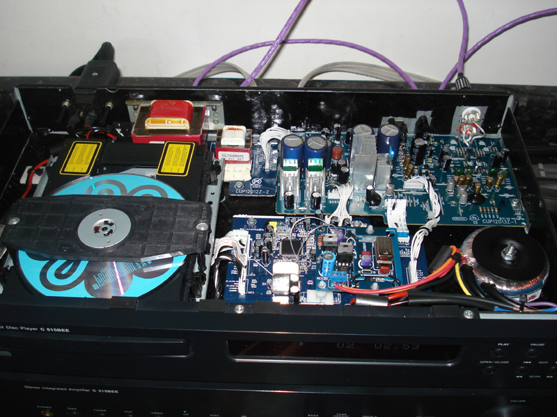

NAD C515BEE is finished.............
Hello,
From start to finish in 6ish weeks, 67 replacement caps, 3 Class D regs, opamps, CMC silver rca's, alot of dampening, a re-wire, a clock kit, a 12v toroidal, reels of mundorf solder, ground work, removal of un-needed bits, burnt fingers, quite a few problems, some mistakes, alot of shouting, waiting for parts to arrive on the slow boat from China and it's finished!
I've had a hard time finding any info on the 515, there's nothing out there at all. Nad themselves are useless. Trying to decipher chinese and Japanese is far too hard. So I had to rely on guess work and questions placed upon diyaudio.
What's the outcome? It's been a headache but it was well worth it and the Brucey bonus is......it sounds great!
I'd like to thank amc148 and Bill_P for their time, help and great info and Nick at amplifier valve kits, HIFI pre-amplifiers, speaker kits, upgrade components for a speedy, helpfull and excellent service.
There's a photo attached if anyone's interested.
Chow fa now

You're not done yet! You still have to replace the output circuitry with a discrete output stage! 😀
What are the opamps you chose? And what the D/A chip of this CD player?
Hello Andrea,
I started with the LM4562MA opamps then changed to LME49720HA (tin hats) that are TO99 fitment but I soldered them direct to the smt. There was no room under the board so I had to drill the chassis and finish them with grommets. If I do say so myself, It looks like it came from the factory so that ended up being good news.
The D/A chip is the 24/192 Sigma/Delta.
Well Bill Fuss, you may be onto something there. Only a few hours after saying it's finished, I've been contemplating adding 3 more toroidals for the dac and opamps, changing more diodes, resistors etc etc. When will it be complete?? my answer would probably be 'never', but who knows?
I might start on my Meridian next??
But then I might not and go back to the 515bee and go for a discrete output, any recommendations??

Thanks for your input (as disheartening as it was) but I'm not really into following the 'norm', hence no CD63.
The nad cd/amp combo & B&W's were bought 'just' for office at home and considering 95% of my working life is at our main premesis, they're rarely used so I thought I'd have a little play with them but then I got a bit carried away. I own other systems which are far, far better but that's another story.
Yup it would be interesting to know what DAC it uses exactly, because that's what sets the potential of the player mostly.
24/192 covers a lot of things... personally I've heard an AK4385, and I thought it sounded much worse than the CS4398.

That really depends on the dac chip, whether it is voltage or current output. IMHO, the implementation of the chip is as important as the particular chip used.
I'm a recent, fervent convert and promoter of using line OP trafos with voltage out dac chips, the simplest and most direct way of extracting everything the chip has.
For I/V conversion, jfets are hard to beat. Spencer had some inexpensive kits a while back that he has recently redesigned that are relatively easy to implement. Borbely also has a kit but they are much more expensive. There are many others too.

The D/A is the CS4392. Is that good, bad or the ugly???
It's the CS4392.I'm glad to see that you got the player going.
What model of DAC is this player using?
It's good, maybe better than expected actually. It's a good basis to play with.
Thanks, good news. Is there a 'better' pin compatible D/A out there?
Hmm, I haven't checked but I doubt that the CS4398 is pin compatible.
Anyway I don't think it's limiting to have the CS4392 and not the CS4398 in this kind of player.
BTW, in my opamp tests I found the LME49720HA to sound quite well paired with the CS4398 -- it was one of my absolute favorites.
Maybe you could try the OPA1612 too.

Just been looking at the dac supply regs. There's 2, 1 drops the 10v input to 5v (KIA11117S55) and into a KIA1117S33 (down to 3.3v) to supply the D/A.
Thinking of pulling them out and swapping both for a single 3.3v ClassD discrete module, what do you think??
I use the ClassD regs for the opamps and what I thought was the D/A supply, but it's not...... oops.
Don't know well that stuff... I will just say that I don't think the usual regulators are a big limiting factor for sonic quality. Maybe only in extreme high end audio (the sort of thing we usually see as pure craziness) 🙂
I would be more concerned about the quality of the electrolytic capacitors in the power supply lines. Upgrading these can be very cost effective. I personally like the Rubycon ZL caps a lot (for their lifetime too).
