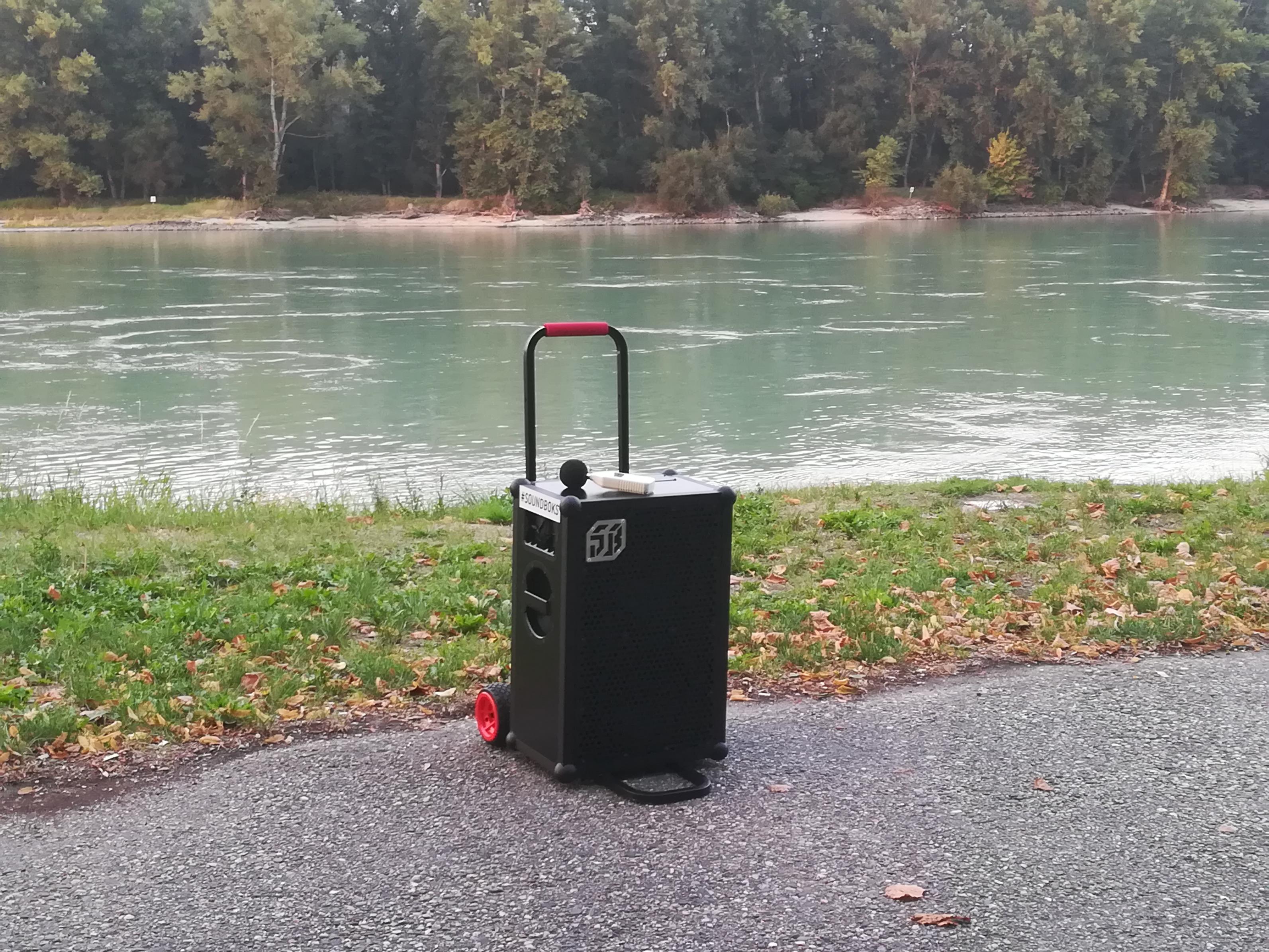

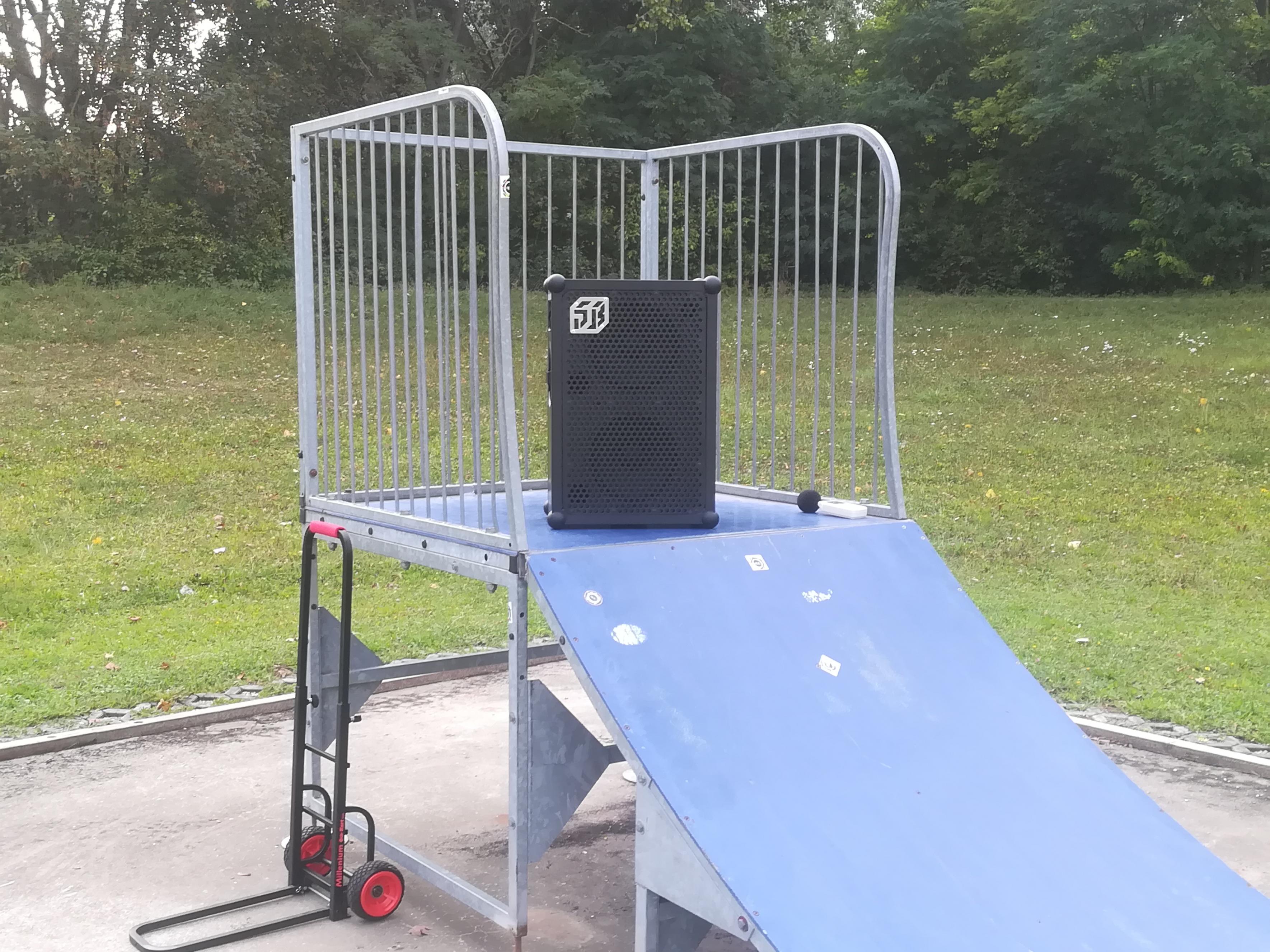

Today I did the outdoor test. Went to the football area outside the village.
Result: 90dBC, maybe 91 in 10 meters distance, slow average metering. That is it. And that is NOT BAD, since it can keep that for quite some time. After 2 hours of mixed playing, at times full volume songs , breaks, low volume listening etc... I still had 3 of 5 battery meter units left.
At greater distances on axis, the treble and bass more or less disappear and leave only the beaming midrange of the 10" drivers. That is why 70dBC at 100m is not possible, more like 65 (though I did not exactly measure the 100m).
Cannot attach fotos of today, since the computer I am sitting at has no bluetooth.
Had to change the location after a few minutes, since some camping nomades near the football area did not like DJ Klubbingman as much as I. Though it was NOT sunday and NOT night, I wasn't sure if I d be allowed to continue by law at all since it looks like the boring guys always seem to be favored by law against the party crowd. I will NEVER understand these kind of guys, NEVER EVER! Anyway I went down further to the river danube where I could continue testing. Listening to the soundboks across the big river would ve been technically possible at up to 60dBC, but there was no way to get to the other bank.
