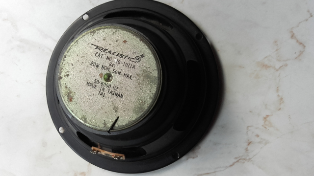

I am tired of listening to computer speakers, even the three piece systems with a woofer. I am therefore recycling an old set of Realistic speakers from Radio Shack (some 20 years ago). Will post the project and pictures here.

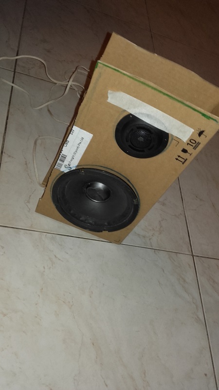

I fixed the 6 inch woofers and the tweeter to a corrugated card computer box for testing. I know the speaker will not output much bass but I wanted to see how it sounds at the minimum. A proper cabinet would only increase the quality of its sound. Also, following the rule that a good speaker will sound good on its own (single speaker) and bad speakers sound better in pairs, I decided to test only one speaker:
Results?
Volume was low, even at full power with the AK-699D mini amplifier. There did not seem to be any distortion but bass was almost non-existent, even with the bass control full up, and mid ranges seemed a little empty. The tweeter was louder than the woofer so I will have to compensate for that.
Heating up
After a short run of about 20 minutes both the amplifier and the speaker voice coil had heated up considerably. Possibly due to using the two 8 ohm speakers, woofer and tweeter in parallel, this will give 4 ohms impedance?

I had rewired a Sony CFD-6 CD tape player so that the speaker wires extended out of the chassis for external connection. Hooking these up resulted in a welcome surprise, sound was full, loud, and bass was impressive for an open box. I only tested this set up using FM radio, which is not of high quality, but results were pleasing to say the least. No heating up at all.
The output for the CFD-6 is listed as 3.2 ohm full range speakers in the chassis (since disconnected) .
The speakers are well on their way to being set in wood and finished as wall hanging units, but I may need a new amplifier.

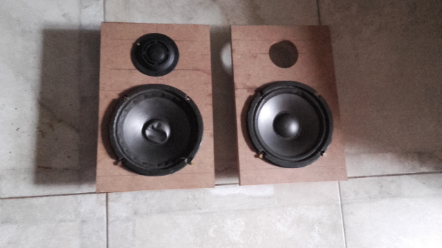

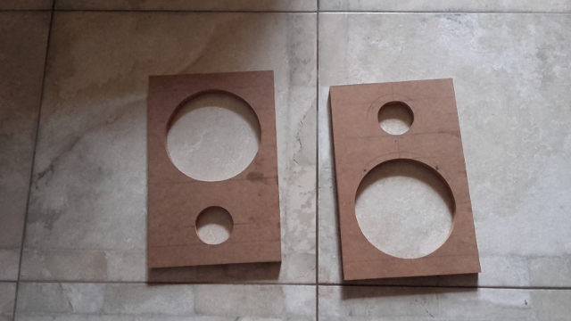

Speaker front baffles
I got the speaker front baffles cut out of MDF - cost me about ten dollars materials and labor. I intended to make the sides and top later, using a slim design like some of the wall mounted speakers made by various manufacturers, On- wall speakers they are called.
It turns out that there are speakers called open baffle speakers. At present these will function as open baffle speakers. They do not sound too bad at the moment at least the single speaker I tested was a boxy in its sound, but portrayed music with much more clarity that I expected with my 1 watt PC speaker improvisation amp.

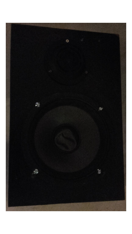

On the subject of my own speakers, I dispensed with theory completeley, simply mounting my speakers on a simple faceplate. Little did I know that I was building a Open Baffle speaker. Placing these close to the wall, since they are wall mounted, should take care of the bass.
What keeps me motivated is that this design sounds as good as or better than all the speaker I have heard so far in terms of clarity, I recently listened to a pair of Harman-Kardon desktop speakers - good clarity and amazing bass, you can even see the driver vibrate.
The important point is that the reviewers agree with me about the clarity of sound - that is all important to me now, that, and a little bass.
