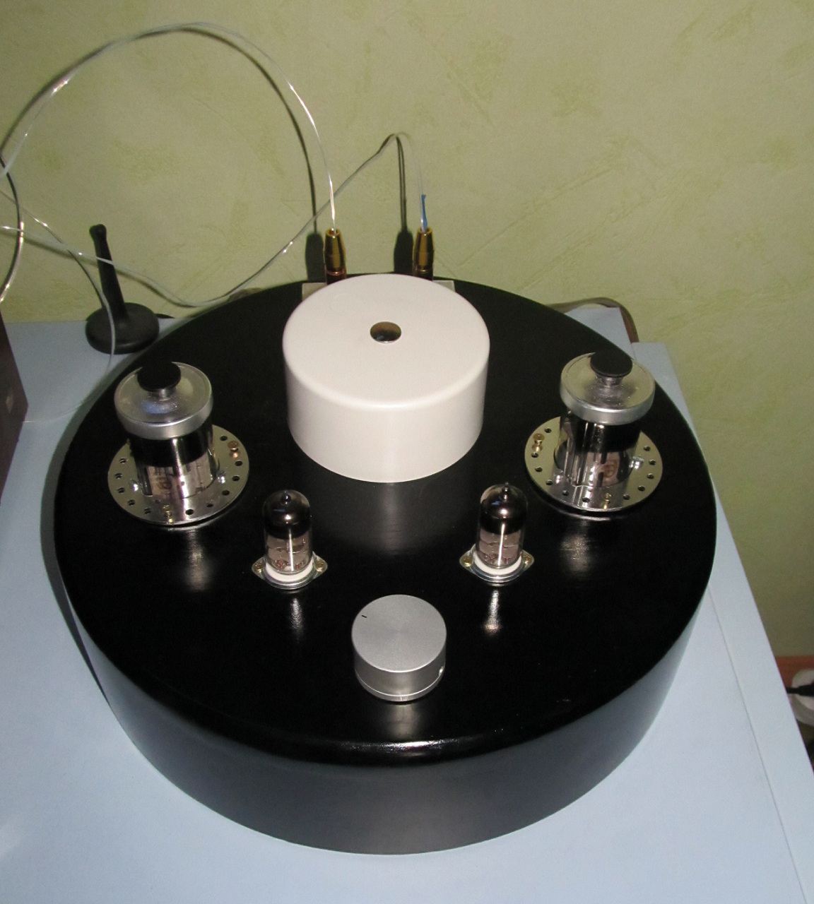

Its very nice..

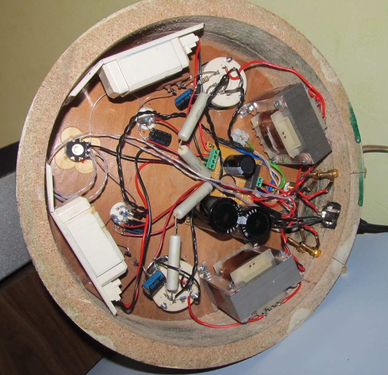

But where is the under shot of the chassis and internals? 😀

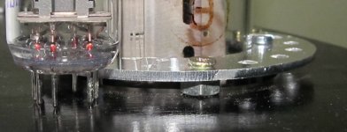

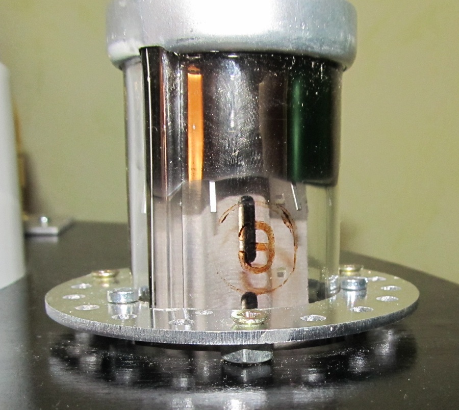

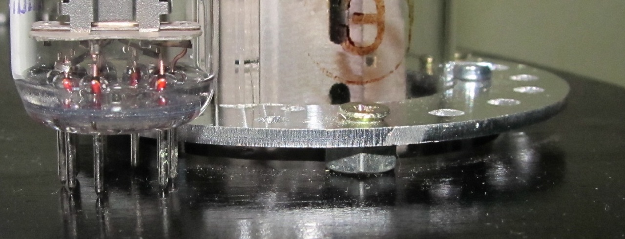

Whats the heat transfer between the GU50 and the chassis like? (How hot does it get after an hour?)
What kind of OP Tx have you used and where are they?

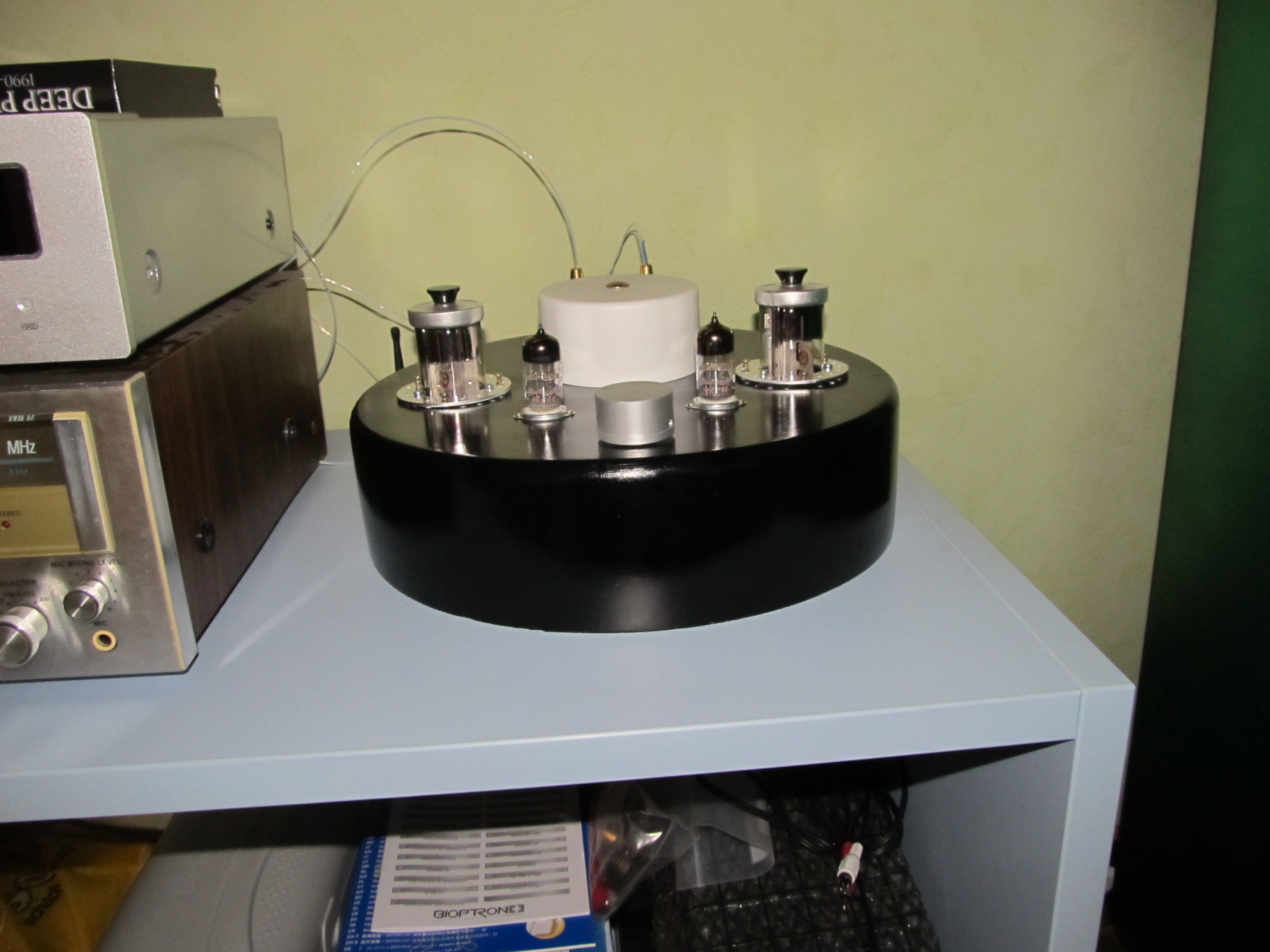

Looks nice, very original!
Triode mode?
Triode mode, I will try pentode too. Wavebourn thx for inspiration (for GU50).

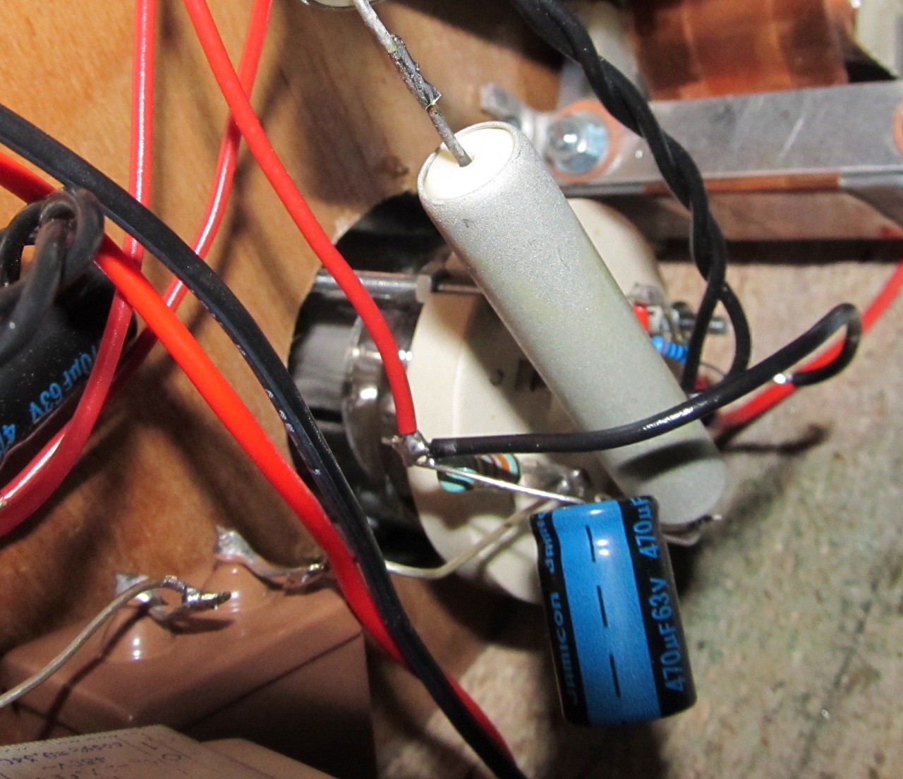

OT are from INDEL (made in Poland) - for EL84, very very cheap. All the material cost around 160€ (210$) - I use Silver mica cap 0,1uF for interstage, Jantzen Audio terminals, custom made power transformer, russian Wire wounded cathode resistors for GU50 and 21 step pot (50K log)
see the pictures:
see the pictures:
Very inventive... 🙂
What cable have you used for the volume control? Looks like PTFE sleeve..
I like silver mica caps...Interesting use of the chokes..
Whats the sound like?
Its interesting how you have managed to fit all the components into the round chassis...seems like there should be more components crammed in..LOL

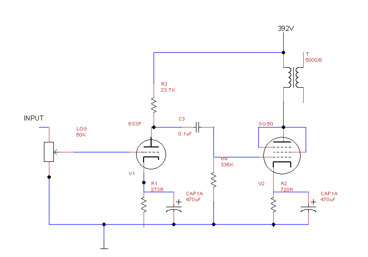

schematics please!
Shematics is very simple: only 5 elements on signal path!

The cable is 0.25mm silver in PTFE. The amp sound very good. Better than any EL34 amp I have heard.

This is my little amp with GU50 and 6C3P as driver. Power 5W without any distortion. B+ around 390V, Catode bias with 720Ohm, OT 5200 ohm.
