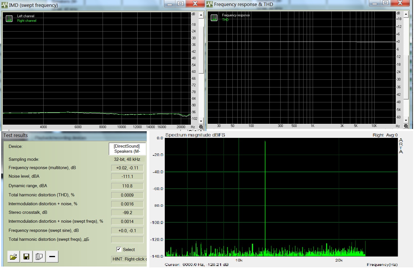

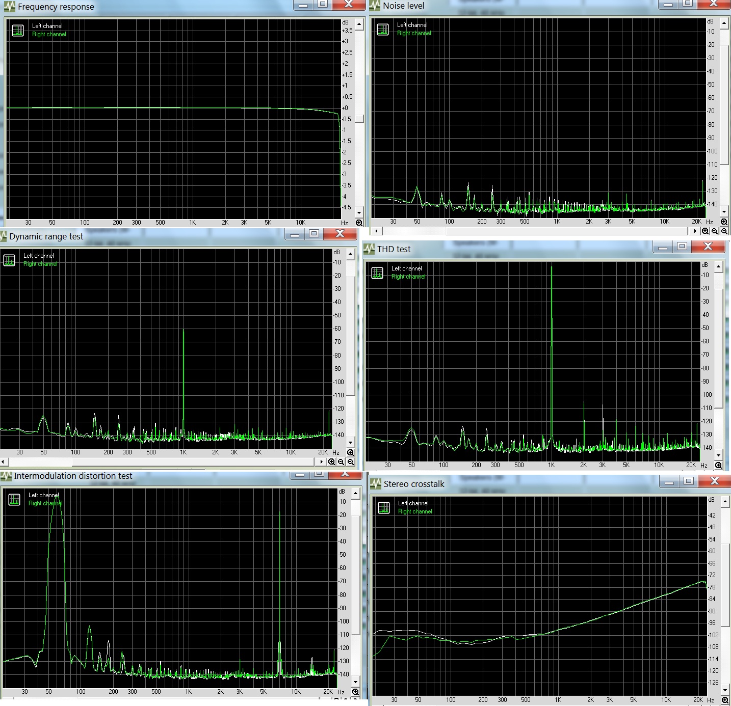

I have included, just for thoroughness a selection of measurements from the RightMark Audio Analyzer.
The results are fairly self explanatory and basically show extremely good performance. Comments in the other thread explain the noise level. The crosstalk however is down to the Preamp where there are ample situations for the signal to couple. I use a relay to swap the signal over from the headphones to the loudspeakers and with headphones selected bleed through is easily heard from the loudspeakers. This is one issue I will attempt to solve by better positioning and routing of signals if I ever rebuild the boards. The original design wasn't built in mind of the later additions so there are some unshielded wires all over the place. The overall level of -99dB from RightMark isn't exactly shabby, but this does deteriorate quite a bit as frequency increases.
The distortion can quite obviously be better then the overall 0.0009% figure RightMark says, it just requires some fiddling around with values until you hit on the right combination. RightMark requires you set input levels to specific value before it will start, so it was a little limiting in that respect, nevertheless 0.0009% isn't something to complain about.
I have included in the last image a Jitter test from ARTA, I'm not entirely sure if that's how you're supposed to use that function. If it is then the jitter is seemingly non existent😱
The sound mirrors the results, its excellent.

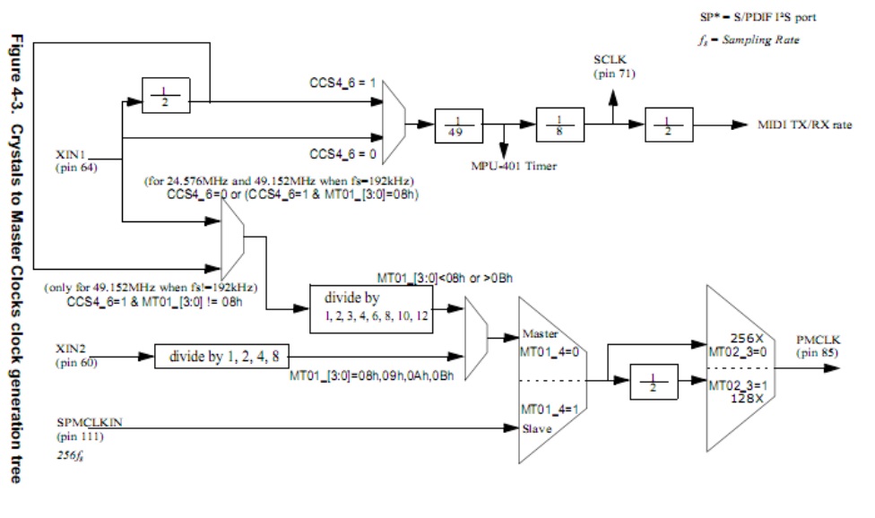

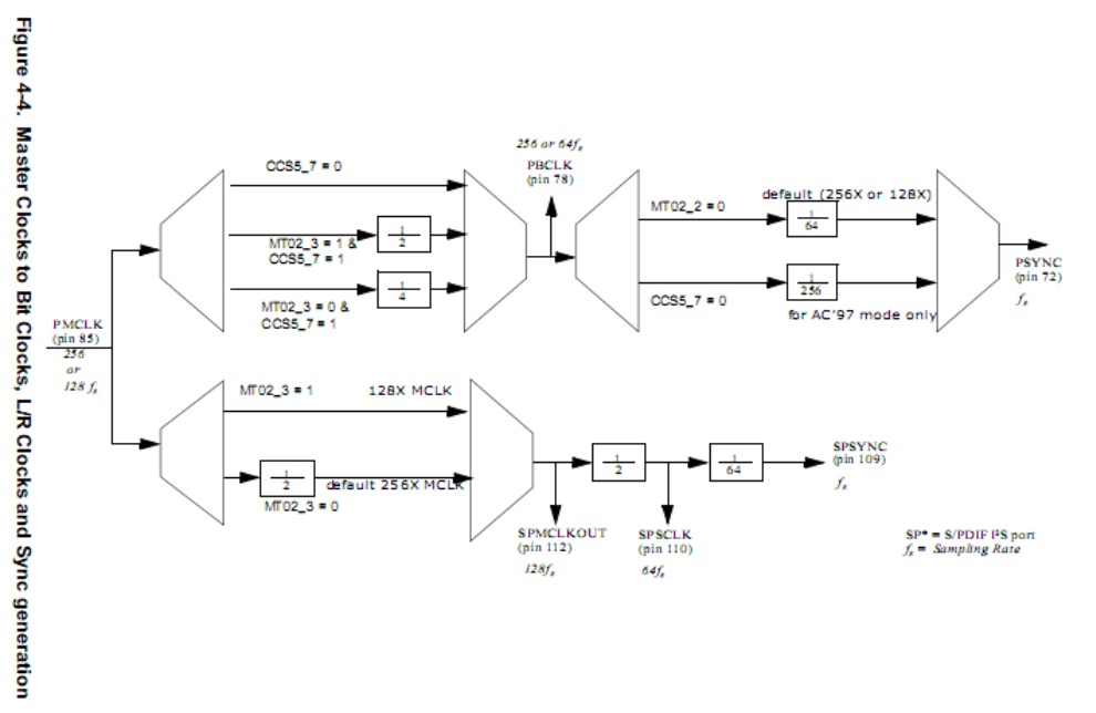

From what I can tell it isn't. The chip itself has inputs for two clocks/crystals depending on what sample frequencies you wish to use. The Revo uses a 49.152Mghz crystal for 32/48/96 and 192 khz and a 22.5792Mghz for 44.1khz and its multiples.
The data sheet implies that it uses dividers of these incoming crystals to derive all the clock frequencies that it and any other digital devices may require.
It specifies that you can drive these inputs with PLLs instead if you wish.
Of course this could just be my ignorance, the internal workings of digital chips isn't exactly something I'm good at. The data sheets don't mention anything specifically related to how the clocks are derived, except with a couple of flow charts. Now of course the blocks used could be of a standard design that represents something I am unaware of.
Attached are two images from one of the data sheets regarding clock generation.

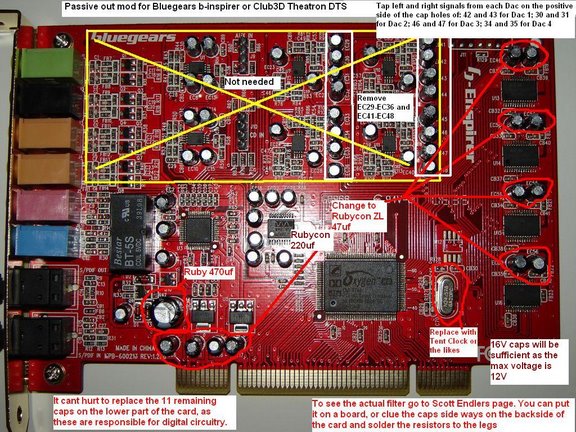

I have always wondered if it would be possible (and by this I mean easy to acheive) to change the clocks the Revo uses.
Thanks for the answer. Someone on this forum, (ID klaus if I remember) did some mods to a http://www.elitebastards.com/index.php?option=com_content&task=view&id=278&Itemid=27&limitstart=2.
The design is similar to your card. He stated trying to mod the clock but he would get some kind of time warped playback. Like when you hold a vinyl disk from spinning. I think he was using a tent clock also...
Sounds like he got the wrong clock speed then and everything played back slowly as a result. I have had similar things happen when an ASIO player got stuck with the wrong sample frequency and it played back at half speed 😛
I can't find a thread about what he did, and searching for 'tent' and the ID 'klaus' comes up with nothing.
