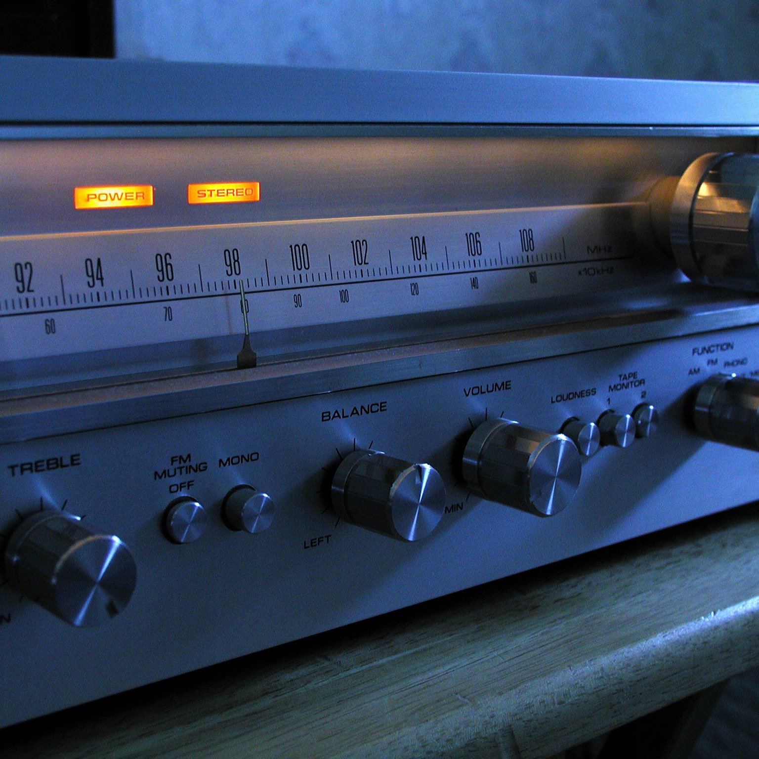

Pioneer SX-550 – Manufactured September 1976
Restoration by Retrofier Labs
The Restoration Details:
Complete Electrolytic Capacitor Replacement or “Recap” - This includes the substitution of several small value electrolytic capacitors with equivalent film capacitors for low distortion and reliability.
All Controls Cleaned and Lubricated - All of the potentiometers and switches were thoroughly cleaned and lubricated using air and Deoxit.
Solder Connections - The entire system was visually inspected and any suspect solder connections/joints were reworked.
Dial Cord Replaced - The dial cord in stereos of this vintage are often intact but slipping and making creaking sounds as they have lost their flexibility with age. The cord in this unit was replaced with a proper equivalent of the original and the pointer track was also lubricated for smooth and quiet tuning.

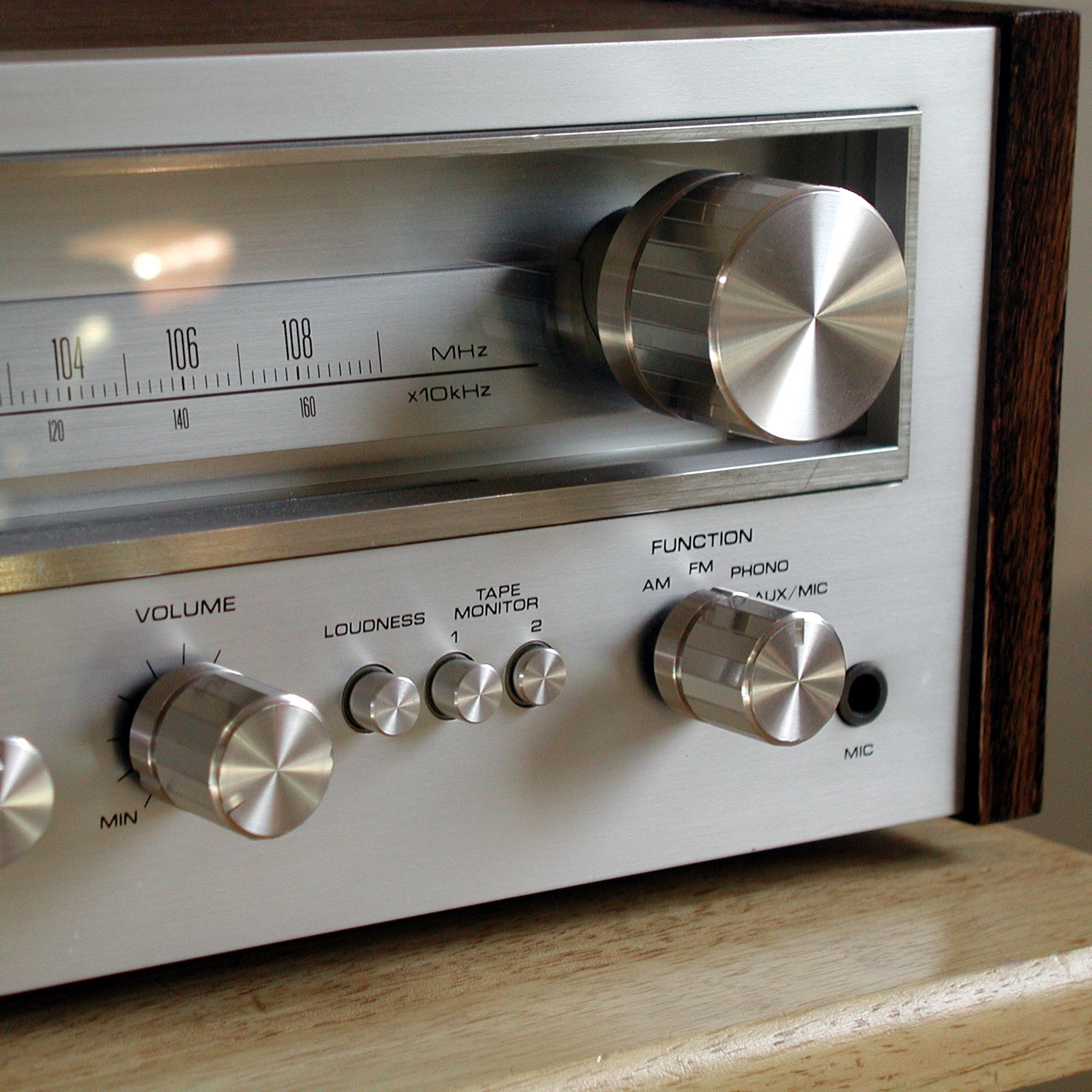

Tuning Control Shaft Assembly Rebuilt - The big knob with the heavy flywheel that gives the tuner it's 1970s feel is mounted on a brass shaft/sleeve assembly that often looses it's lubrication over time and sometimes completely seizes. It must be disassembled, cleaned, lubricated, reassembled, and carefully adjusted for the appropriate shaft end-play. This has all been done for this unit and it feels very much as it would have in 1976.
Dial Lamps Replaced - Quite often you will see old stereos with the lamps replaced with LED equivalents and that works, but I prefer incandescent lamps that give the vintage glow and maintain the original look as much as possible. The lamps I use run cooler and last longer than the originals and don't flicker or generate radio interference. Many of the original Pioneer lamps are are still working after nearly 50 years and the replacements in this unit can in theory run much longer.

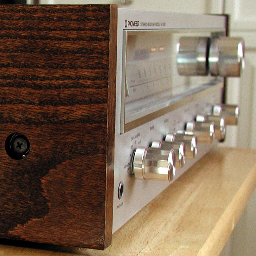

Real Oak Veneer! - The Pioneer SX-450 and SX-550 and likely others have metal top covers that are almost always like new. For some reason the material used to simulate wood for the top piece seems to last forever.
The particle board end caps are another matter. These are always in poor to very bad condition. My solution for this problem is to strip away all of the plastic material and refinish them with real wood veneer. This gives the end caps a truly "high end" and better than new appearance. I stain them to reasonably agree with the color of the top and and finish them off with water based polyurethane. This particular unit has Oak veneer and looks really cool.

Cleaning and General Condition - The exterior of this unit was throughly cleaned but not altered in any way. All of the paint and brushed aluminum surfaces are original. All of the nicks, scratches etc. are very small and not generally noticable. Overall it's almost like new. The glass is in pristine condition and the black printed lettering on the front panel is incredibly free of defects. A very well preserved stereo that's nearly 48 years old.

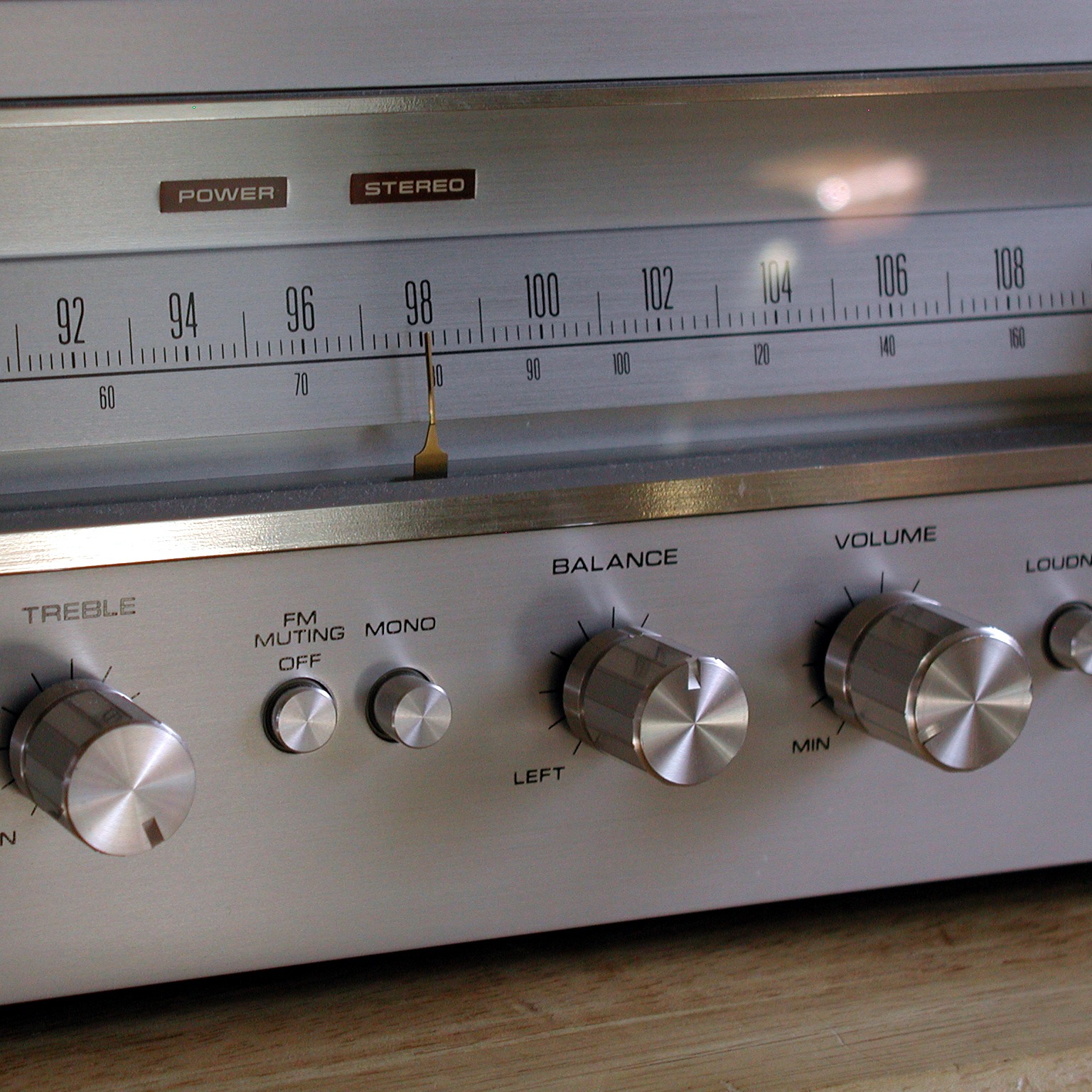

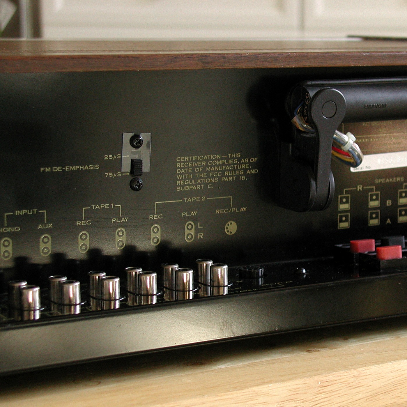

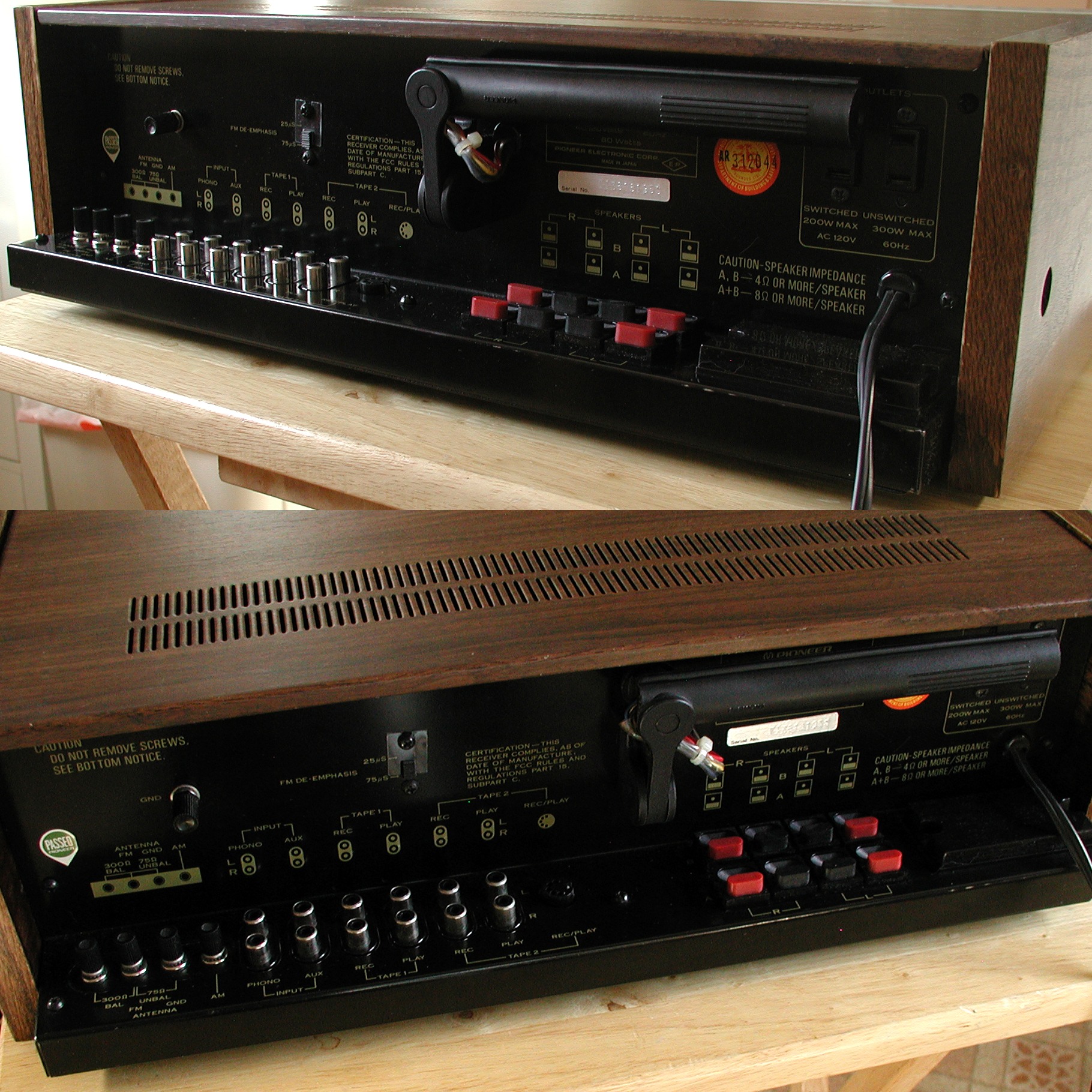

Power Switch Rebuild - The Pioneer SX-450 and the SX-550 had a rotary power switch that often developed arcing problems after many years of use and this caused behavior that can be very misleading as the symptoms suggest other problems.
The good news is that these were very well made switches that can be disassembled, cleaned, lubricated, and reassembled to end up with essentially a new switch. The contacts have generous material to be resurfaced and should last another 48 years. This unit's switch was not an exception and after the rebuilding, it works like new.

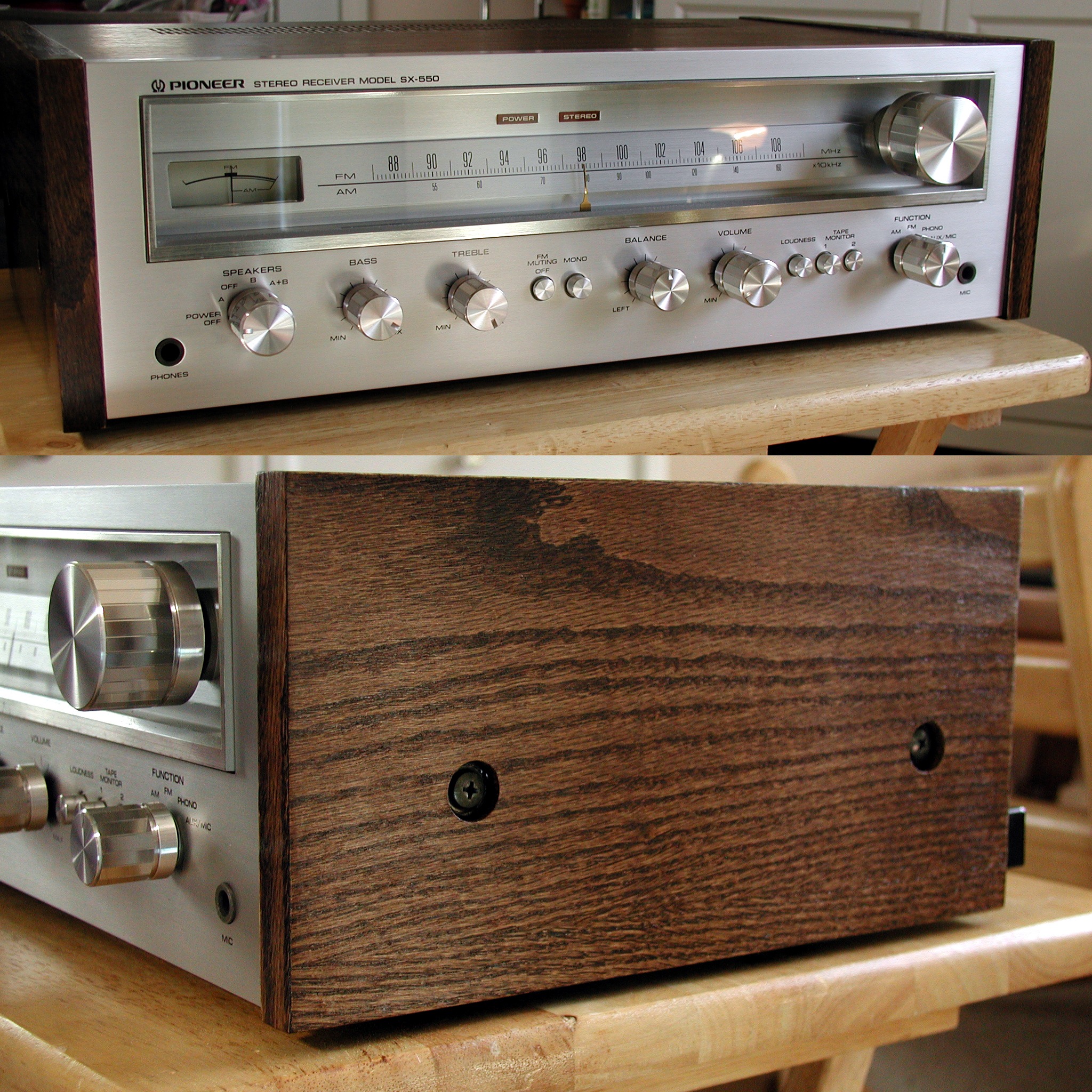

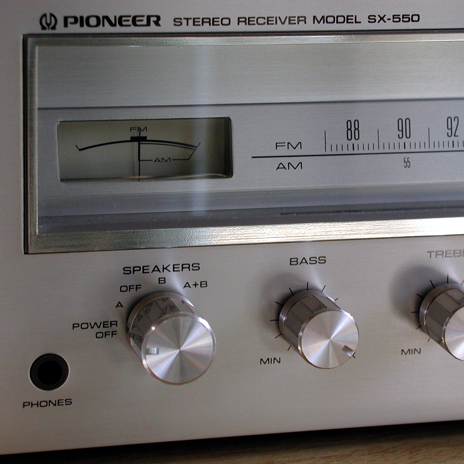

Headphone Output Recalibrated - The headphone output of the SX-550 as with most others of the era were designed for 8 Ohm headphones which today is not so common. Older stereos like this used a simple technique of dropping the power amplifier output with a resistor to get the headphone output to a reasonable level. The problem is that most headphones have much higher impedance these days and to complicate things further, there is no standard for headphone impedance(that I know of) and the range is pretty crazy at about 8 to 300 or more Ohms.
What I decided to do for this SX-550 is change the resistor to be ideal at the 64 Ohms of my Sennheiser HD 280 headpones which are very popular and sound very good. This is not to say that others will not work, it’s a matter of the volume level and with the range of the SX-550’s volume control there shouldn’t be problem for most headphones.

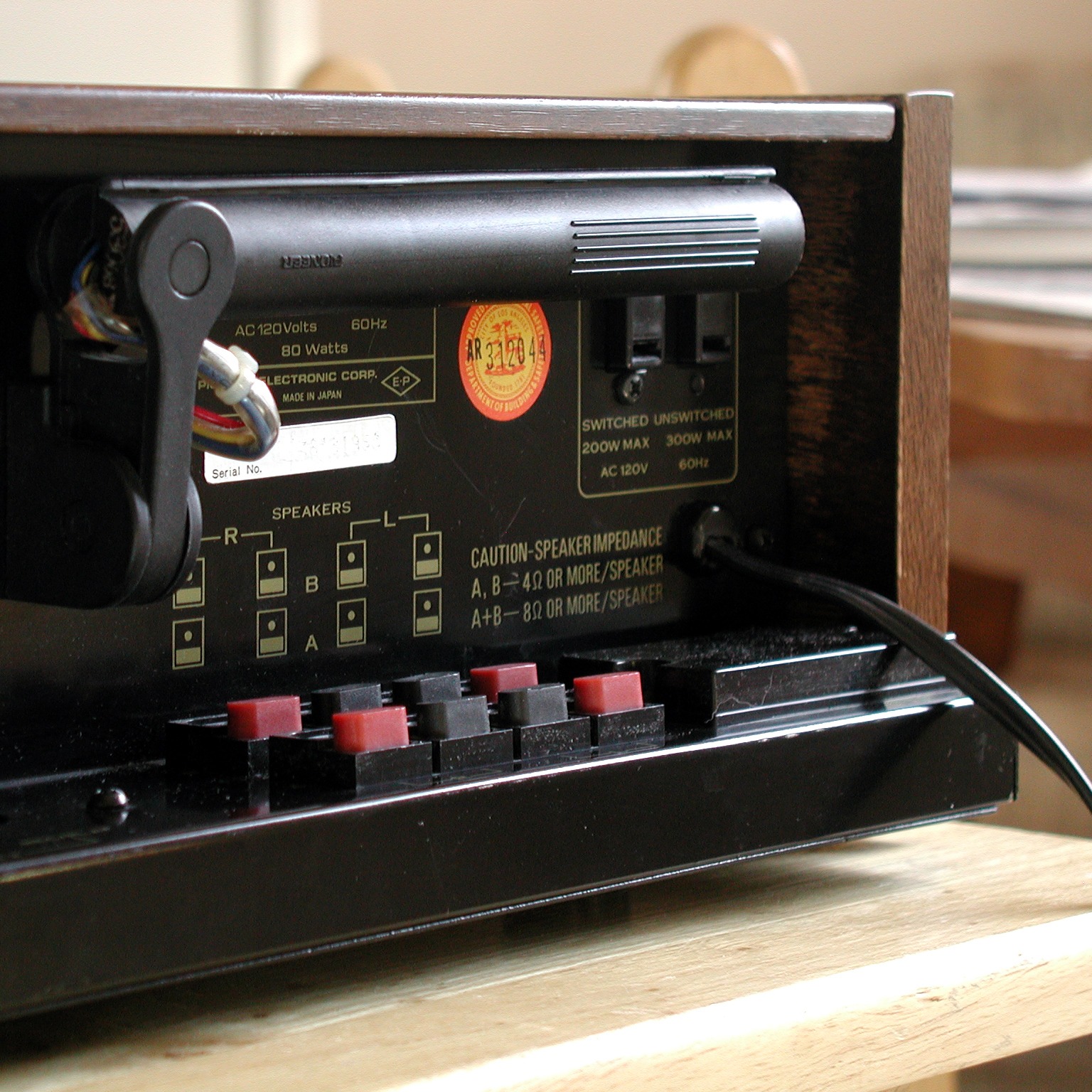

The SX-550 is rated for 8 Ohm loads only
We sold a ton of these entry level Pioneers and i don’t recall an issue with 4Ω.
dave
It's not to say that they can't survive 4 Ohms, but they certainly will clip early and spend too much time outside of the SOA. It's possible that the limitations of the power transformer saves them and if it sounds ugly you would turn it down anyway, right?
Despite the math and simulations there isn't a trail of devestation from running SX-550s at 4 Ohms. If anything it's a disclaimer from me and Pioneer that they are not intended to run with that heavy of a load so beware long term. This also would not be a concern at modest levels. Also, Pioneer doesn't say to not do it, they simply do not rate it for loads other than 8 Ohms and from what I saw in my analysis while restoring mine was that it made sense.
