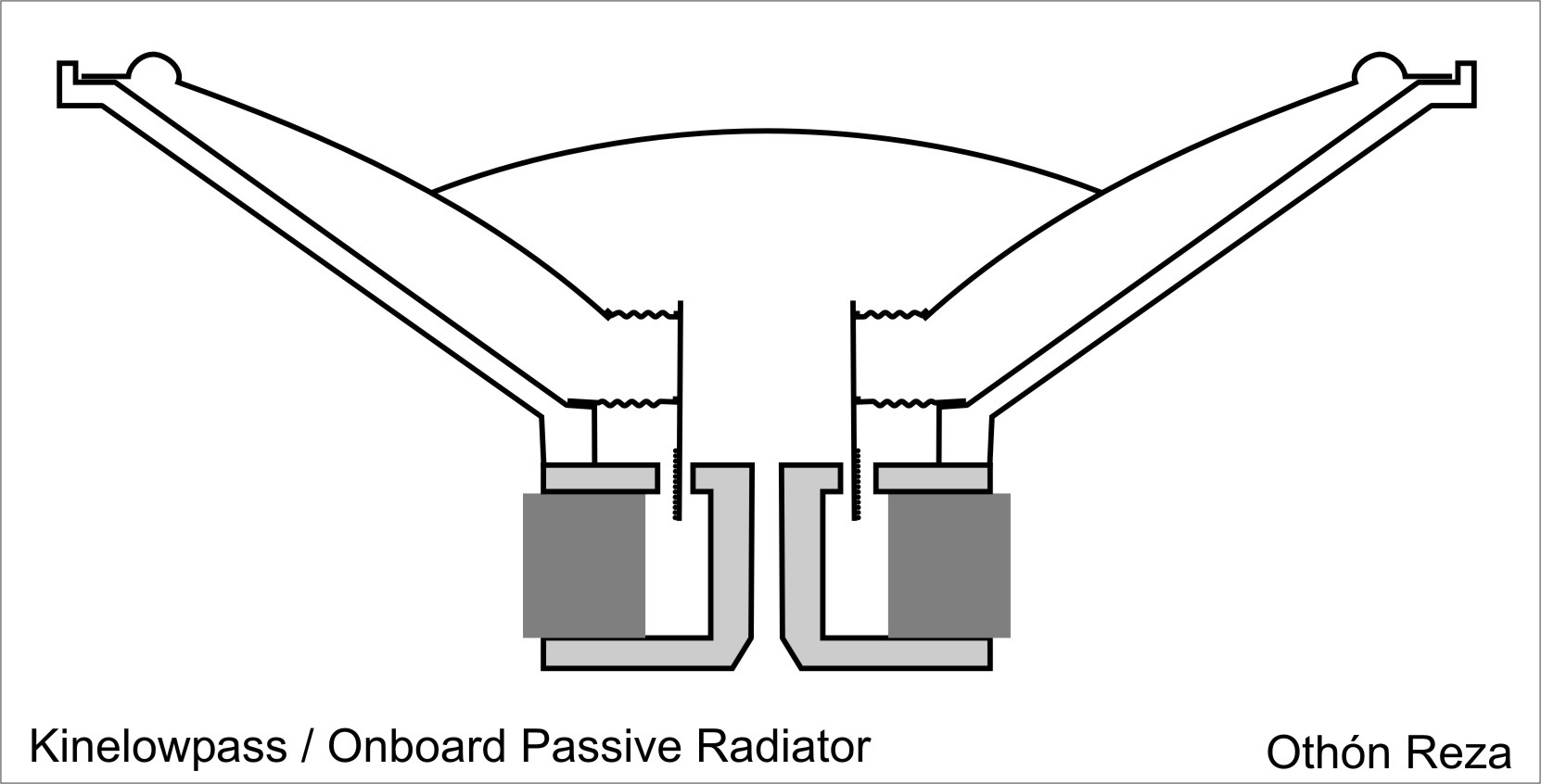

Not clear at all - what is the purpose of the voice coil attached to both spiders and not to a cone (membrane)?
That only low frequencies move the membrane,, not all the range, and the inertia works to move further away the coneNot clear at all - what is the purpose of the voice coil attached to both spiders and not to a cone (membrane)?
Not clear again - low frequencies from other driver (woofer) will move the passive membrane, but what is the purpose of the voice coil attached to both spiders and not to a cone (membrane)? Voice coil have not any purpose at all, because it is not attached to the cone/membrane.
The small and speedy vibration of a hi pitched sound will not exite the cone, only los speed and biger movements will transfer the energy to the membrane and then the mass of the cone will work like a passive radiator.

I was mislead (an possibly the OP himself) by the wrong title. The title of OP says: passive radiator, also he mentioned "passive radiator" again:
Yes, I know the how the Thiel driver works (and it was similar to a much older design) - it is completely different from passive radiator (membrane) working in a "vented" enclosure.The small and speedy vibration of a hi pitched sound will not exite the cone, only los speed and biger movements will transfer the energy to the membrane and then the mass of the cone will work like a passive radiator.
I think some language differences and creative descriptions are contributing to the misunderstanding.
My reason for bringing up the Thiels was to lend a little credence to the basic idea and hopefully try to get the discussion focused more on the action of the driver instead of the semantics of the title. I wasn't trying to one-up anyone.
OK, thanks for clearing up!
If we accept the OP design as a variant of the Thiel design, than it might be good as midbass driver with extended midrange, because the OP insists on "going for the low end". But it negates the very purpose of a wide-band driver with partially decoupled membranes (as Thiel's). For woofer duty this is not a good design.

This is for a Open Baffle design
In a certain point (45 Hz or lower) the coil moves one way and the membrane (cone and the big dust cap) MOVES in the OPPOSITE DIRECTION call it a "resonator" not a "passive radiator"

Im affraid I have no microphone to that porpuseOK, can we see frequency response measurements?

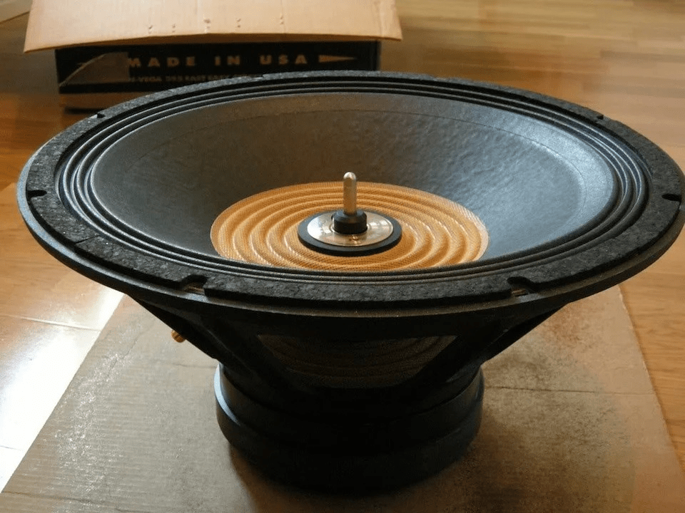

A metà degli anni '90 Cerwin Vega introdusse una serie di woofer, divenuta mitica, chiamata "Stroker".
Aveva un centratore aggiuntivo posto sul centro del magnete con un'asta stabilizzatrice invece del cupola parapolvere.
Then how do you know how to tune your idea and what it's really doing? With no measurements, you'd have to have a lot of faith in your modeling.Im affraid I have no microphone to that porpuse
