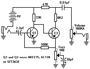

Hopefully a simple fix. I have a fuzz face PNP type circuit. it works really well with a 9v battery, however when I use a 9v plug pack problems start.
The issue is this. I have a single plug pack driving multiple devices. When all dc is plugged in it works (power to the devices in the chain). When I plug a 1/4" phono from fuzz to the little 9v amp input, power is cut. this happens with all devices in my collection. I had a thought that it is because of the positive ground the circuit has, but i cant work it out. no hair left too pull out.

If you want to run it all from one supply youll have to convert your fuzz face to the NPN version (reverse the capacitors etc) or stick to using the battery . You cant ground the positive in one unit and the negative in another , run off the same supply rails then connect the 2 grounds together either accidentally or on purpose as you are shorting the positive to the negative ..............see ....fuzz face help .....thread in Instruments and amps for some related info .
I do remember seeing, some time ago now, an effects psu advertised with eight, independent, floating, 9v outputs, rather than the usual one.
This had two possible uses: Allowing positive ground effects, usually a pnp fuzzface to be connected, and elimination of ground loops. Not sure who made it.
