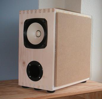

johnb said:Nice work, that MDF is it used for bracing?
Well, I bought some cheap bookcases - the MDF was necessary for the sides of the enclosures (the one side is glued on the original back of the bookcase, the other is glued on a frame just inside the enclosure.

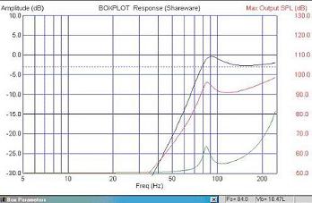

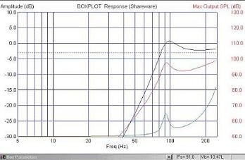

Well, it's not exactly a boom box. Fostex recommends a 11,5 cm long port (Ø 5 cm). I played around with boxplot - see below:
Well, -3 dB at 200 Hz, -5 db at 150 hz, flat until 61 Hz, rolloff. It must be possible to come up with something better.
This is better. Port length = 4,3 cm, -3dB at 150 and 80 Hz, with rise to 0 db at 90 Hz. I still don't like the -3 dB at 150 Hz, so here we go again:
Port length = 3,2 cm, -3 dB at 80 Hz.
...And the sound? Well, the last solution is absolutely the best - you can feel the bass in the floor + a very coherent sound. Try it!

I've received a few questions about the enclosure: basically it's a 30 x 30 x 17 bookshelf, bought at a local timberyard. They also cut out the sidebaffles for the speakers - so it's pretty simple.
I glued the one sidebaffle to the original back of the bookshelve, made a frame app. 1 cm inside the enclosure, to attach the other sidebaffle to (I glued that on too).
Finally I cut the speaker and port holes with a drilling machine, followed by a compass saw.
Oh yeah - and the speaker posts on the back, wiring and inserting the port Ø 5 cm, length 3,2 cm - that's it - enjoy.

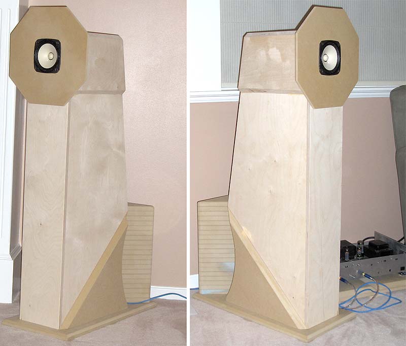

I'm crazy
Yea, I know i'm crazy, i'm in the process of making a pair, too. Just want to share, thanks.
http://home.comcast.net/~tpham1218/Bookshelf/bookshelf.htm
