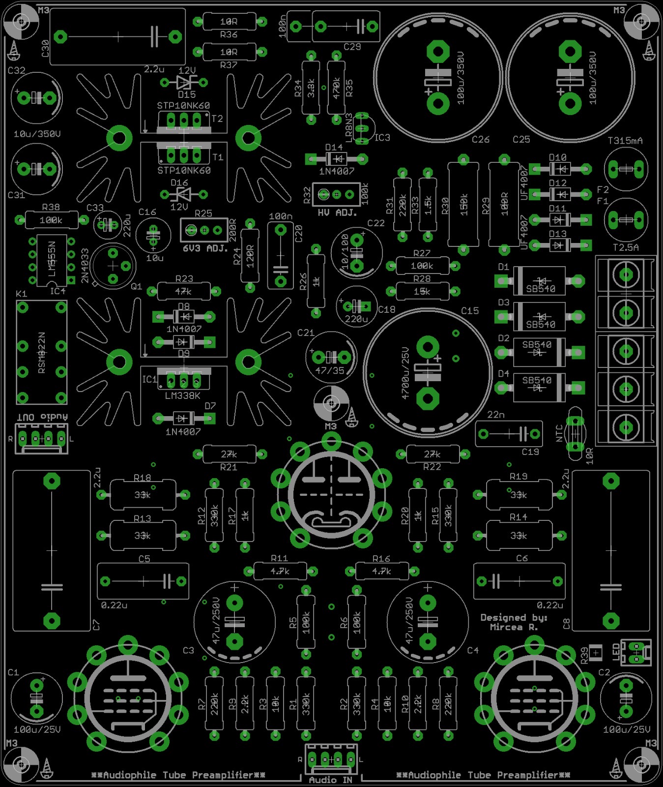

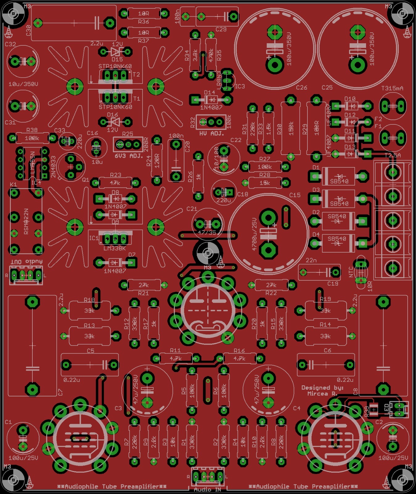

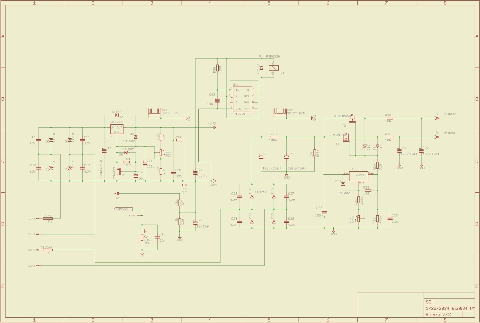

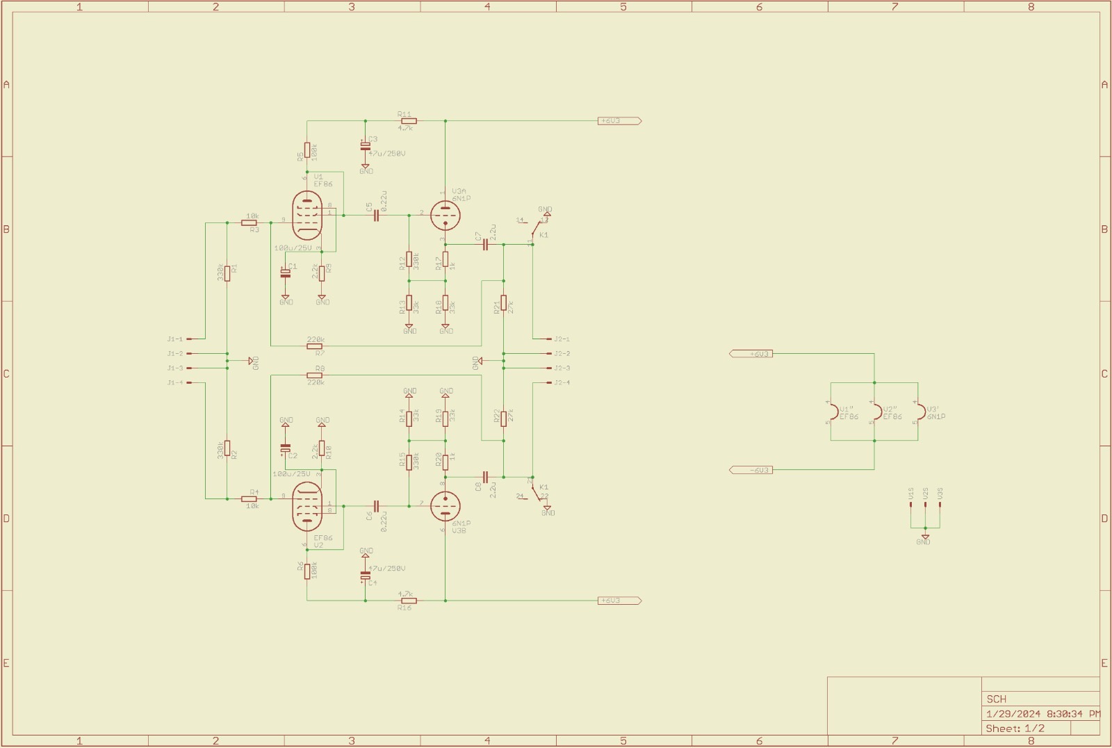

Hello!
My understanding is that you are looking for a line level preamplifier.
Considering the fact that you want to pair this preamp with your Solid State Amp, I suggest you aim for a 2 stage preamplifier. First stage will be the voltage amplification and the second stage a cathode follower, so that you get a low Z output to drive your amp.
I have recently designed and built something like this. The schematic is using EF86 triode connected vor voltage amplification and ECC82 as a cathode follower.
If you are interested I can post the schematic.
Mircea

I was going through a lot of preamp/tube builds in this forum; 90 percent of the time I don't understand them, but still, I have designs in my mind, so while checking 100s posts, I came up with this preamp build that looks like what's in my mind. I am thinking to proceed with this build. I can only complete this project with the help of all you guys; I can only assemble and solder the final PCBs together; I can't change or redesign anything by myself.
