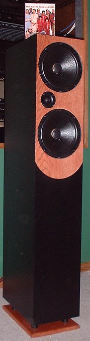

My first "real" DIY speaker project, actually, one of my first "real" woodworking projects besides a simple sealed subwoofer.

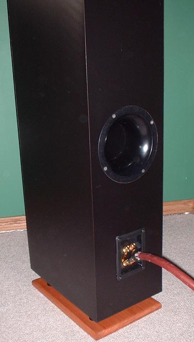

They are basically Adire audio's KIT281. I still need to clean up the edges, stain them, and put on some small pillar/bases I designed (yeah, I know, mounting the speakers/hardware too!)
I decided to vent them out the back. I also ordered the wrong sized port (4"), so hopefully, a 90 degree bend in the port tube won't effect the sound too much (needed to fit 15.57" in a 14" deep box!).

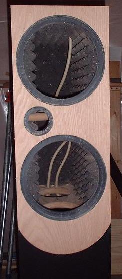

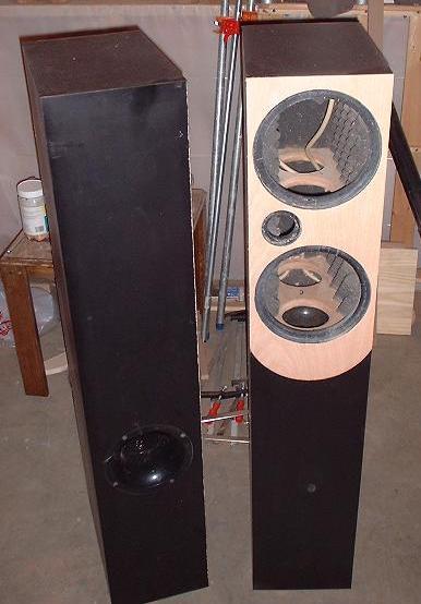

I used plastic laminate (formica) all around, with red oak veneer.
I also entered the world of biscuit joining, for the first time ever (I've heard they are better for cabinets than screws). Besides to mount the port, it's all biscuits and glue. If I had to do it over again, I wouldn't have used so many freakin' biscuits, since gluing up even 2 sides is a frantic experience. The biscuits expand really quick, making your work setup really fast. Good thing I bought about 12 clamps, otherwise, I'd have ALOT of scrap 3/4 MDF...

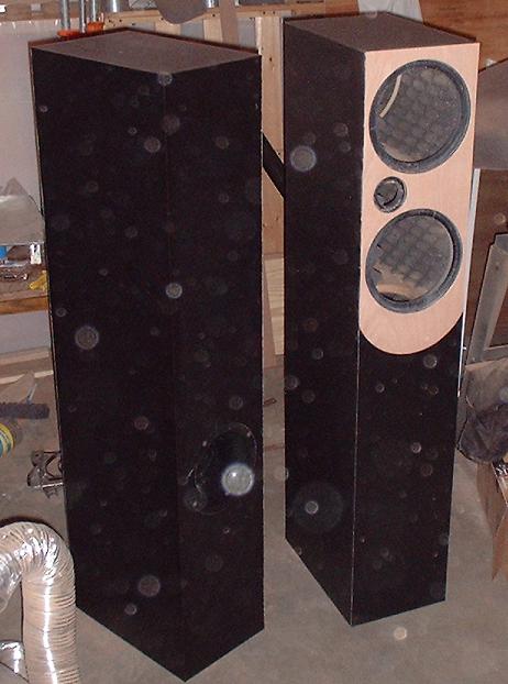

If you work with formica, watch the edges! I've got 2 nice cuts from running my hand down them, even after cleaning them up with some steel wool.
I'll post again when I have the completed pics. I don't know what the heck those spots are in the image, but, I'll be sure to get better ones when they're complete.
