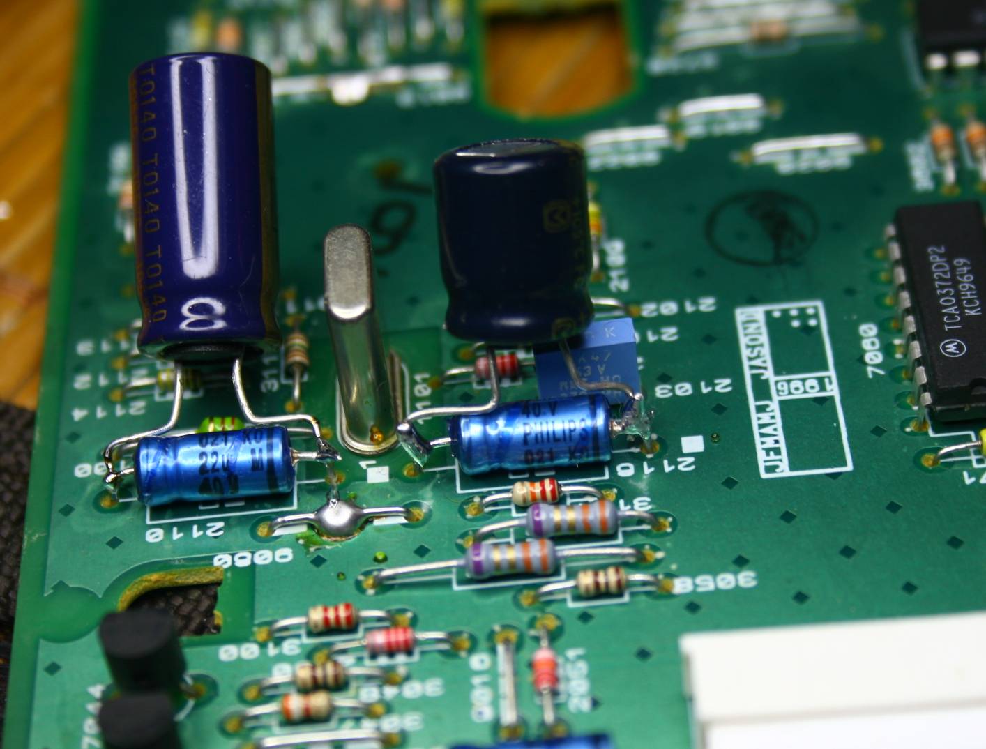

I suffer the latest time by this fandom problem. I disassembled it, I replaced the switch and turntable motor cables, I cleaned both the switches connector surfaces. But it keeps doing the same problem .
I have ordered a banch of TCA0372DP2 Motorola driver opamps that control all functions (lazer supply, turntable motor, sledge motor, focus & radial drive etc.) I have not yet replaced the old opamps, but it was my last hope before to search for a new mechanism. Can you provide some pictures of what you have replaced on your player. Was it only the cartidge including lazer flex board and also TT motor and sledge motor?or the whole mechanism including tray and tray motor?

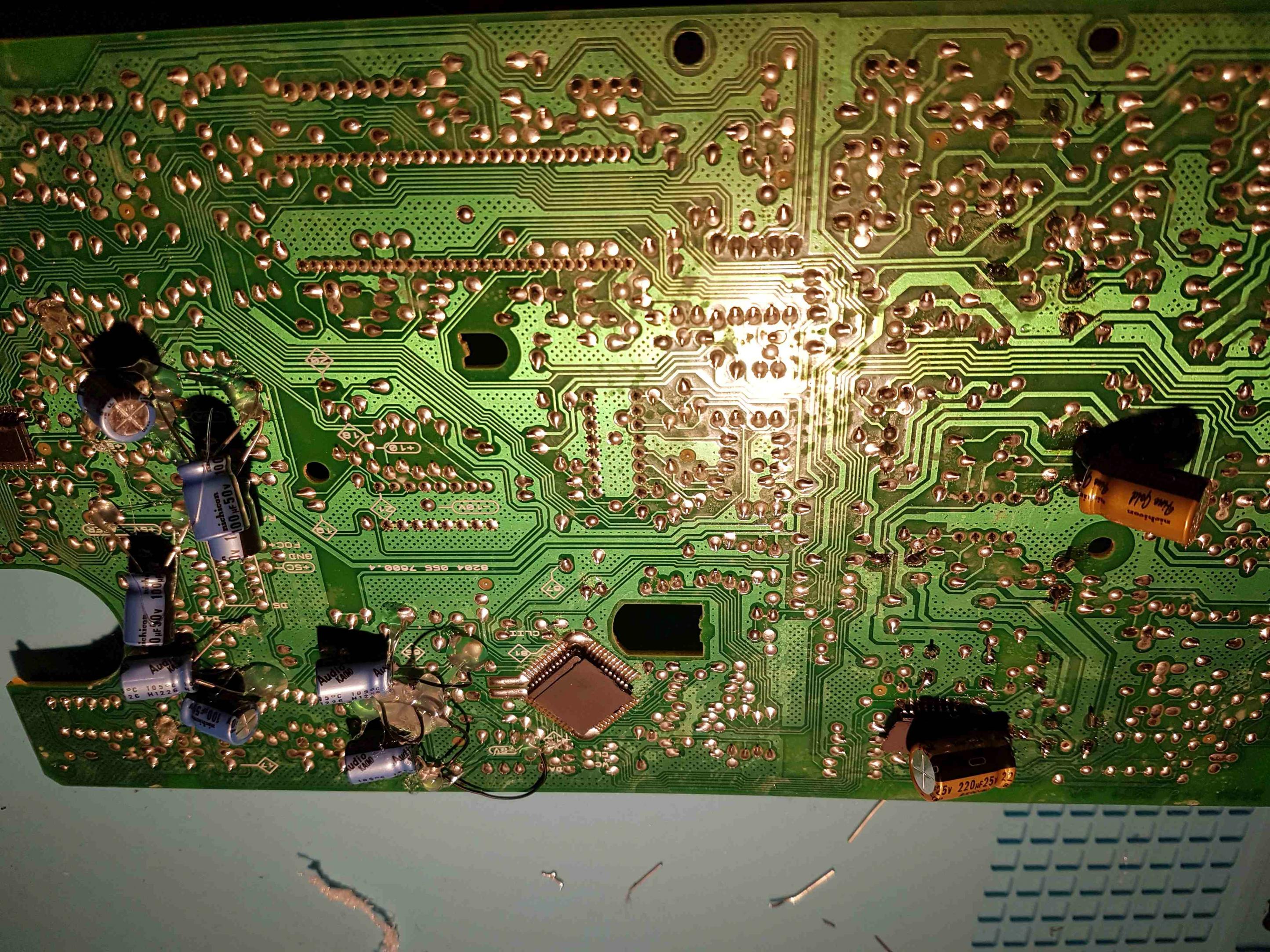

replaced PSU caps and regulator, now it again wont play CDs. In service mode it says "sledge error"
Long shot perhaps, but you may have disturbed the sledge drive mechanism. Check that all the components which move the pick-up are moving freely.

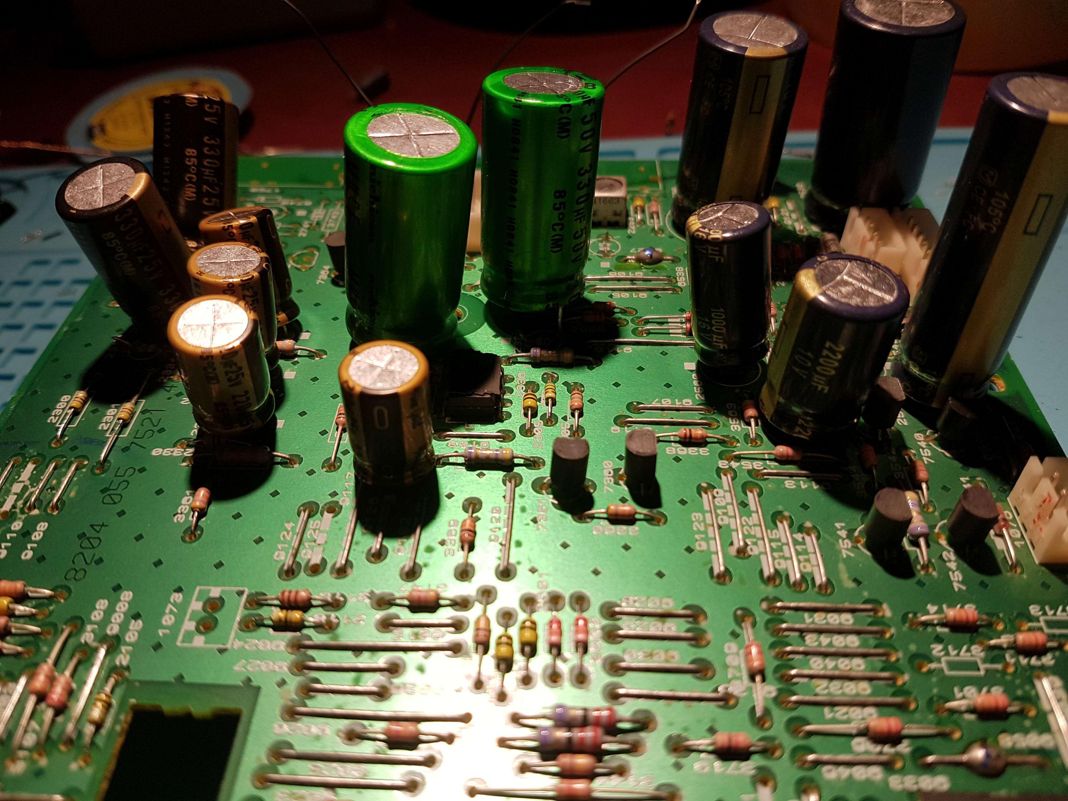

Replaced all caps with the most high end + new regulator + new RCA sockets.
Can def tell how much fuller the sound is, before i needed the loudness option to make it sound good now i can use the direct mode on my amplifier.
I also disconnected the headphone connector and unsoldered the cap feeding the digital out socket + adding ferrite foil on the CPUs.
Now I wondered where to go from here. I plan to connect a seperate regulator for the DAC + a decouple cap on the DAC input. I assume a film cap would be best for this , any brand/value you guys suggest? Would a film cap on the DAC enough and maybe skip seperate regulator? What pîns would i need to lift and wire to the new regulator?
Also wondered where i can cut off the digital out earlier, and I read about the "mute" causing interference but not sure how to cut that off while not messing with the analog out. All input in welcome thanks!

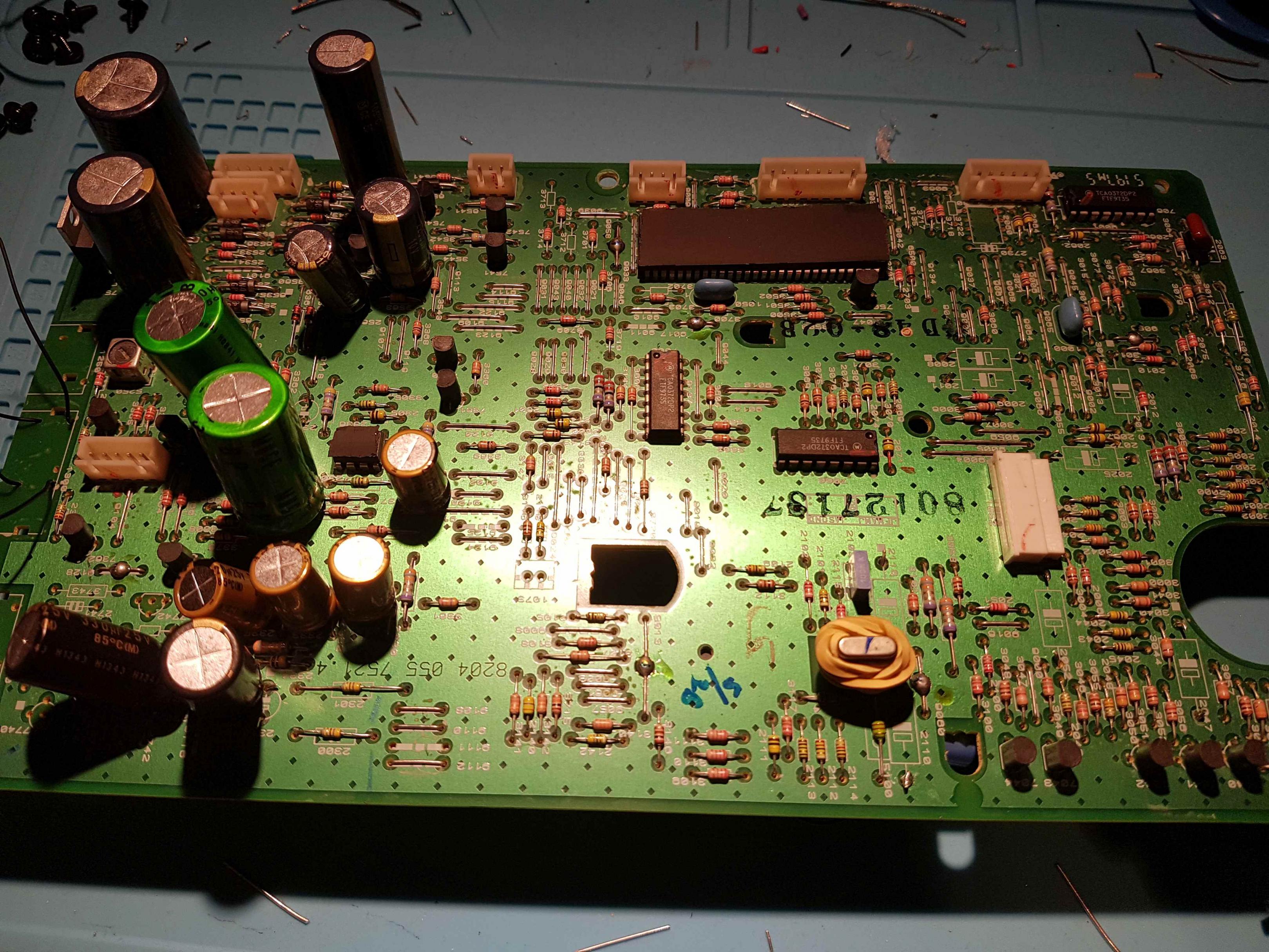

Pictures of current status, already sounds wonderful compared to stock. No need for loudness mode anymore.
Could still use some input with the above questions. Another one is if i should put a 220µF 16V cap on the output of the 7805 reg, all chips should have their own dedicated cap but maybe a cap on the output wont harm with smoothing out.

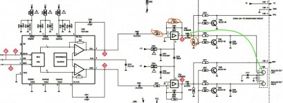

Attached is a section of the service manual
I marked only the left audio channel. After the DAC comes 3302 which is a 10k resistor 3304 which is a 15k resistor.
I plan as advised to exchange these for metal film equivalents. After some research i read good things about the Takman Rey series.
a 10K 0.5w would be replaced by (REY50-090) - 10R 0.5W TAKMAN Metal Film Resistor | Hifi Collective
After that i am not sure how to proceed. i have custom RCA plugs now so i can just wire the signal from anywhere. I planned to connect the RCA straight to output of the 2306 cap ( green line ) and cut the trace after that ( red line ) to avoid interference from the headphone and mute circuit. But can i just avoid resistors 3306 and 3308 like that?
Diodes wise i plan to upgrade 4 PSU ones to the following schottky 11DQ10 Schottky Diode | Hifi Collective
