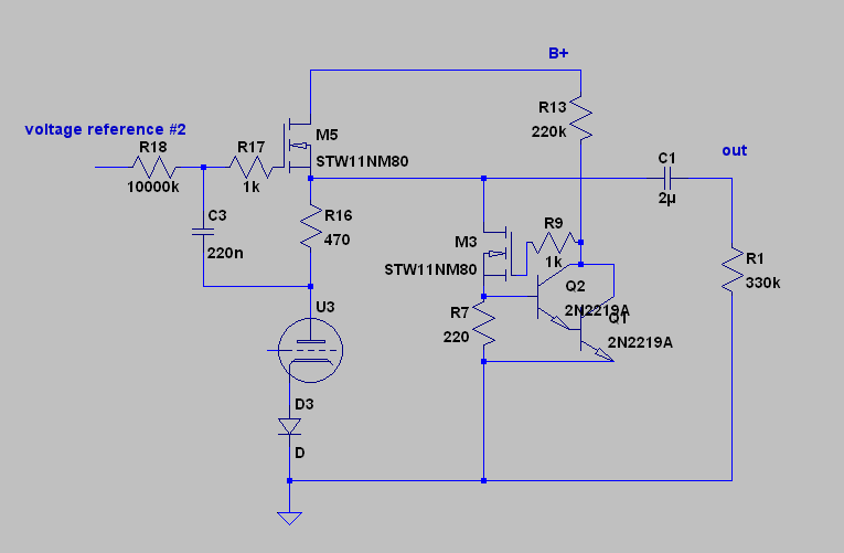

I plan to build phono pre with E180F (TESLA gold pin) for Shure M 75. Hammond 126C I have in stock. I know it would be better to use Lundahl. I will use Russian Silver Mica capacitors (SGM Series). For power I plan to use 2x Salas SSHV2. I ask for comments.

I like the sound of E180F in triode or in pentode mode. It also has right MU (around 50) for Phono pre. Source follower - you mean add another tube and one cap?
The 126C has a rated secondary load of 10k, but you are loading it with a much higher resistance. If you want anything remotely like a hi-fi bandwidth, you're going to have to reduce the load resistance. But since the 126C is unity gain, it doesn't actually do anything useful in this circuit, so I would suggests forgetting about it and saving the iron for another project; a resistive load would give better performance.
The E180F is also going have some fairly taxing Miller capacitance (I guess about 250pF at least), which is rather a lot to load a cartridge with. Having said that, a lot of people seem to like the sound of a load of load capacitance, so this may be a moot point to you.

As Merlinb says. Instead you could use E180F in pentode mode (stage 1) and avoid miller C issues at audio frequencies, BTW. You could also obtain more gain from stage 1 that way, perhaps enough to make stage 2 a true triode cathode follower (I haven't checked), and so get back the slight partition noise stage 1 penalty? And after all, E180F is a nice little pentode, seems rude not to use it that way IMO. Not clear what the tx's add, I'd agree save them for another project. HTH !

If you tie g2 and g3 to the plate with carbon resistors you can try out loads of pentodes without any changes d3a, 6j9 etc, some of them have opposite grid 2 and 3 pins. I have used dn2540 mu followers on my mc phonostage, you then take the aging anode impedance increase out of your filter calcs so frequently response should be more stable and at the output it works as your buffer

Yup, that seems to suffer similarly as to miller C effect, in principle. Thing is it sets an irreducible minimum loading C for MM carts, so you can't get below this and some cartridges might beneficially require to so. There's also phono cable C, tonearm wiring C and in this case tx self C to add in too. Whereas if stage 1 is in pentode mode, miller C at least becomes a non-issue.....Req is about 500R for a E180F in pentode mode versus about 250R for triode mode, both are OK IMO and smaller than noise source within coil resistance of typical MM cartridge anyway. And I think with good care there is enough gain available to use a single gain stage (plus buffer stage)..... and there is something 'correct' about using these excellent little pentodes in pentode mode IMO, to do things which are otherwise unavailable.I got my inspiration here Hi-end phono preamplifier.

Seeing the combination of the E180F's high gm and Merlin's note about Miller capacitance, and as you were already talking about using shunt regulators in your original post and the circuit can use them, you might also be interested in Rod C's shunt cascode with the Salas regulating the transistor's base V.
Rod explains the circuit operation here.
