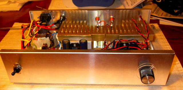

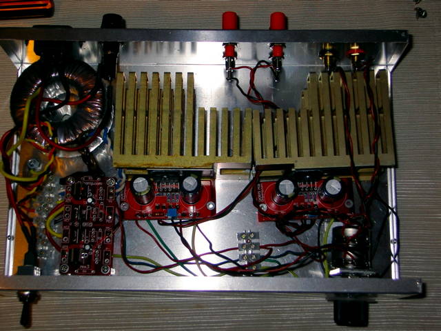

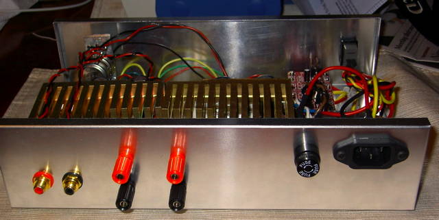

Actually few months ago I have completed my first gainclone based on BrianGTs LM3875 stereo kit. Besides test light bulb turning on after assembly, I have not encountered any major problems. Removing all parts out of the case and putting them back on fix the bulb problem. Kit was pretty easy to assemble but I wish the manual was updated to the latest revision with better description of the pot and CT trafo instalation (for noobs like me). I had to buy the kit, case, trafo and all the small accessories so the total cost was way more than I have anticipated. Still worth it though.
My current setup is Denon DRA-295 stereo receiver, Yamaha DVD/CD player model DV-S5750 and Mission m30i speakers with Infinnity BU-1 subwoofer. Nothing fancy but it suits me well. When I have replaced the Denon receiver with gainclone I was running only the Mission speakers without the subwoofer. After the test run, I was pretty surprised at the bass response of the speakers without the subwoofer. I must say that I like the sound. The highs and lows are incredible (comparing to the Denon receiver). In my opinion, the only thing the gainclone lacks are the mids. Gainclone sounds more dynamic but the lack of midrange is noticeable. Still blows away Denon.
So that's what I wanted to share. Pictures are attached. You have to excuse the mess of wires as it was my first project. Space in enclosure is very tight because I think I went overboard with heatsinks. After 4-5 hours of playing the heatsinks are not even warm (did not try touching chips).
