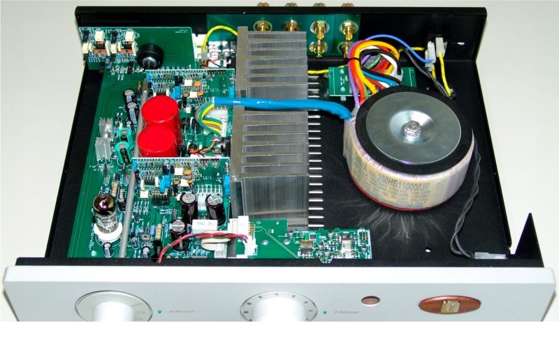

The Amp about
PASS AM ´¿¼×À๦·Å£¬ºó¼¶£¬ÒôÉ«ÌðÃÀ - ÌÔ±¦Íø
I cannot recommend, because the quality at least of capacitors isn't good (have a look to the photo of that auction).
Some people claim, the Unico P was class A. But what means that? For me the actually question must be, what is the exactly value of the idle current through the output stage (not the whole value of the amp)? If there are 100 mA, then all power below 100 mA through the loudspeaker is pure class A. If there are 20 mA, then all power below 20 mA through the loudspeaker is pure class A. This means only low level in pure class A.

hi. thank you for your continuing inputs. I'm pretty set on this chinese diy amp, however. 1000rmb is not that expensive for a starter amp. I agree it's got some shoddy components but I figure if i like the sound enough as it is, this will be my first guinea pig amp for diy. at least the transformer are real potted core types and europian made, according to the ad. I'm not a fan of bi-amping, if that's what you're suggesting. last time i tried that, the timing was off due to the different slew rate between the amps and that made the music lose coherency.
