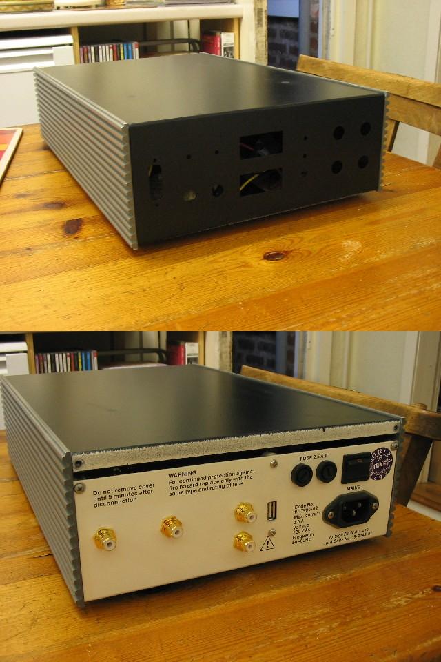

OK I decided to whip the lid off and took a few pics in the process.
Right first pic the DAC clothed, I have not yet made a front panel so as you can just about see in the pic there are a few holes in the front. The case used to be a very high voltage PSU used for running gels which separate DNA. This was very handy as it had a filtered mains inlet with a switch and two fuses already mounted. I spray painted the lid black. The back panel hints to the origins of its original colour. Not very hifi!

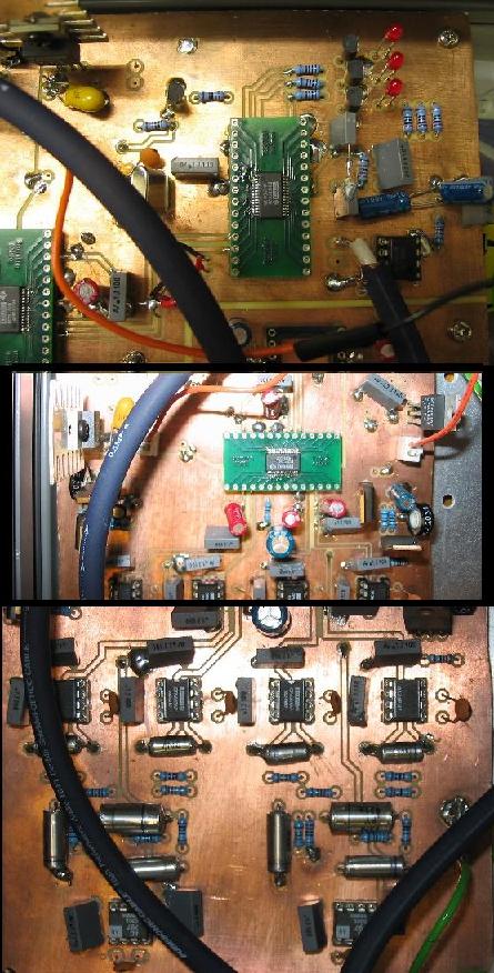

Last photo. This is really just a close up of the various bits, first of all is the DIR1703 with the PCM1798 lurking in the corner. You can see that there is an empty DIP socket to the bottom right, this is for a PCM2902 when I get a replacement, cooked the 1st one, had the USB wires wired back to front
I dont think the chip liked it too much. Next is the PCM1798, here you can clearly see the sink on the reg. And then finally the IV stage, which has OPA627 first and then AD797. Here you can also see the polystyrene caps which are bloody huge in comparison to the polyester ones used elsewhere. The grey buses (ie box shape) near the opamps and 0.1uf polyes, the close caps to the four OPA627 are 8.2nf polystye you can see the difference there.
The original pics taken by the camera look a lot better then those but unfortunately are 600k each so you see the problem lol.
