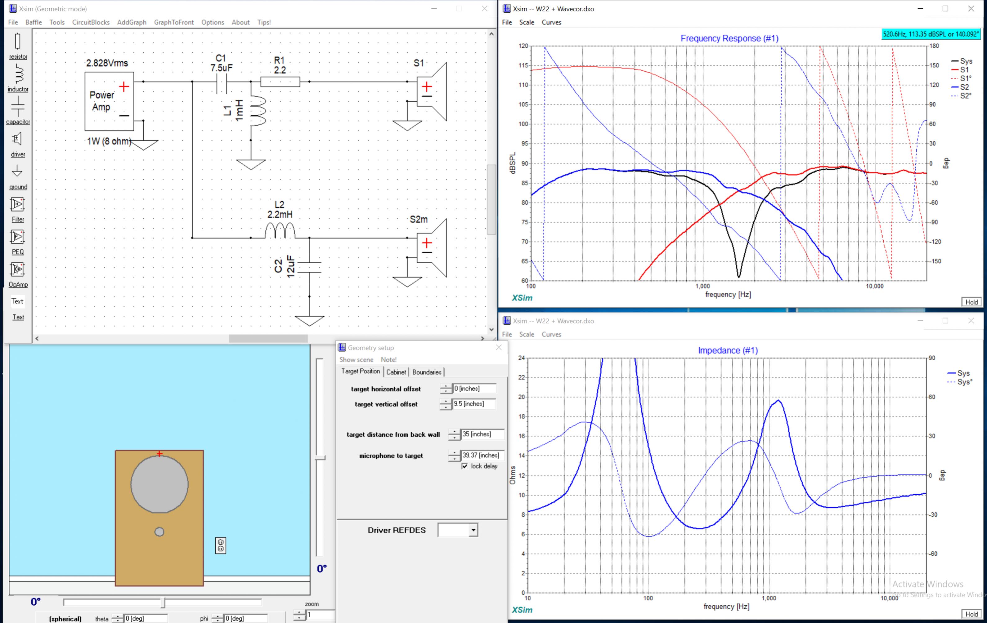

My first attempt at a passive 2-way - any input?
Here goes my first attempt at a passive speaker 🙂
I've aimed for drivers with smooth rolloffs and/or allowing for a simple/minimal crossover. Other goals was decent sensitivity and power response.
So I've settled on 3 alternatives:
Seas W22NY001 + Wavecor TW030WA12
Seas W22NY001 + Morel CAT378
Seas A26RE4 + Morel CAT378
I've attached simulations and relevant files for the first two.
The latter combo has numerous battle tested crossovers out there.
Note the listening height in the simulations (phase only matches up at that height)
I really like waveguide tweeters that can be flattened out with a simple cap like the CAT378. And since Seas does their measurements on typical baffle sizes for each respective woofer size, their measurements include baffle step. Which makes things a lot easier to simulate. And their measurements are proven to be trusted.
Any input?

Did some simulations with the DXT, but it didn't lend itself to a simple filter.
Looking at the nicely declining response, I would think you could simply flatten it out with a small cap and end up with a natural roll off at 1-2 KHz. Proved itself not to be the case.
So far I've found the Morel CAT378 is the easiest tweeter to cross (only needing a single small cap). However, judging from tests it seems the Wavecor one outperforms it.
Maybe there are some small compression driver/horn combination out there that works with a single cap?

Isn't a notch filter at such a smooth driver as the W22 a little overkill? :scratch2:
Joachim Gerhard assured me he'd got the DXT working with the U22 on a simple cap and resistor, and bass coil network.
Here's what I got with a cap and resistor, but I doubt it protects the tweeter enough?
Both the W22, U22 and CA22RNY all seem like excellent and easy to work with drivers. Guess I'll just simulate them all to find the most fitting one for whatever tweeter I settle on.

So I've pretty much settled on the CA22RNY with the Wavecor TW030WA12.
Done quite a bit of fiddling in VituixCAD, and think I've found a good foundation for a XO.
One variant at 1900 Hz and another at 2300 Hz.
Any input? 🙂
