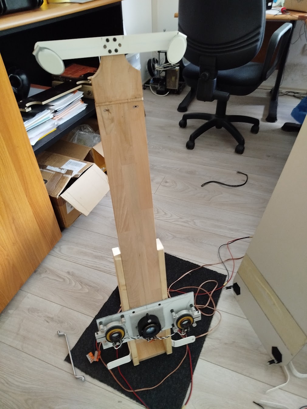

a) Yes, I installed 3 exciters on same panel. They are mounted close to each other, but with slight offset.
b) Yes, I used two different exciter types:
For mid/high exciters, I am using "Arylic" B50 amplifier, with 2 x 50 W RMS.
Both amps are Class D, with DSP.
d) Material that I am using in that YouTube video is ACP Dibond - Aluminum Composite Panel, 3mm thickness.
I am sure that there are better materials, and that thickness is not optimum for bass panels , but I had some leftovers, and they produce quite good sound.

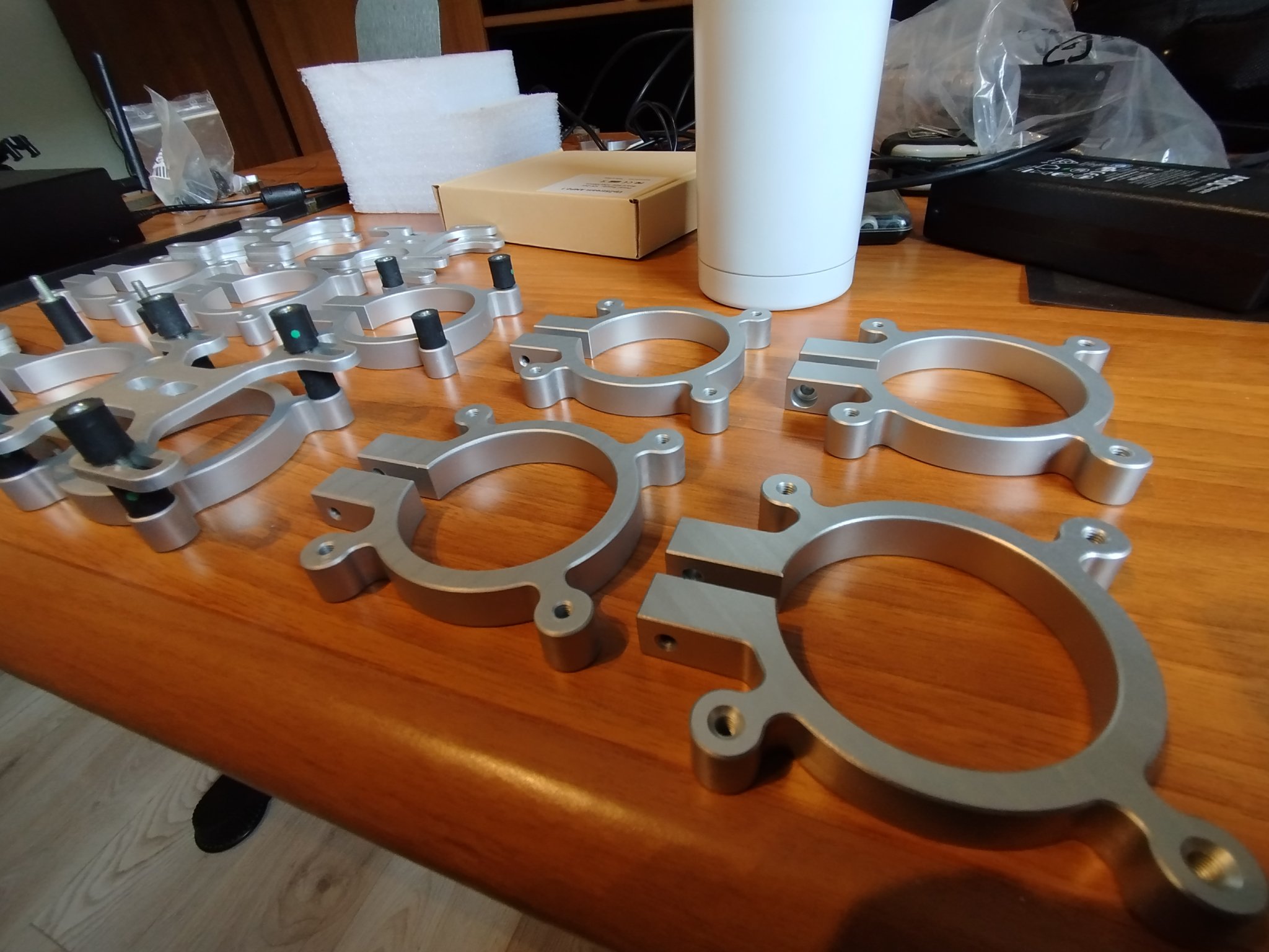

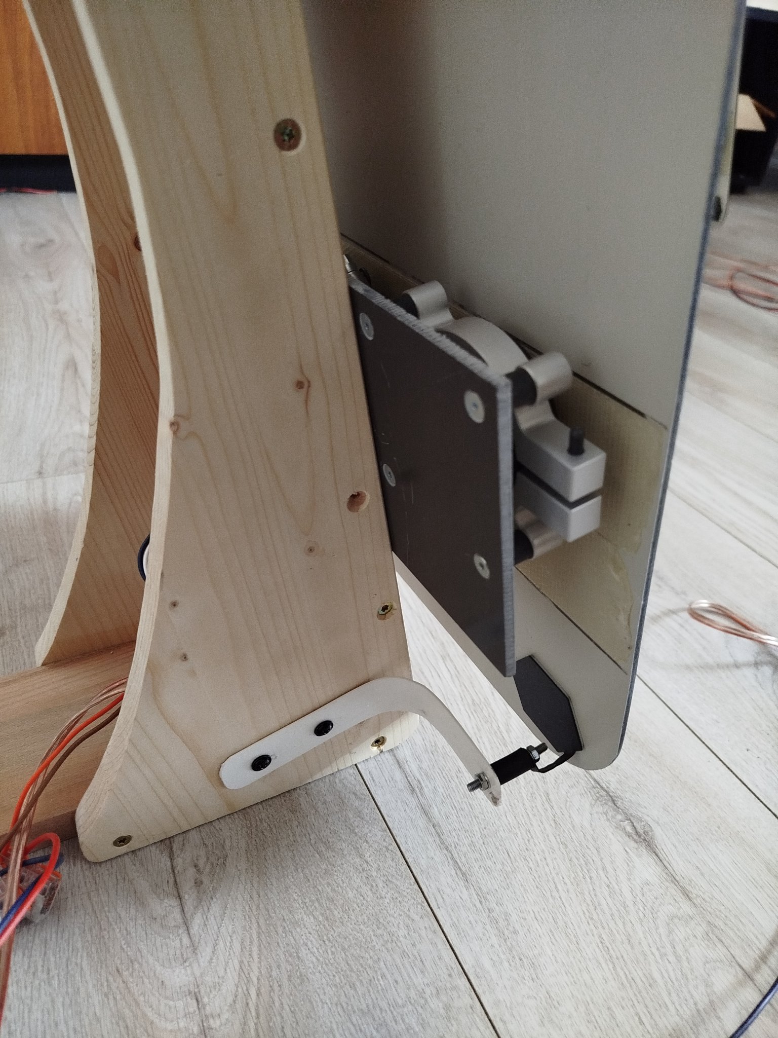

e) Actual mounting of the exciters, and suspension design is not easy to explain, so here is one picture during one of many panel removals/installations:
Initially I used original "Xciter" mounting rings for "XT32-4" exciters, but I required stronger mounts, so I designed new mounting rings and machined them from anodized aluminum,, together with various other mounts:

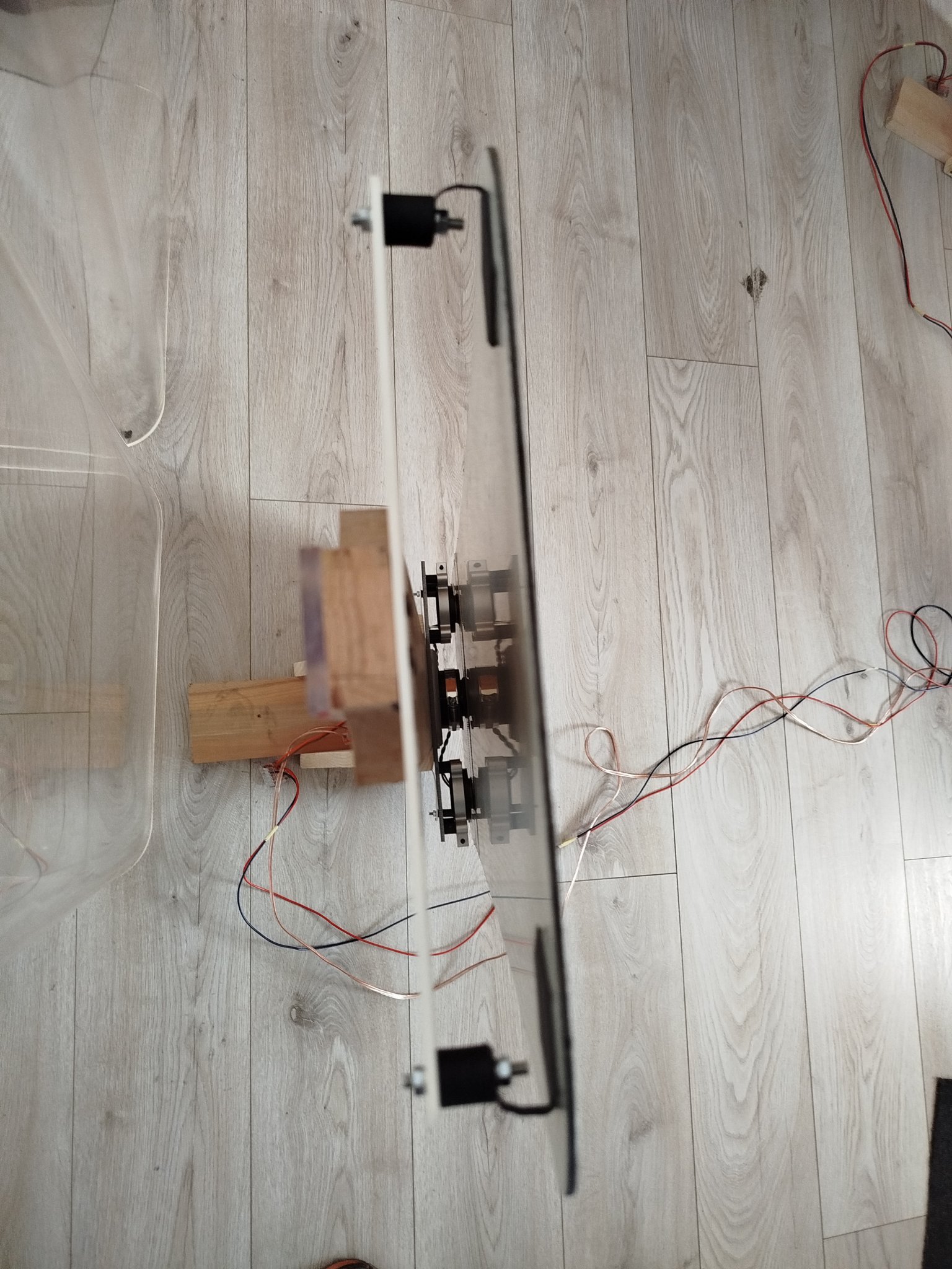

Interesting Bubba,e) Actual mounting of the exciters, and suspension design is not easy to explain, so here is one picture during one of many panel removals/installations:
But I still don't think I understand fully how your panel is supported. Is it attached at (near?) the top to those two oval pads(?), and near the bottom just to the three exciters, which are themselves attached to the frame? I see also a pair of brackets at the bottom of the frame. Do those also support the panel in some way?
Those are some seriously nice mounts for the exciters!
Eric

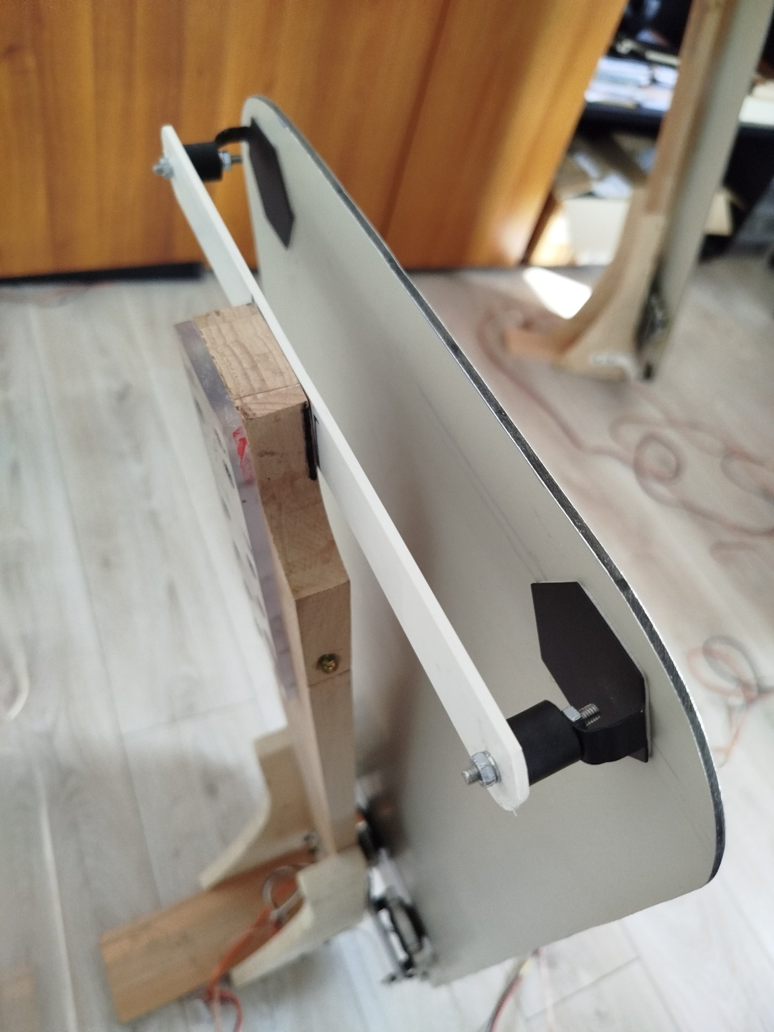

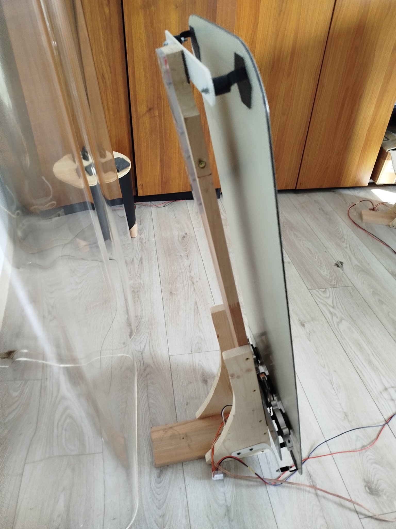

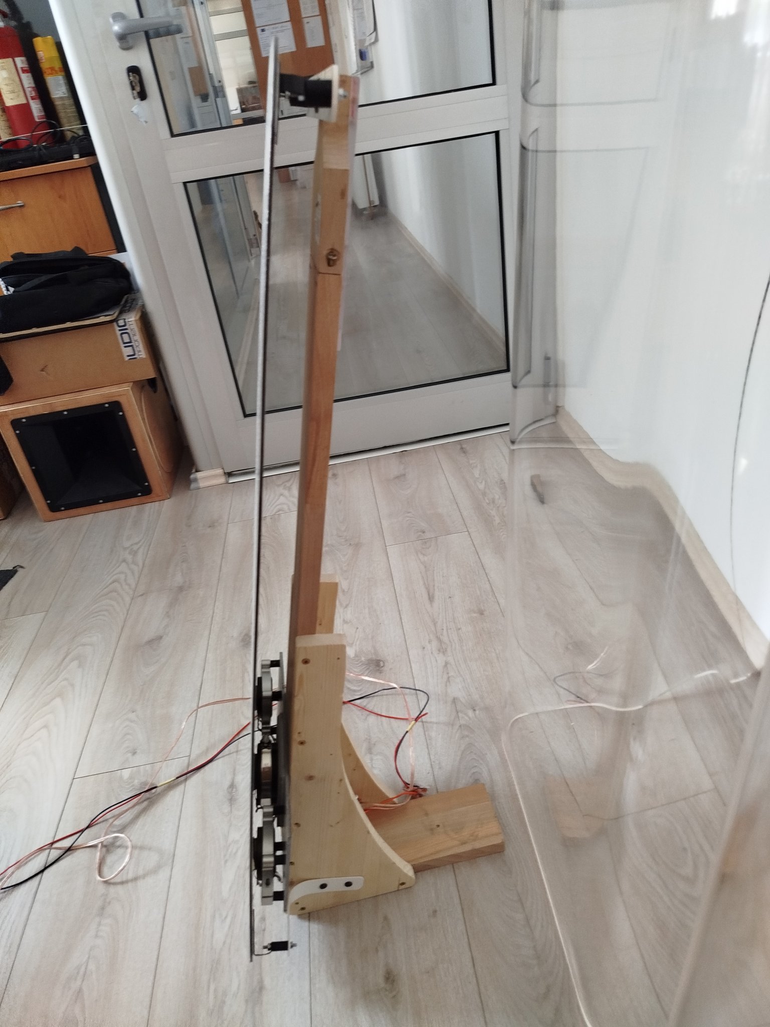

2 Veleric:
As you also know, one of the biggest issues with any DML is panel suspension.
I spent quite some time watching movement of small panel during sudden bass impacts,and it was obvious that on lowest two octaves, panel is moving almost pistonic,as each impact moves forward complete panel with sufficient force.
Now as I wanted to hide complete frame & suspension, my first idea was to hang panels with some nylon fishing line or similar,but when I checked how much stroke was required,it was obvious that this will not work.
So, I decided to make elastic hidden suspension in all four corners,but to make it difficult for me it had to fulfill couple of terms:
a) I don't want to drill through panel (no visible fasteners on front!),
b) It had to be sufficiently elastic ,but still not to sag vertically due weight of the panel,
c) It should be sufficiently light,so I am not adding lot of moving mass,
d) And it should be as quiet as possible, to avoid coloring the sound.
To cut costs to minimum, I simply then spent couple of weeks in various hardware stores,art supply stores, even toy stores,trying to find suitable materials.
After I collected impressive collection hundreds of springs,coils,rubber bands,weather strips,flat bars,hooks,etc. I experimented and choose following method:
a) I found four towel steel hooks,with 3M stickers,that can hold up to 2kg each,
b) Then I bent them,drilled them and installed four rubber anti-vibration dampers (M4 thread) ,one damper per each hook
c) Then I marked position on four corners and glue steel hooks behind the panel,
d) After that ,I cut wooden frame,and marked approx. position of upper and lower hooks,
e) To enable high stroke of the panel on top,I used thin plastic strip that I attached firmly to frame.On each end of the plastic strip,I drilled hole for M4 anti-vibration damper,
f) On bottom, I used also thin plastic strips as suspension ,but bent in "L" shape due mounting constraints.Also, I drilled hole on each strip end,
g) So now I had top elastic spring,and two lower elastic springs,with holes-I then attached panel and tightened nuts.
Shortly, after all is completed, I had following combination: panel>hook mount>anti-vibration damper>elastic strip>wooden frame.

I still didn't get a good mental picture of the suspension, even with your detailed explanation. Can you share a few pictures that might help?

Regarding my suspension details:
I fully understand ,so tomorrow I'll try to take couple of pictures from behind.

2 Veleric:
Today I took couple of pics from behind the panel - hope that this will clarify suspension mounting:
