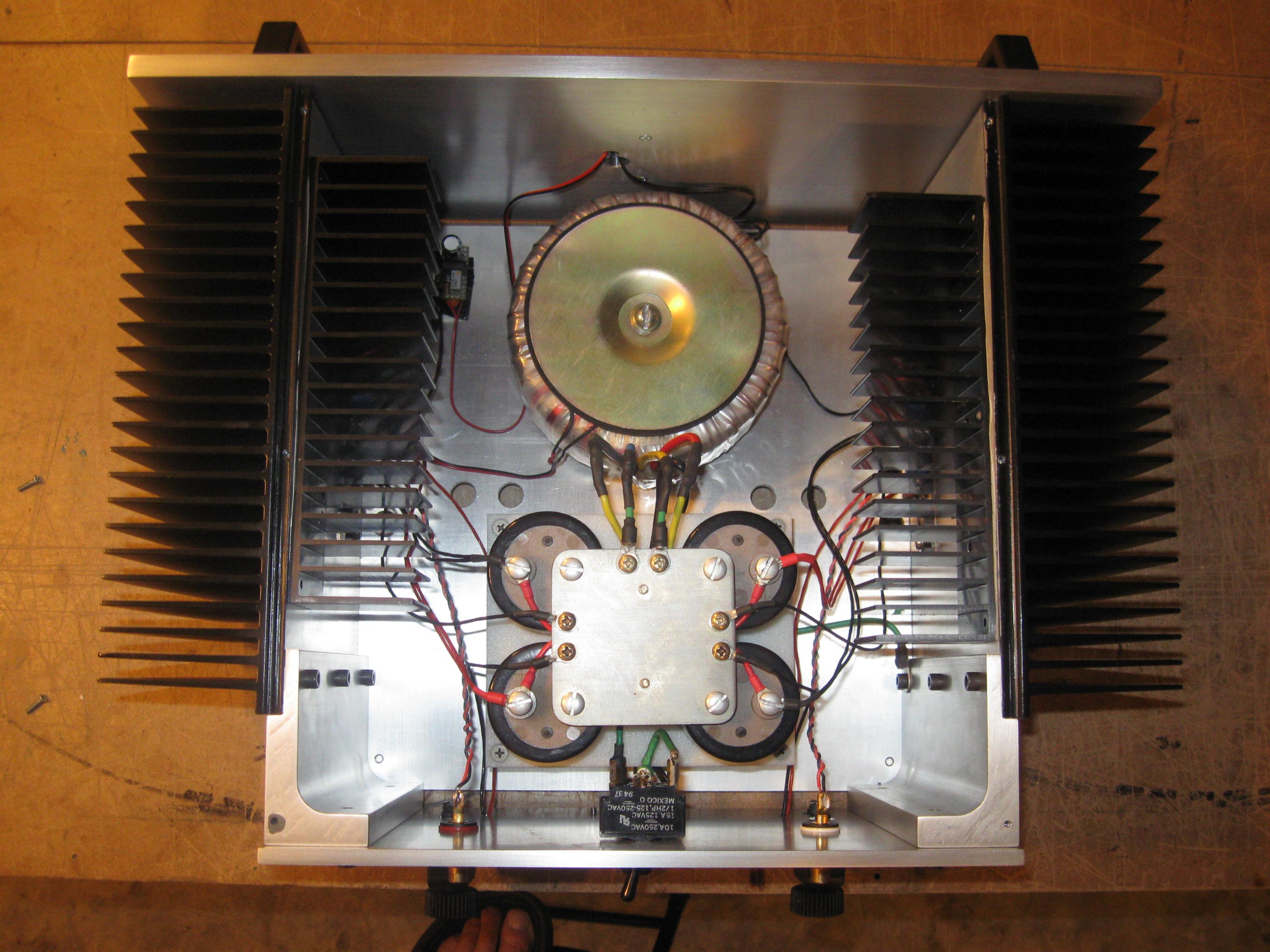

it looks pretty decent
in any case - it needs thorough checking by someone who knows his drek
I can't see NTC's besides output mosfets - are they beneath pcb's ?
I am assuming that the photos posted were taken at a time before it blew up?
If so, please take some (well-lit, in focus) photos and post them here. You will be flabbergasted by what some guys can see in a photo!!

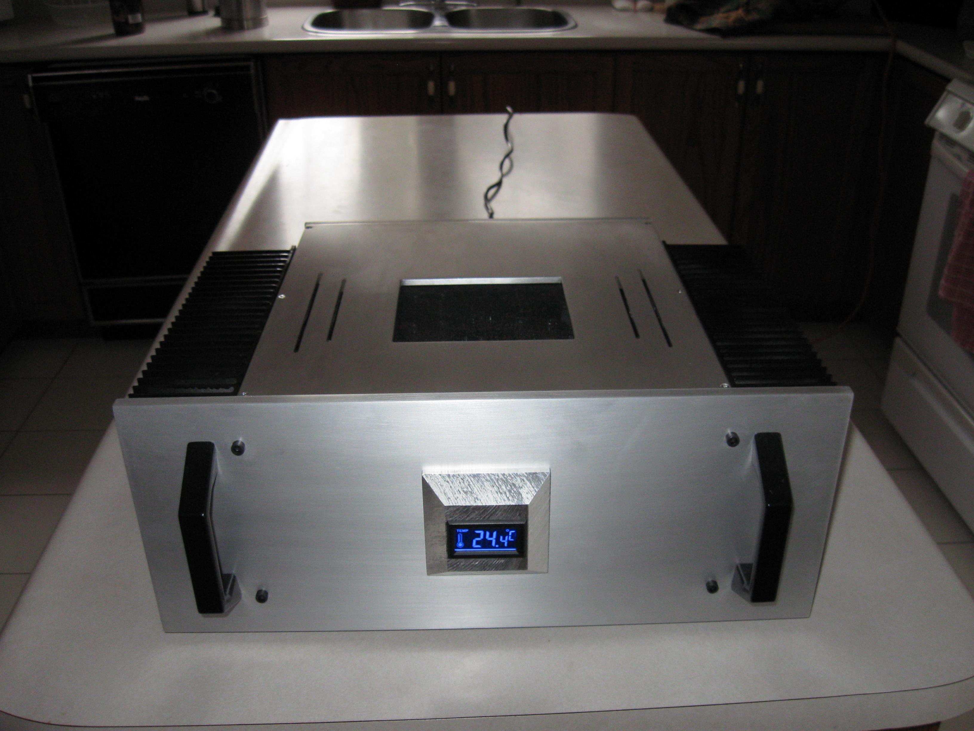

The case looks like its worth a small fortune.

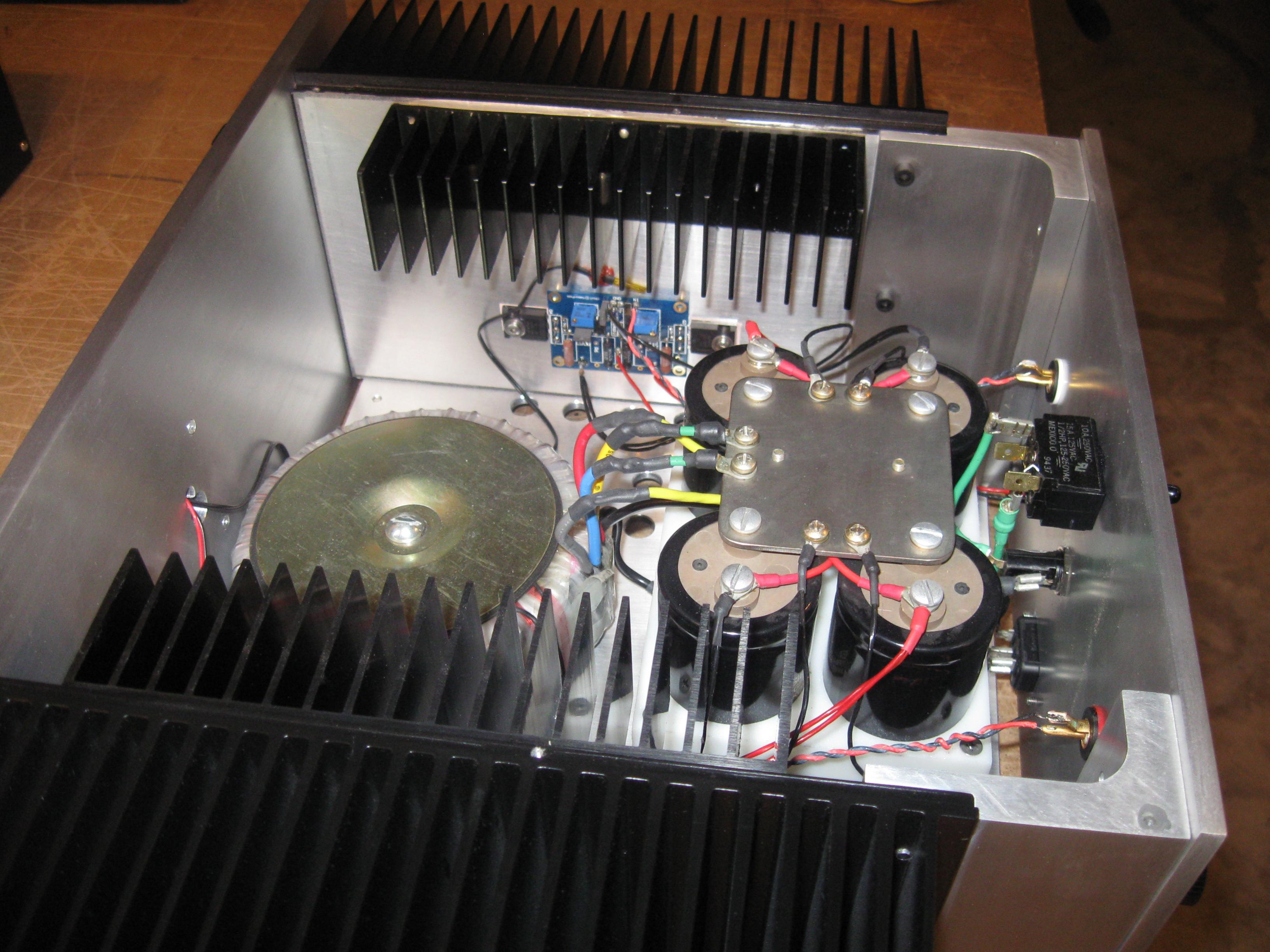

Generally speaking the amp is nicely made.
I see R6 is missing - this is a feedback resistor that is in parallel with R8.

If you zoom in fully on the second picture, there's a big brown spot on the right MOSFET to the left of the mounting screw. It could just be a camera artifact, or a blown transistor. Does the black plastic housing look brown and bubbly in the flesh?

In the center photo, whats the wire going across the left mosfet then glued (red glue) to the heat sink?
Also, the power resistors look a bit stressed, again on the left side. This could be the photo quality.
They look like mine right before they crumbled.
That is most likely the temperature probe for the thermal monitor on the front.
