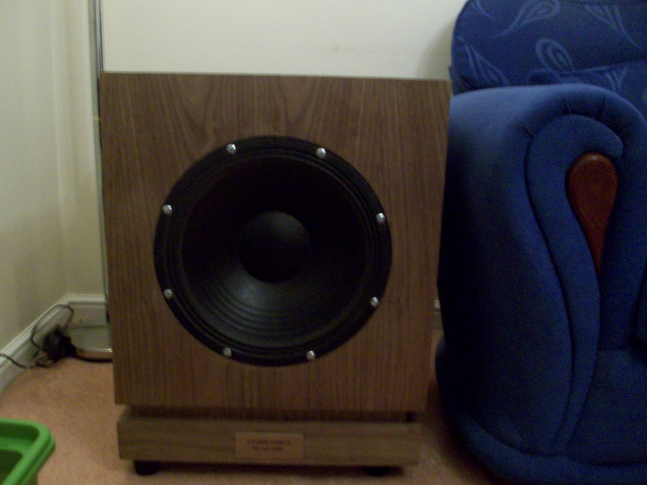

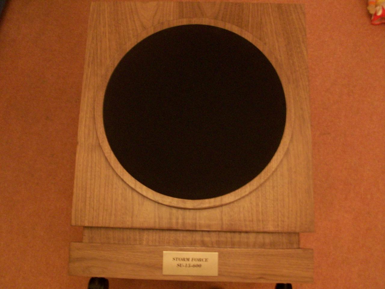

some piccys of my diy eminence sub.

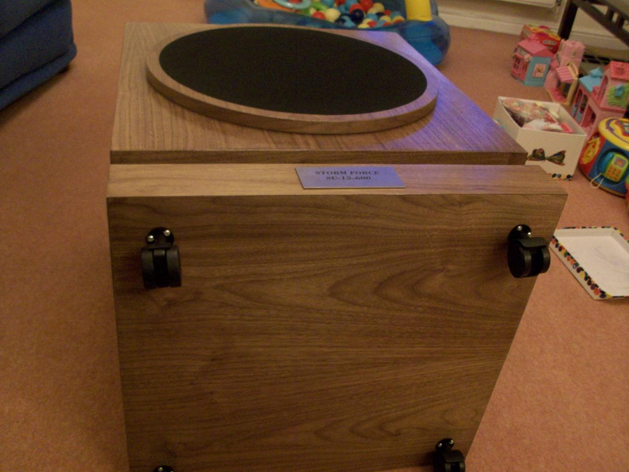

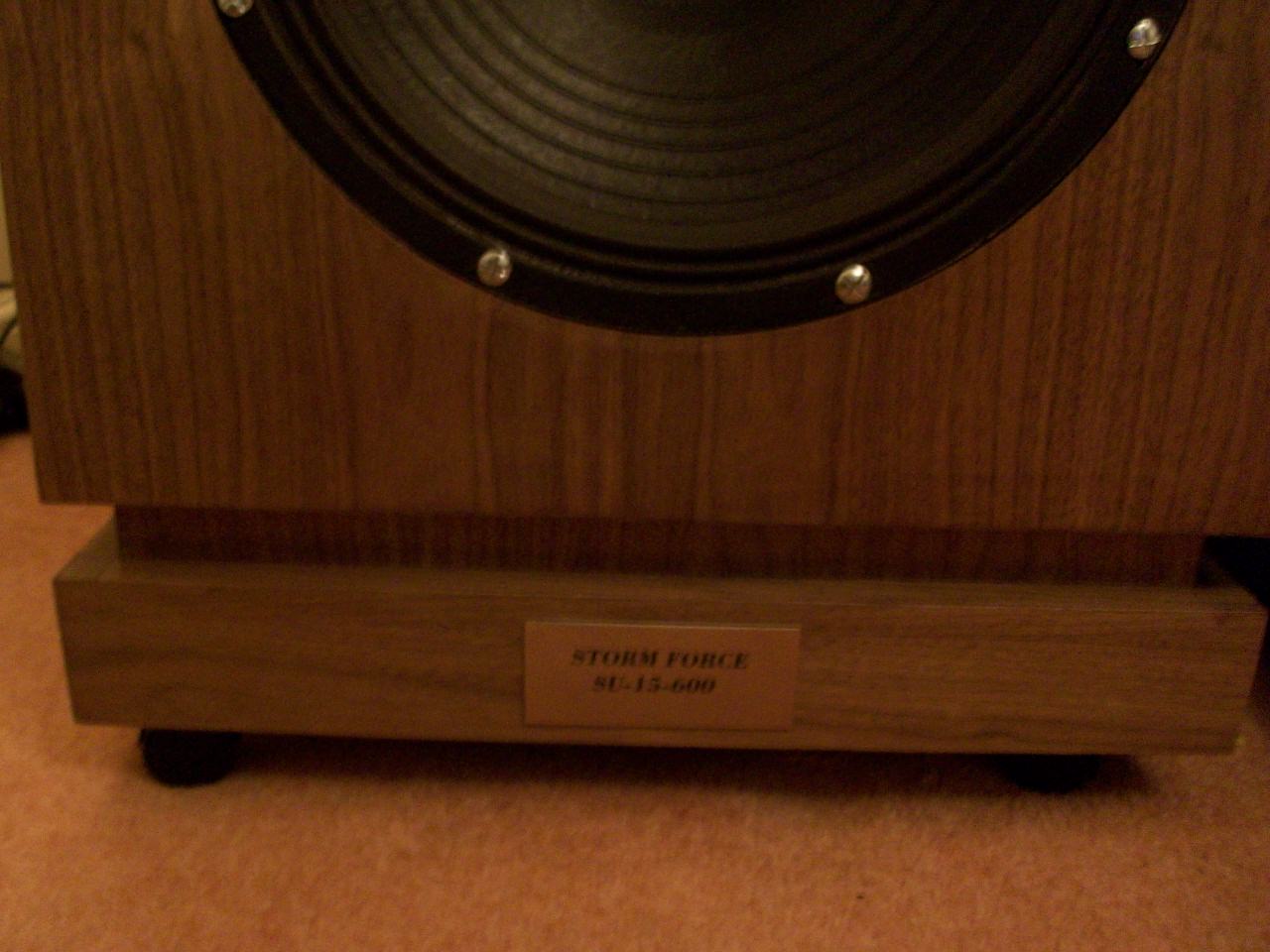

Castors just attached, this thing is heavy.

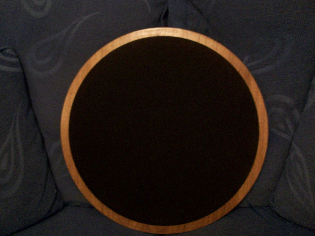

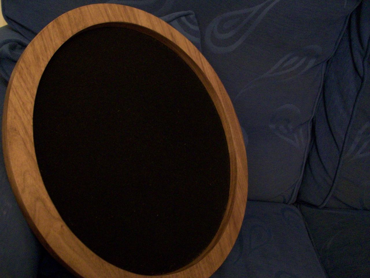

Front grille, was tricky and time consuming. I cut out two interlocking hoops of ply with the router.
The reverse side of the front grille, veneering was tricky and painful!
Pic of it stood up, was constructed out of two whole sheets of 8' x 4' 18mm MDF
I even had a stainless steel name badge laser etched and gave it it's own brand lol Storm force SU-15-600

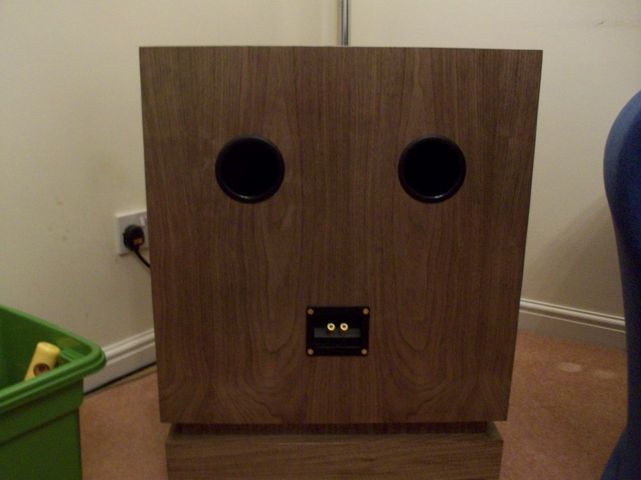

The rear!

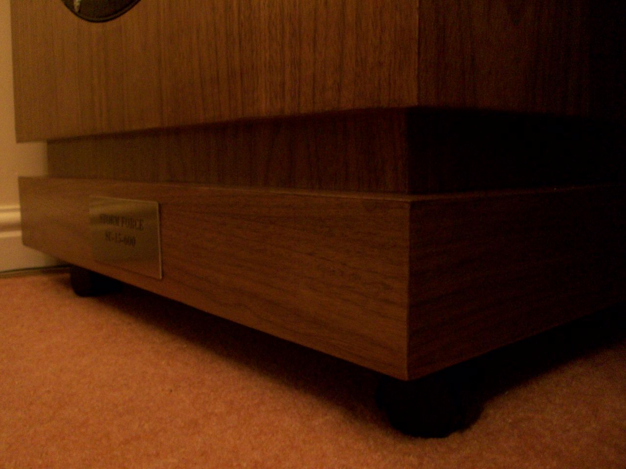

Shot of the redicilous base made from 6 sheets of 18mm mdf.
I'm trying to recover the construction photos from my camera, been playing me up.
Total weight is 88KG and tuned to 30Hz. Enclosure volume is 108 litres.
Veneer is raw north American black wallnut Finished with diamond hard poly varnish.
Size: 27" H, 22" W, 21" D
The rear!

Powered by a dedicated crown I-T8000 amp with brehinger active x - over
Sounds clean and awsome. What I dont get though is in the params for this driver, Xmax is down as 4.8mm. I'm telling you now, I've had this thing flexing to AT LEAST 20mm with no audiable distortion (to my ear anyway) nor any bottoming out. I shoved one of those car bass cd's up it yesterday, Techmaster PEB's "It came from outer bass" and the last track has a powerful 14 Hz bassline. The cone went crazy without any bottoming out or farting sounds. This thing can almost levitate a carpet!
