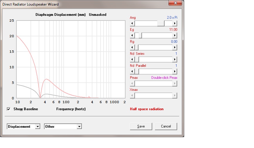

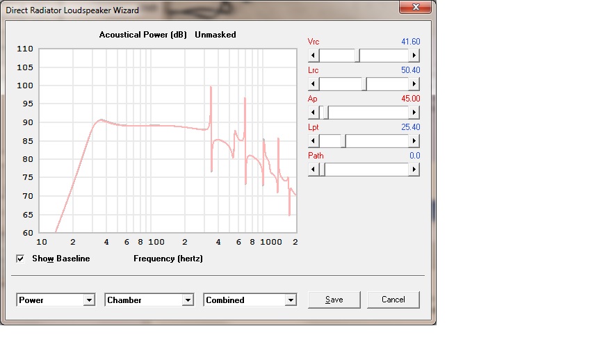

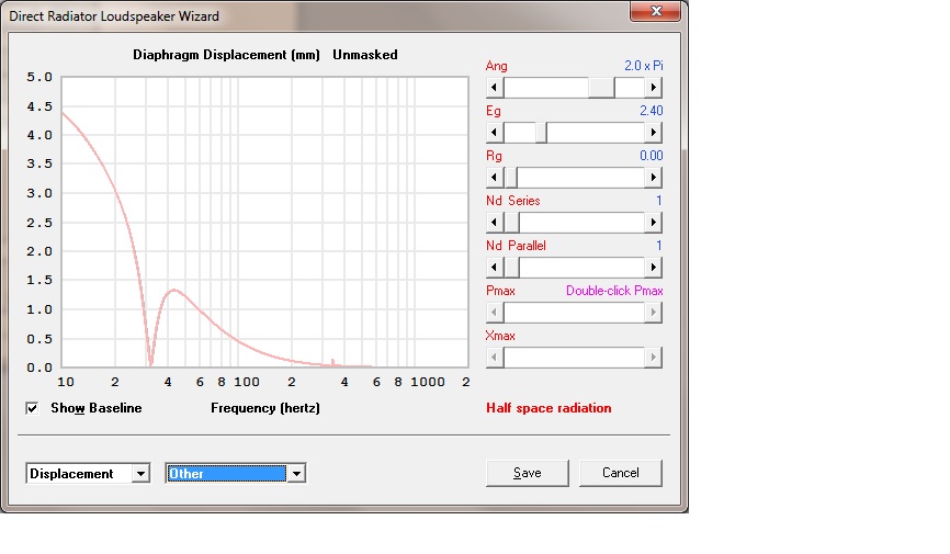

These graphs are from HornResp and should be comparable to the program you used. The issue I'm interested in, is the low freq <20Hz where the displacement is excessive, even for low power. Do you see this? movement more than the Xmax=6mm ? like its flopping back and forth at low frequency?

Partially answered my own question in the PartExpress Q&A for the plate amp. There is a subsonic filter @18Hz, but it might be too low for this arrangement, allowing excess movement up to 30Hz with very little power.
"Is there a subsonic filter? What is it set at?
FD001 on Apr 24, 2011 BEST ANSWER: Yes, this amplifier does have a subsonic filter at 18Hz."
I attached another graph predicting the power when Xmax is reached. If we assume there is no music content below 30Hz, you can see Xmax=6mm at 45Hz using 35W. I'm struggling with a similar issue, that's why it caught my attention.

The cone travel (ie. displacement) depends on box design, driver, frequency, and power. A kick drum or even kettle drum or old church organ can generate the very low freq I'm referring to. Have a look at the displacement graph in post #3 for your design @35W power. At 40Hz the cone is moving 6mm, which is your Xmax. At 20Hz the cone is trying to move 12mm which will certainly bottom it out. In fact depending on the frequency you can bottom out with alot less power than 35w. I'm wondering if that is happening? It certainly sounds like it is.
