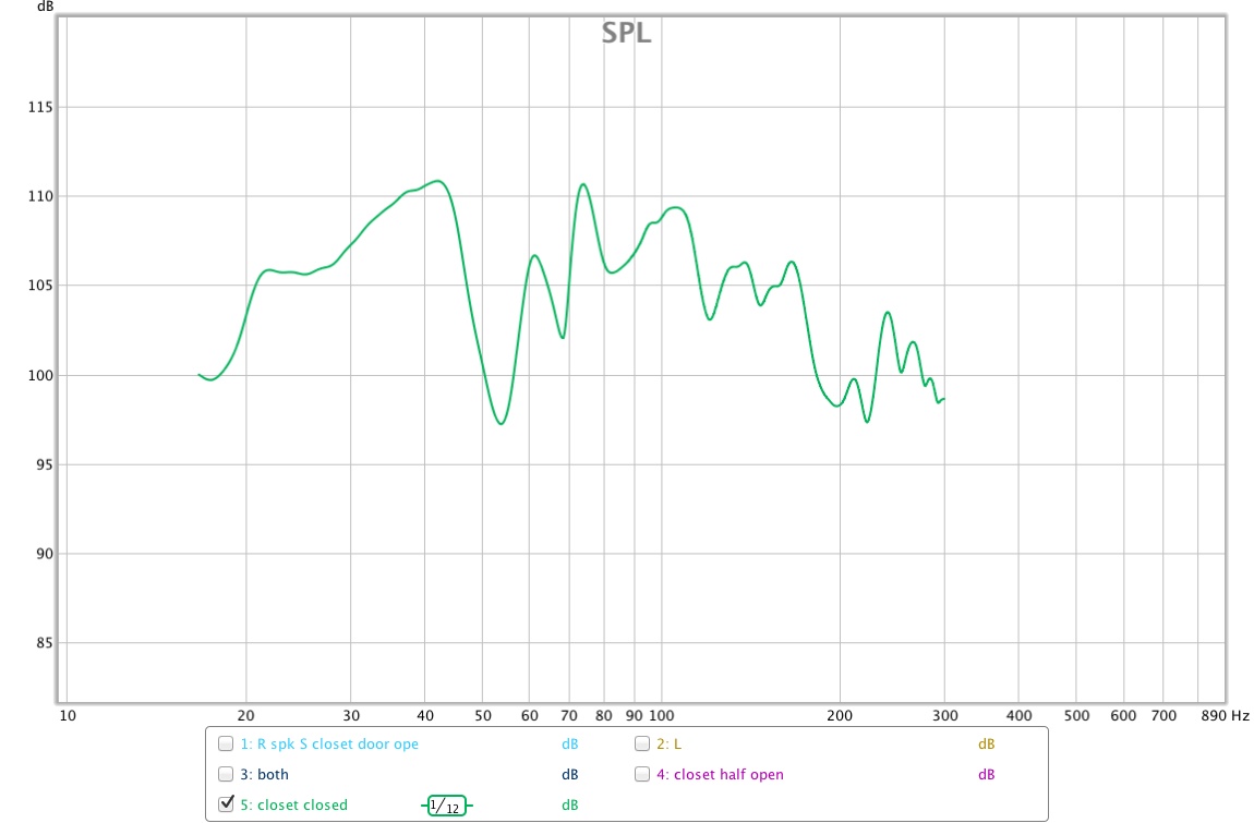

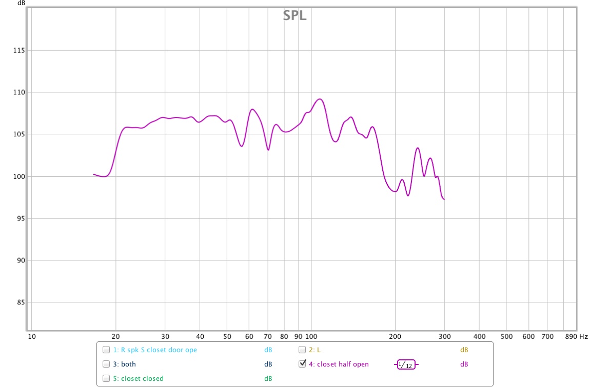

My music room is 9.3 x 15.6 x 8.2 feet. At one small end are the speakers and the far wall is mostly a clothes closet with sliding doors that, of course, slide open half-way.

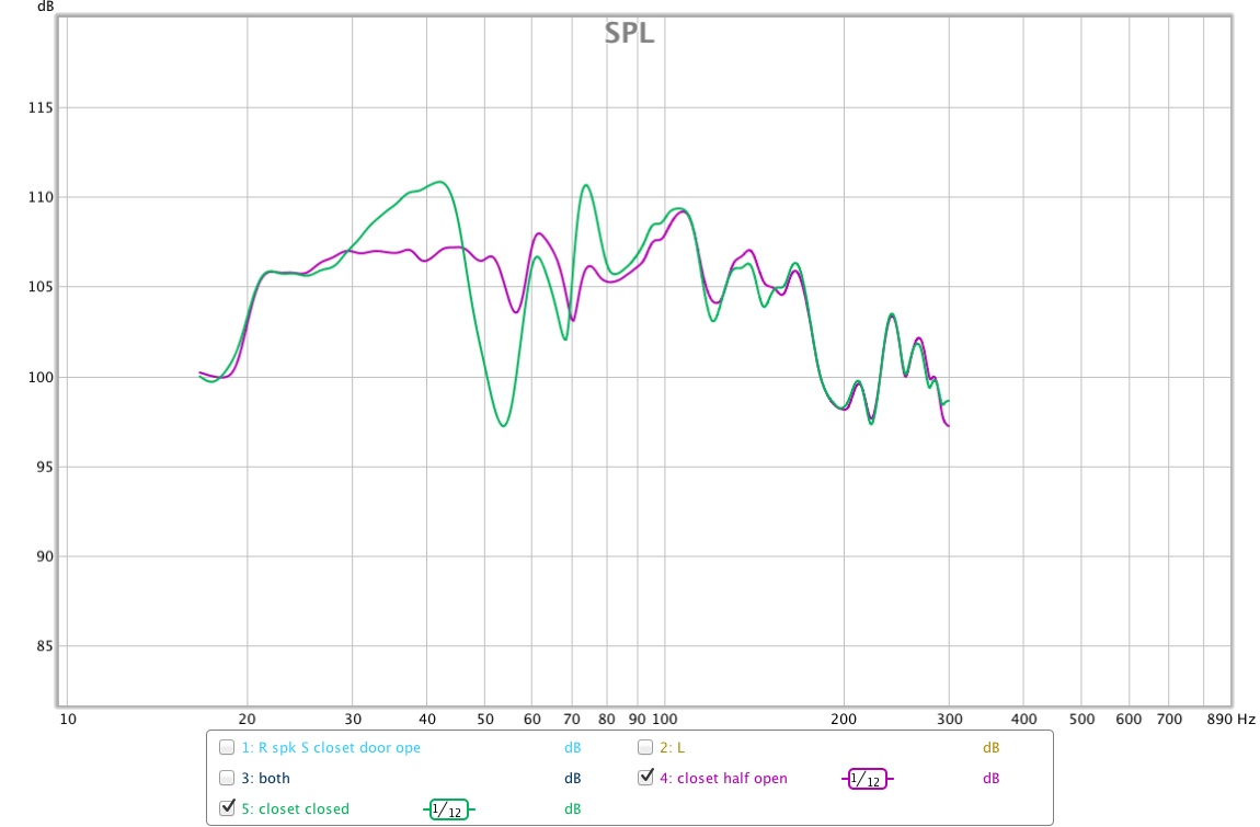

With one of the doors slid over (to the cover the other door, of course), I get a bass response with my 1955 AR-1 that's within 2-3 dB from 20 to 175 Hz (bars 5 dB apart, not calibrated). With the closet closed, within 7-8 dB and looks awful, at least on paper.

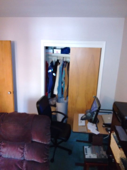

See picture. This time of year, mostly my heavy winter motorcycle gear.
Sorry for poor picture. Door opening is about 22 inches.
I sure was surprised at the size of the effect. FR goes from pretty poor to pretty darn good by just sliding the door**. It is on the room centre-line and the mic is at my chair (also centre-line). BTW, I couldn't say if the change is compensating for weaknesses of the speaker or undoing harm from the room or both.

**doing the other door does not make things much better

I think the closet with the open door is absorbing a major eigentone (and harmonic of it) by accidentally being located in a major hot-spot and presenting a stuffed closet instead of a flat wood door. No mystery. On the other hand, no less significant in creating a good HiFi because it is not mysterious.
