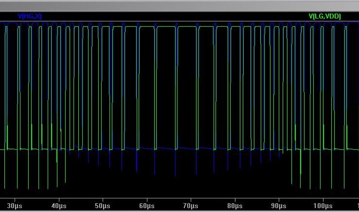

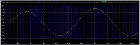

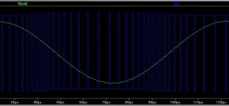

During I redesign the UcD DIY I found that the my new design is good also for prefilter feedback. Actually I use two feedback prefilter for positive feedback oscillation and post filter to control gain.
But this time I just works on simulation. But the result from simulation seems good.

I'm no pro when it comes to feedback networks but usually when you have a mix of pre-post you end up with a load dependant amp that requires a zobel network. How does yours fair in this regard?

I just remove the feedback from post filter output. The gain control is done by control the voltage feedback signal from prefilter itself. Simply, if the feedback is higher than the gain is lower vice versa. So no matter for the gain control.
Simpler feedback loop than post filter indeed.
