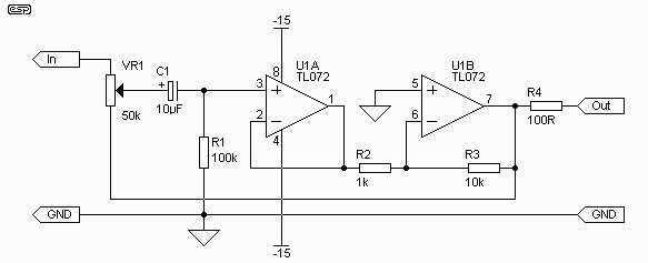

Can I implement active volume control after the circuit given above shown in the following link?
http://sound.westhost.com/project01.htm
Thanks for all the infomation. I have built with separate opamps for each channel for better seapration. I am going to add following circuit from ESP projects after the above preamp circuit. Will it give some problems?
I would love to have links regarding proper earth(ground) techniques and proper routing techniques for building circuits.

TL07xx is the 'low noise' version of the TL08xx version. Though 18nv is not low noise by any means.
The OPA4132/4227 should be a good bet for you if you want to absolutely stick with DIP, though they are more expensive than the 4134.
NE5532/4 only has a single and a dual, no quad. Your options for high performance opamps become very limited when it comes to quads, as the quad design is optimised for cost. It is possible to hack a couple of duals into a circuit which had a quad, but likely the performance of the original itself did not merit anything better than the cheapest quad.
The LM349 is the worst possible choice for the application, it's not even a proper audio opamp. TL074 was pretty common in solid state pro gear but was one of the products that gave SS its terrible reputation (which it's still trying to shake off!). I have few in my junk box, and that's where they'll stay. If you look at Samuel Groner's article on opamp distortion, that 'wave bender' looks an absolute disaster for anything but the lowest resolution systems.
For tone controls, search for Baxandall tone control circuits on Google, even Rod Elliot has a pretty long page about them, tell you everything you need to know. I don't use them at all, except in my guitar amp. Most of the time, speaker tonality issues are caused by poor design or placement issues (mostly the latter), which tone controls cannot reliably fix.
Anyway, it's a pretty standard kind of circuit now. The Douglas Self tone control looks very interesting and different, but terribly complex to build. I would rather not try it, but if you want, it's in his book 'Self on Audio', Available on Google Reader.

you need high impedance after every filter.
This virtually demands a FET input stage after the filter elements.
Don't use a 5534 as the opamp in an active filter.
The tl07x is noisy and very intolerant of capacitive load on it's output.
Use a better behaved FET opamp for the filters.
The 5534 can still be used as the input and output buffers. Although again some more modern devices can do the job a little better at much higher cost.
