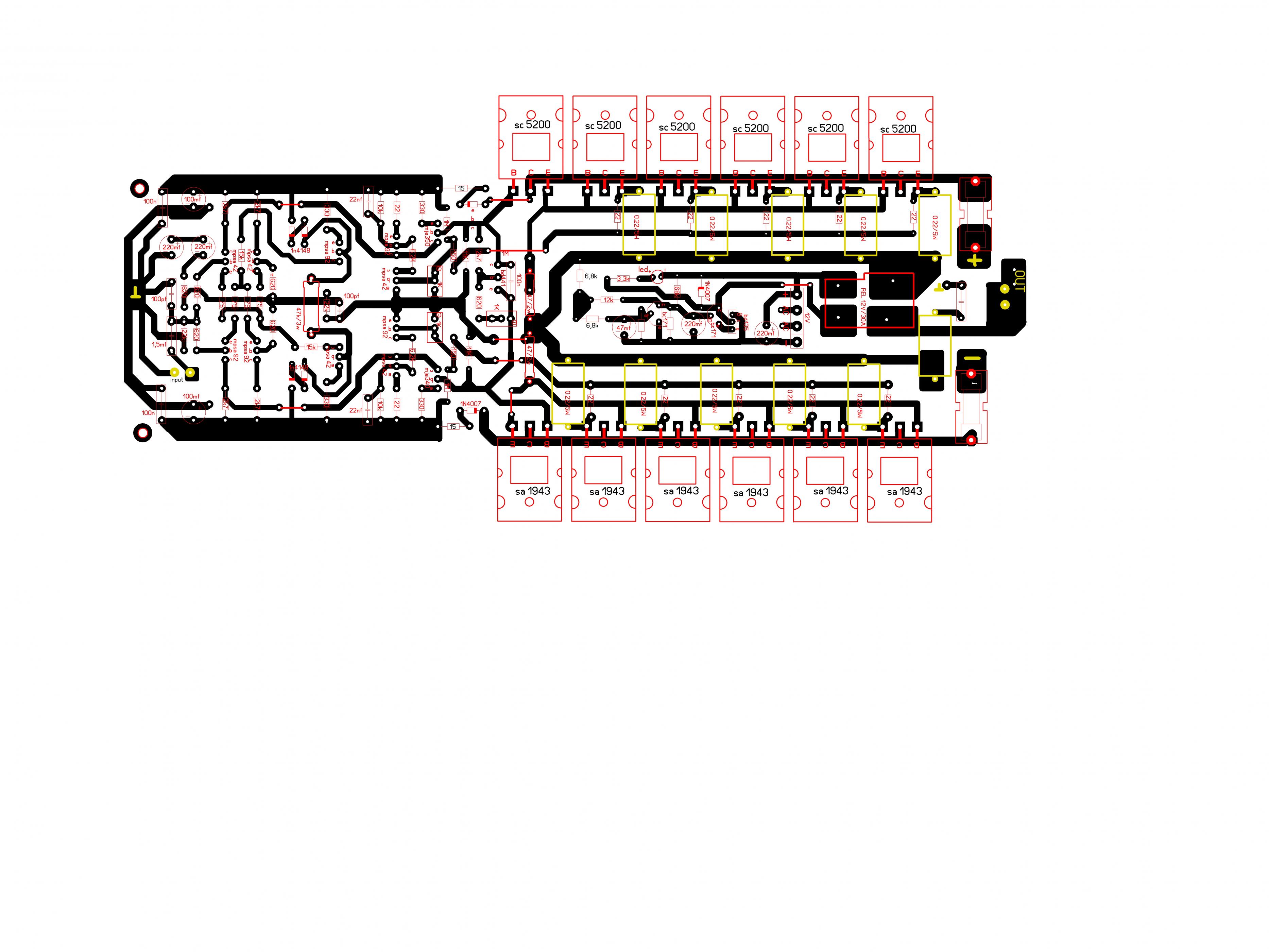

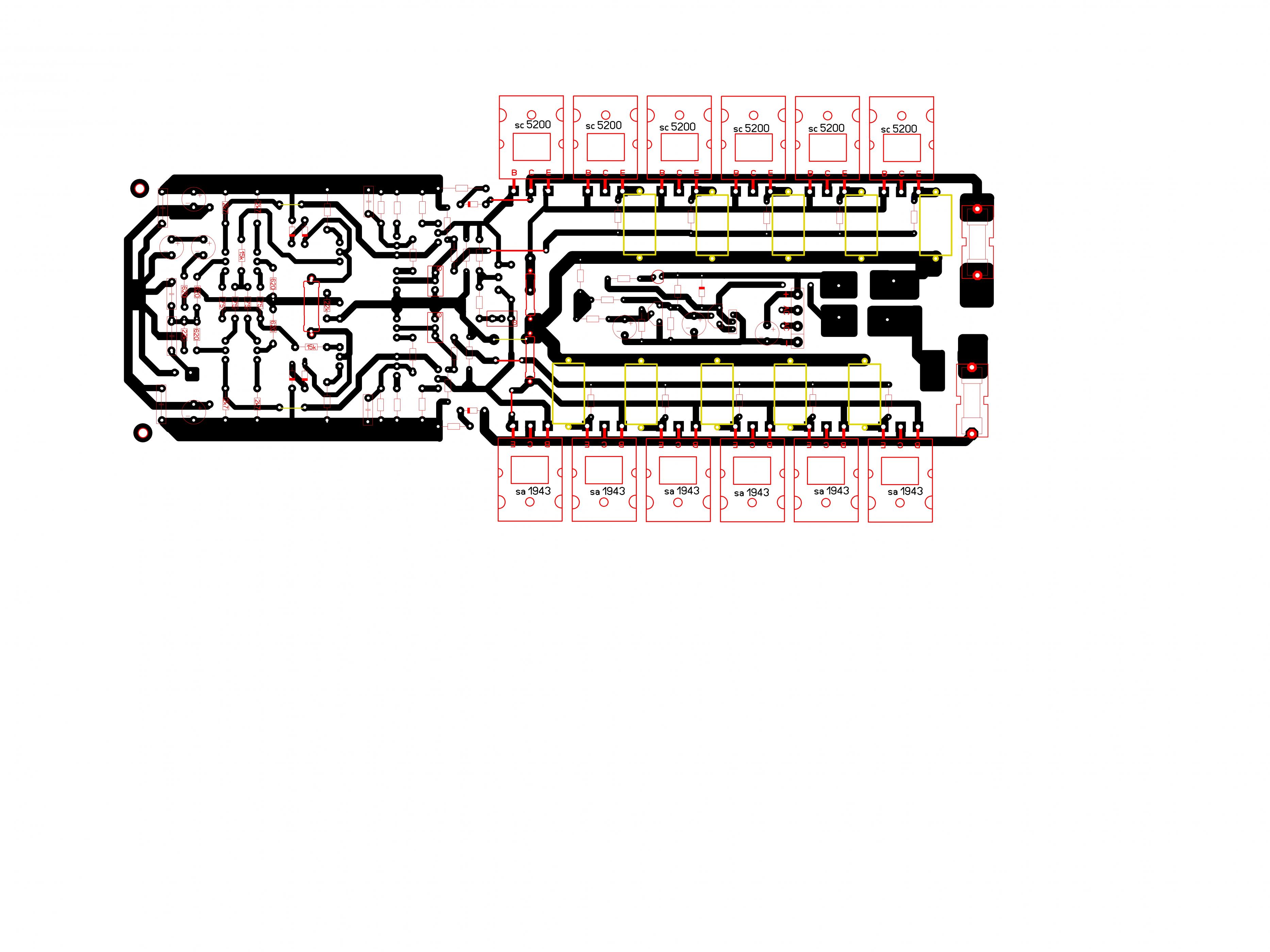

this is my 900w/4 power amplifiers sound is very good TinyPic - Free Image Hosting, Photo Sharing & Video Hosting and dc protection for loundspeaker

This is a nice looking design. I do question if the power and speaker line traces are adequate to handle the 900W/4 ohm load. Check out the pcb trace calculator at UltraCAD Design, Inc Homepage to verify your design. E

Interresting.The traces between the collectors of the output transistors seem a bit narrow.I'm missing a connection ,the minus off the HP-protection to the cental-ground.
