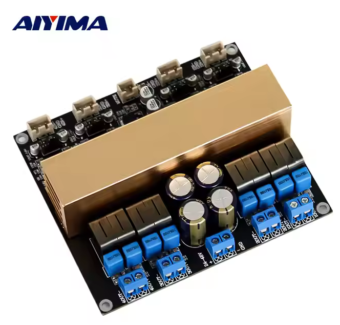

Amps are 4 4way tpa3255 modules - these ones:
They work great, have balanced / se inputs, plenty of power, great specs and price.
