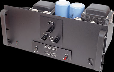

so basically, add about 4k in resistors, replace the 10 6l6 tubes with 10 kt-90's and your 250 watt amp is a 500 watt amp. list price for the 250 watt version is 7k/pr, list price for the 500 watt version is 9k/pr.
so I have a pair of Manley 250 watt amps. 10 6l6's. 250 watts each.
Until we see measurements most people here will suspect that both the 250W and 500W figures are bogus.
Put the amp on a dummy load and get a signal generaor and measure the output at several different frequencies.
A 500W output transformer is going to have to be full-on huge if it is to work well at low frequency. What you may find is that your 500W amp has limited low end
I find it hard to believe that the OPT's are the same. It has been my experience that stuffing bigger tubes into an amp will not increase the power output of an amp. It will increase the potential for greater power output. To tap that potential you need to raise the B+ voltage, lower the load impedance, or both.

definitely all parts are identical. same part numbers on the schematic. don't forget that in the music industry tube usage is often driven more by expectations of tone than anything else. not going to debate claims by the manufacture for their various models. I'm simply explaining what I found after being curious of what it would take to make model 250 be model 500.

10 off KT90 is a complete overkill. What I see in front of my eyes on the bench is what counts.
Output Voltage squared/ out load resistance and we are looking at continuous rated figures. I don't believe otherwise.
From my notes; 575V B+ with parallel p-p KT90's (4 tubes) in 43% UL just nips 200W o/p on secondary with 2K A-A.
Looking at the GEC KT88 400W amp which used 8 tubes; (I know it's a poor amp) but it is well known that KT90's can produce 20% more output power so, 10 off, in lieu of 6L6's in the the output stage apart from mis-matching is well out and wasted as is the heater currrent demand.

I realise this is an old thread but... the transformer will be big but not quite as big as you imagine...
....as the amount of iron in the transformer required for decent low end drops massively with the primary impedance and turns ratio. 10 KT90s would runa round 400Ohms Raa, the tranny will still be "well big" and may still need a car jack to move it, but not unrealistically big.
yes...I think the surprising theing about all this was that all the parts were these same in both models minus the differences in power supply and bias circuts.
Two models for the development, and materials cost of one, plus the lower inventory cost of all those shared parts.
Makes sense to me, the incremental cost reduction in sourcing a smaller output transformer would probably be canceled by the cost of carrying an additional large, expensive part in inventory.
