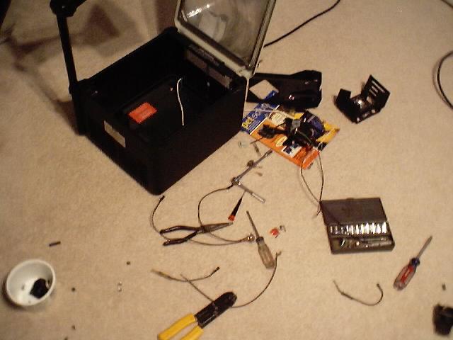

OK So I ordered the HQI setup today and hopefully it will be here within the week. So I started to take apart My portascribe g-100, Not great But It will do for now. However I didnt take any before riping apart pics( Got started and Just forgot bout ya guys) anyway Here is The progress so far, Removal of everything Including the origoanl fan( not intentional bUt it was such a rats nest It was easier this way) I have a pic of everything taken apart see below, In the upper right corner you can see the cage with the spherical reflector in it had to do some hacking on that so a HQI could fit. Anyone know why the reflector set atop a platform that could mive up and down? Wierd I think I will omitt that part in the final desighn.

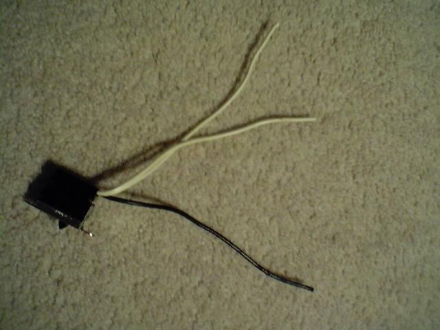

Ok here is a Pic of the origoan switch Im not going to reuse it tho because Look at it It only has 2 common and 1 hot wire, I dont even know how it worked in the old setup( NOTE there looks to be 4 wires, thats shadows) So Im gonna go to Lowes and get a new switch.

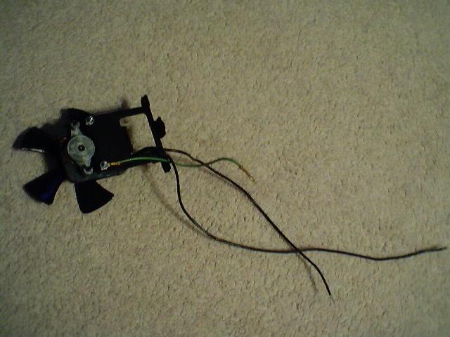

and finally the origonal fan, It was working But Again the wires what one is Hot and what one is common? MORAL of the story take lots of before pics if for nothing else your own belefit.
This will be the last update till I get the HQI setup I think for now I will just use double stick tape( on the endcaps) to attach it to the projector so if I do get another one to retrofit It will be easy to fix. anyone have any comments on the switch or the fan?

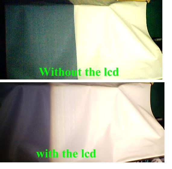

Ok here is the comparison pic, I just did it with the lcd on and off nothing on the screen. Its rather dissapointing the brighter one is the fxl in both pics, on a different note I did place a thermometer in the 410 fxl and it reached 140 degrees F within 1.5 min so that was the max amount it( the therm) would go so yes fxl is hotttttttttttttttttttttt danggggggggggggg hotttttttttttttttttt. anyway I will keep tinkering and see what happens.

i dont think our results are the same VF mine isnt as dark as it seems it brighter than the FXL pic u took but its slightly darker then my DYS not a difference most ppl can even notice or even think about.overall im happy 😀
