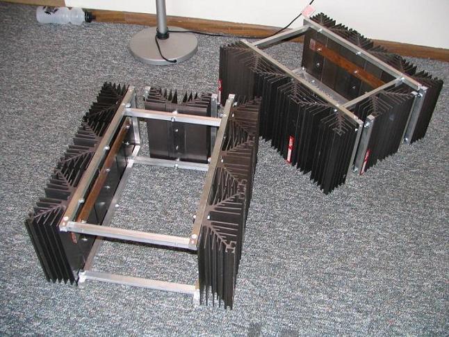

I have pictured below my first project. I've not yet finished the panels obviously. I'm saving them for last because I've never worked with metal before. What you see was used on the maiden voyage of a recently purchased small craftsman tablesaw and bench top drill press. I hope to be able to make a 200watt Aleph-X with these heatsinks. They are 3x7x9 and have a thermal resistace of 0.47 °C/W. The overall case saize is 9 tall x 18 wide and 21 long. They are allready heavy, I can't wait to finish them. My plan is +/-22v rails and 12amps of bias. This will give me the 200 watts @ 4 ohms I'm looking for. My next purchase will be tranformers. I currently have 14 caps, 40v 34,000uf, and 16 resistors, .5ohm 50w dale. I am planning on a CRCRC.

It all looks pretty good. Your numbers make sense and the
sinking will be about adequate - if not, then blow a little air
across them. I use Plitron, but have heard good things about
Victoria magnetics. I think the 1.2 KVA will be fine.
So good luck, matey.

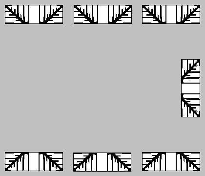

I never expected the first response to be from, "the one and only." I just wanted to add my that my top and bottom plates will be partially covering the heatsinks. I have decided the top plate will be the full 18x21 but with holes cut in it 1/2" in at all sides of each sink. This makes the holes 2x6. This may be unclear, but the attached image explains my design. The top and bottom plate will be identical. I know it's not the most unique design out there, but I wanted to do ?!something!? different.
