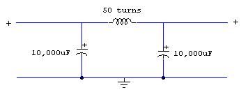

2- ive built this simple diagram consisting of 2x 10,000uF caps.
and one inductor (50turns of thin insulated wire around a steel
bolt) and its also eleminated the noise completelY, as u mentiond
before (Doide)..thanks so much,, but the most imp. part is why?
this circuit IMHO works to purify the pulsating DC (due to noise)
to make the output more linear DC, am i right?? or i mess something?...
anyway, am really thankful for ur help all!!

Great work! I'm glad to hear it because I have had many problems in the past also. No one ever told me to star ground everything! I just had to bruit force it with heavy noise filters. As the filter goes, you are simply smoothing the ripple like after an AC bridge rectifier, just at a different frequency, that's all.
Anyway, Thanks for telling us about your success and what you did....
