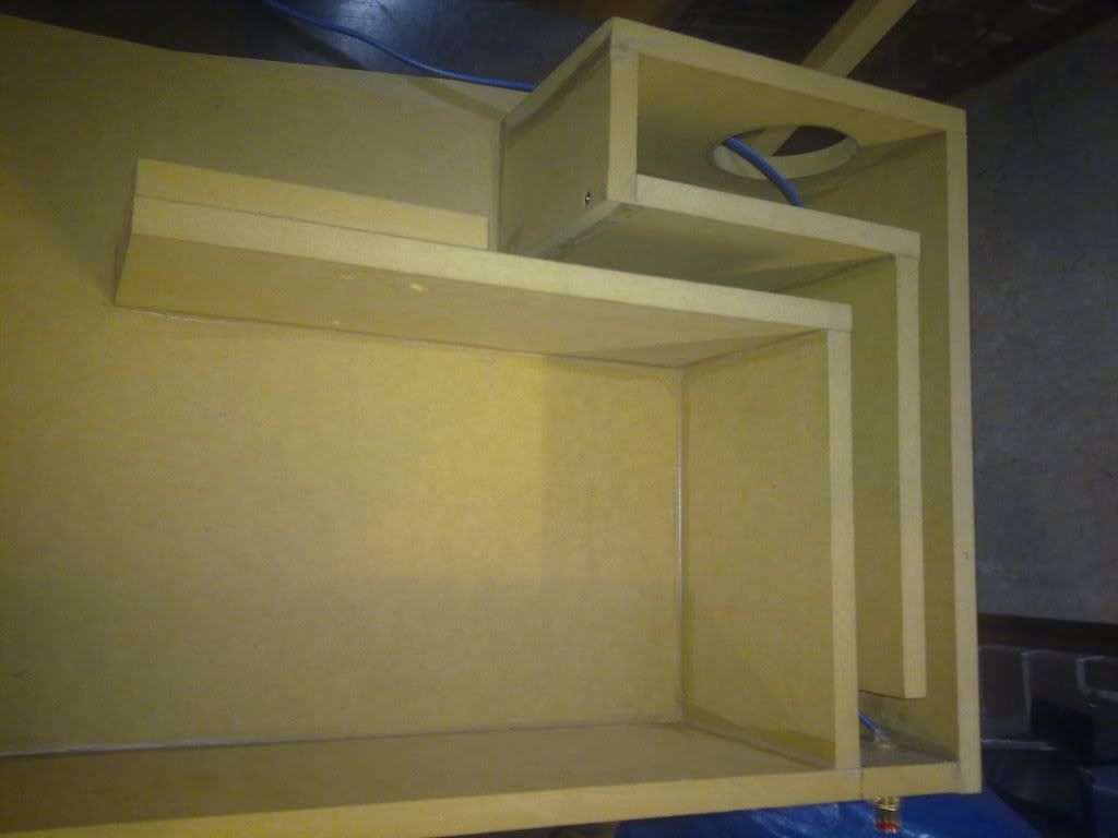

Hey I'm new to this forum and new to the speaker building scene.
I've really only designed 2 pairs of speakers, a open baffle mid speaker and standard 2 way main speakers, so really not that much experience in building. I have however modify alot of speakers, not that they sounded that good.
I have a bit of knowledge as I work for a electronic company and have worked in various hifi stores here in Aus.
I built a Pro series 3 poweramp from Jaycar a few years ago and wanted a decent pair of speakers to suit.
So I went looking on the net and found Fostex full range drivers.
Going on price I really didnt want to spend anymore than Aus$300.
So I ended up with the 4"103E.
I didnt know what I was going to do for a box until the speakers turned up, they had a slip included in the box with a loaded horn design. It looked like a challenge, so I started it.
Aus$90 for the cuts and 16mm MDF and $120 for the speakers.
Here is the pics of my build process.
I dont have a finish on the box yet, it will be vaneered with redgum.
Please tell me what you think.

These should be very enjoyable.
In case no one else says this, go easy on the stuffing or begin with a minimal amount.
Your basket treatment is interesting. It looks less messy than using
putty on the legs. However I can't see the seam. How was the foam cut and held in place.?

Putty on the basket legs and foam padding serve two very different purposes. The putty mass loads the legs thereby damping internal resonances. The foam blanket absorbs reflections bouncing around in the cabinet. My personal opinion is that 1/4-1/2" of putty is not going to do much, if indeed resonances in the legs is a problem to begin with. Also, if you put a reasonable amount of stuffing behind the driver, there is little in the way of reflections left to absorb at the driver.
Your treatment looks nice and I'm sure it does no harm, but it appears to be a solution in search of a problem.

Thanks for your comments.
The Putty I'm using is a speaker sealant from Jaycar, Ive used that in between the magnet and case. The foam I'm using is a honeycomb material sound absorbent mat, it has self adhesive backing.
I used as its easy to work with.

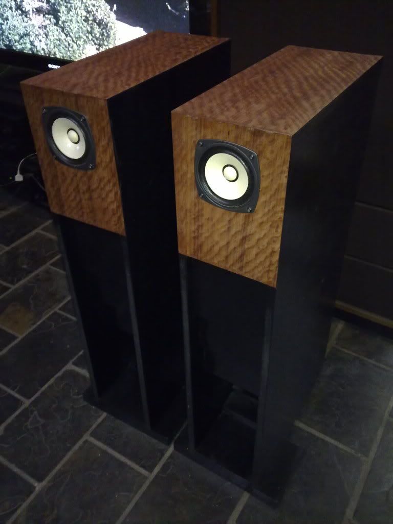

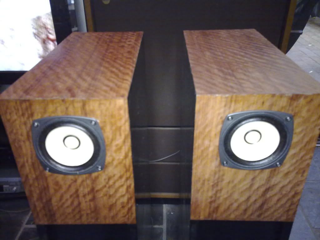

Hey Clark,
Thanks for your input, I have got the speakers finished now.
I gave these to a freind who has alot of experiance with speakers.
He ditched the filter I made and went back to the box, playing with dampening.
He got me to listen to them for hours while he played around with dampening.
They sound exactly how I want them, no more pitchy voice.
My conclusion is they sound great on classical, blues, jazz and slow rock.
House, dance, techno, rock, heavy metal and pop sound flat.
They certainly dont have much bass but when the bass is there its very tight.
Here is a few pics of them finished.

Fantastic work those look great!
I am glad you were able to get the sound right for you. indeed, the drivers are not perfect for everything, but what they do is wow city.
