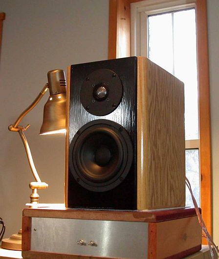

What I decided on was a 2-way "bookshelf" speaker with full range sound, using drivers that cost less than $200 to purchase and some really cool tech entered to make it sound like a much more expensive speaker.

1 - Lightweight - so I could travel with them, considering a driver that weighed in over 5lbs alone, this would be important. I decided to use 3/4" Arouco Plywood, this is a dense and high quality plywood with minimal voids, it is very flat and strong and really nice to work with. The pine veneer is very thin which demands care if you're not going to paint or veneer your enclosure, which I did not. I did not use any bracing as to keep the weight down.
2 - Low Resonance - to allow the cleanest and uncolored sound from the drivers, and since I wasn't going to be using bracing, I needed to get creative. Along came CLD or Constrained Layer Dampening, you can google it to read more. Basically this is an anti-vibration technique that adds dampening to a stiff layer such as a sheet of plywood by sandwiching a soft layer of rubber between two stiff pieces. After doing some experimentation, I found a nice technique that worked well and attached the baffle to the enclosure in an isolated fashion.
3 - Good Bass - The TangBand woofer modeled well in a 1.3 cubic foot enclosure, I wanted to make it smaller but the modeling looked really good and should rival the average 8 or 10" subwoofer. I included a amply sized 3" port with generous 1.5" radii on the inside and out. I ended up tuning the port to 43hz for the best performance, length around 5" or so. Enclosure Assembly Assembly of the basic enclosure was quite straight forward, I built a box from 3/4" plywood, there isn't any metal in the assembly of these, all seams are glued with Titebond II Premium wood glue.
Where things got complicated was the front baffle! Once the basic enclosure was made, I cut two intersecting holes in the base front baffle, these would be the breathing/clearance holes for the woofer and tweeter. Once that was finished, I smeared on a 1/16" layer of 50 durometer polyurethane adhesive, once dry this remains quite pliable or elastic and works well to create the CLD effect needed to dampen vibrations. On this layer of polyurethane adhesive I bonded a layer of 1/4" birch plywood, then onto that another layer of adhesive and the final front baffle. What I ended up with was a 1/4" layer sandwiched by two layers of viscoelastic polyurethane adhesive. This created a very acoustically dead front baffle, a rap on it with a metal wrench results is a dead thud vs. the resonant musical note you'd normally get from a piece of wood.
To continue the CLD treatment, I treated the inside of the enclosure with a foil CLD sound deadening material, this adds CLD to the inside plywood walls and greatly dampens the panel vibrations. I also glued a layer of 1.5" open cell egg crate foam to all inner surfaces as well as added some poly fill (tuned by ear) to create a smooth and mellow bass sound w/o any boominess or resonance.
The last trick I used was to bring the already small framed tweeter even closer to the woofer center by routing the woofer frame into the plastic tweeter frame by about 3/8", this brought the driver centers to about 1/2 wavelength of the approx 1700hz crossover frequency, which helps minimize diffraction and lobing.
I personally love the look of plywood so I always show off the seams with pride and finish them off nicely. In this case I sourced a 1.5" radius router bit and modified my router to allow it to be run, this guy is a handful but it makes very nice big radii! The front baffle was treated with this large radius to reduce the effects of diffraction on the front baffle.
The port also got a 1.5" radius to eliminate turbulence, the rest of the enclosure got a 3/4" radius. The back of the enclosure was stained with Minwax Espresso stain, then the 1/4" layer on the front baffle was stained red to highlight it, and the front of the baffle was left unstained. The whole enclosure was sprayed with Minwax semigloss polyurethane to finish.

I am very pleased with these and they scored a respectable 7.2/10 at MWAF, considered "above average". But most importantly, these sound very good in my listening room, they don't need a subwoofer and can play loud bass in room to 30hz, as much as many 10" subwoofers I've heard. Imaging and clarity are excellent, these speakers belie their size and can really fill a room with virtually realistic sound.
