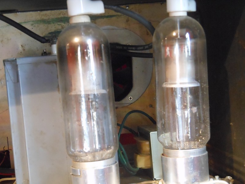

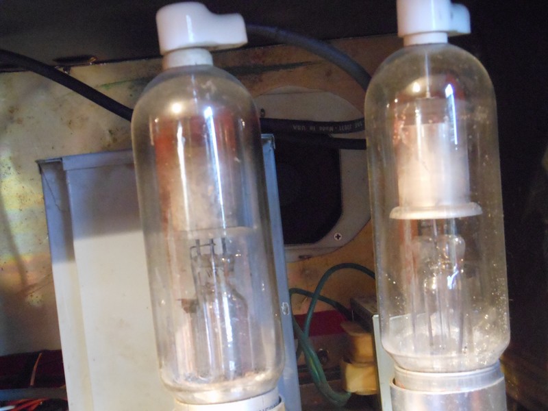

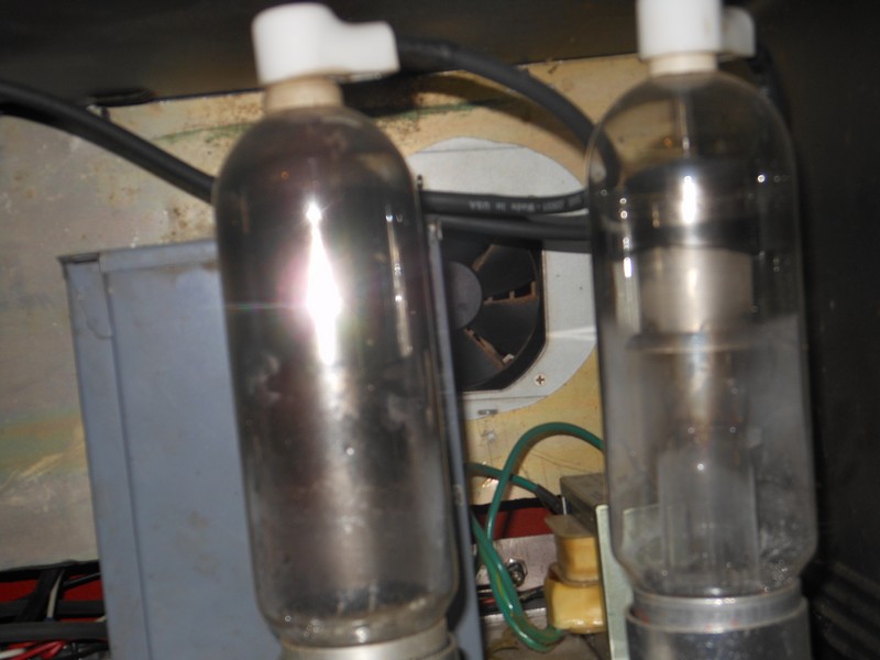

Start up time for MV tubes is a variable. The mercury needs to be vaporized completely prior to HV being applied. If not you will experience arcing, especially at a kv+. There is no set time for this, It's temperature dependent. As the filament warms the mercury, it will condense on the cooler parts, especially the glass. One must give it time to completely evaporate, and the tube to become clear, prior to turning on the HV. So you don't want to use the 5v leg of the HV transformer for the filament of a MV rectifier like you would a 5u4g.
That said. The MV rectifier can be used as a plate current meter, by paying attention to the amount of blue glow. More blue = more current flow, less blue = lower current flow.
Knowing your MV diodes are properly warmed up. Easy to see:
All pics are 872 MV diodes, full wave setup, 2kv power supply feeding an 813. (but any mv rectifier would show similar)
First pic is cold, prior to lighting the filament. Second pic is beginning to warm, Hg is condensing on the glass. Third pic HG is totally evaporated, and ready for HV to the anode.

here's what happens when HV is first applied, which immediately settles to a 20ma draw, followed by a 280ma draw when the xmit button is pushed. You can get an idea of current draw by paying attention to the blue glow.
Note the difference between the two diodes. That is also the difference between the Hg content of each. Guess which has more Hg.

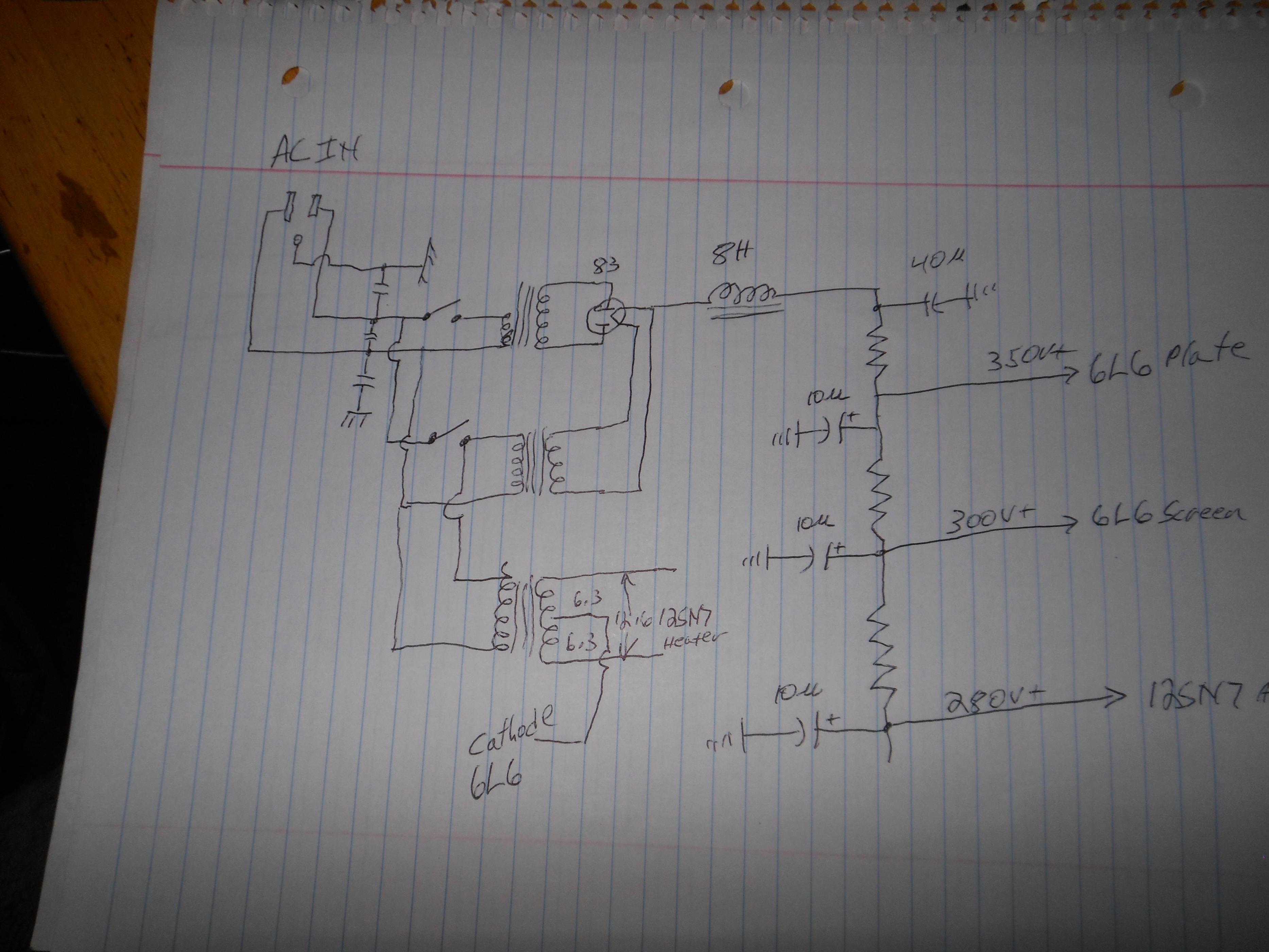

Schemo please?

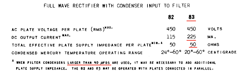

This, right here, suggests a problem. It looks like you're operating the 83 into a C-input filter. I've seen the same phenomenon with SS diode power supplies and C-input filters. Hg diodes don't have the Isurge capabilities of vacuum diodes, and are not to be used with C-input filters, but rather L-input to slow down that Isurge into discharged filter capacitors. Hg diodes are typically found in applications requiring high voltage and high steady state currents where good voltage regulation (the forward voltage of a Hg diode doesn't change very much with variations in current -- much like a SS diode) is required. This would be the case for transmitters or audio rigs that can fill a stadium with sound or plate modulate a high power AM rig. The really big ones such as a commercial AM transmitter will run off 3-phase AC (six Hg diodes).
Running an LC input filter/voltage divider. Yes the immediate flash is the caps charging. (what's supposed to happen) What happened during the power anomaly was the steady higher than normal current draw, as indicated by the glow of the rectifier. Probably around 100ma+ instead of 76ma. It finally settled down after a while. No majik smoke escaped, and all seems to be well now.

Here's the PS with the 83:
I'm no artist, and forgot the resistor values, but I can get them in a day or two.
Sorry I didn't include it earlier.
Oh, the secondary on the hv xformer is 450v. With also 6.3, and 5v. 5v is unused, and 6.3 feeds the heater on the 6L6.
