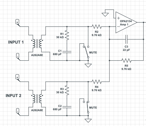

Shorting the secondaries provides a very smooth mute with no switch-pop noise. However, is this safe for the device connected to my input? The device in question is a Shure Wireless Receiver with a 100Ω output impedance.
Yes there is a transformer between device and this preamp. Galvanic isolation is nice. If you are worried you could use 100 Ohm resistors from R2 and R4 to the mute switch contacts.

Short the output, not the input, as long as there is a finite output impedance. That way it’s buffered from the source, and you also lose all the intermediate noise.
Or short after R2/4.

Okay. I have six inputs (though only two are shown in the schematic). I need to mute them individually, so muting after the mixing stage isn't an option. However, I'll try your suggestion of placing the switch after R2/R4 instead.The output of the schematic you posted, or of the entire device if there’s more of it.
Maybe you can give info why you want to mute inputs. Not because of power on/off plops of sources I see.
If it is about just muting why not mute at the primary side of the transformer?
It's an input selector. Six channels of Shure Wireless (for guitar) should be selectable with individual mute switches and summed to one output.Maybe you can give info why you want to mute inputs.
Can be done at each input with micro relays controlled by either switches or controlled electronically. Before the transformer or after the transformer. I would not use wiring from sensitive circuits to switches at all, keep connections as short as possible and leave the opamp circuit in peace. Hence the relays.
