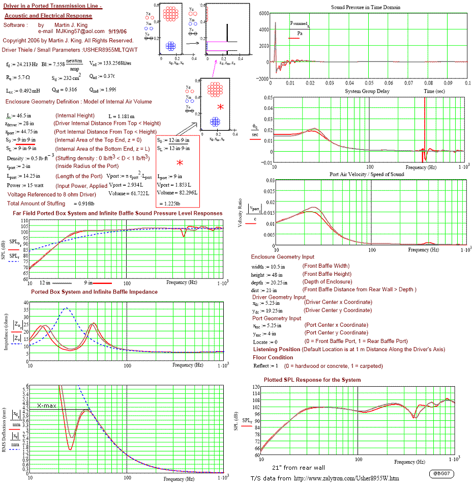

Yes check the specs, for a box volume of 1.9cu.ft. you are looking at an F3 of 39hz - this driver will not do 25hz.

Otherwise if you model with WinISD (its free) I come up with 2.2cu. ft (thats 24hx9wx24d) tuned to 30hz, gives an f3 about 35hz - but efficiency is going tio be quite low - I doubt you can stretch this driver (or any 8") to much below 35hz.

qguy,
Between 63 to 83L seem right if you chose o build a MLTL/MLTQWT and I believe the 9” width (f-3dB 25 Hz) is not as good as 12” (f-3dB 25 Hz), which has a shorter port (less ringing).The Zalytron closeout sale is each for $ 80, maybe you can afford to build 4 speakers and gain about +6 dB?
