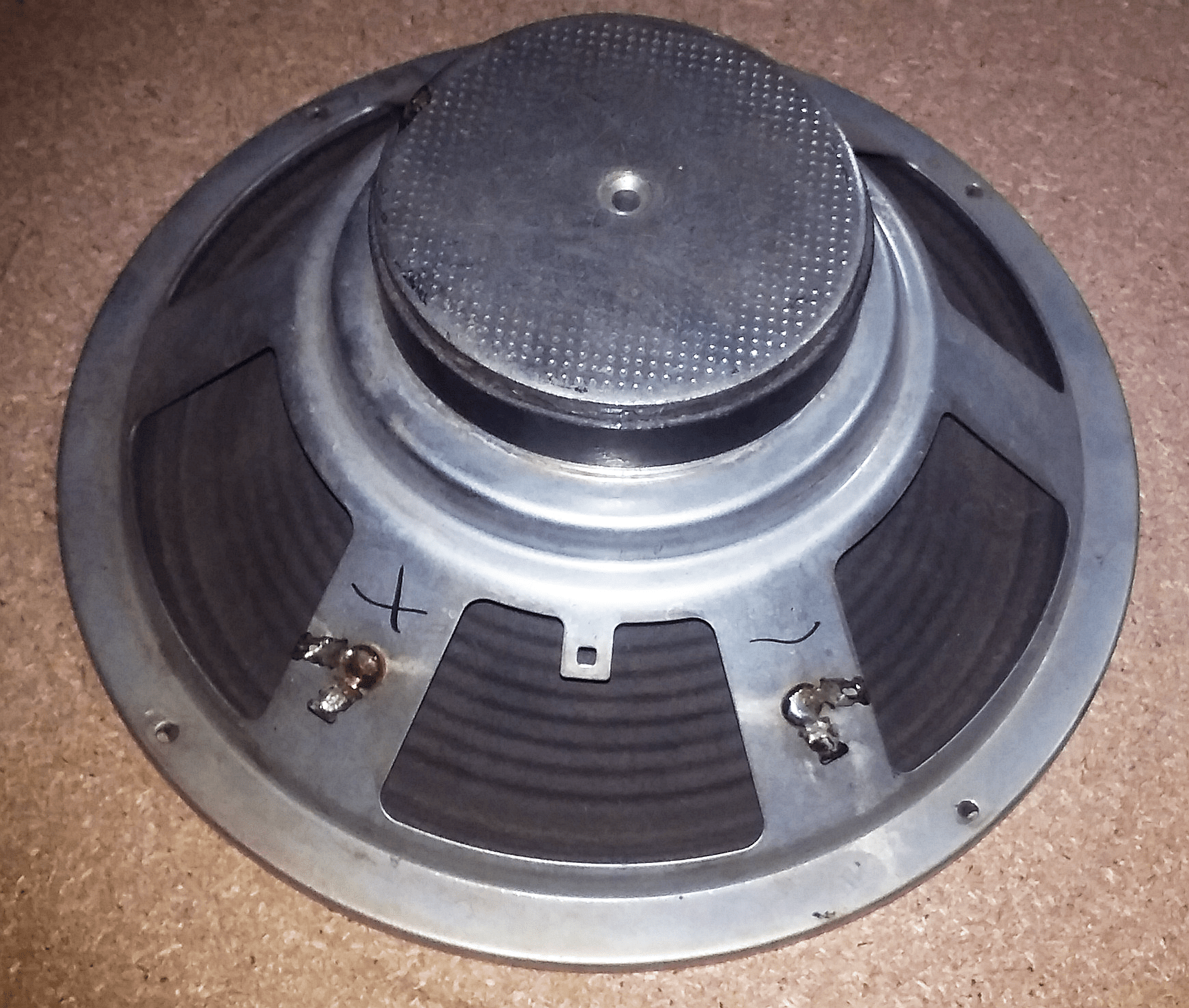

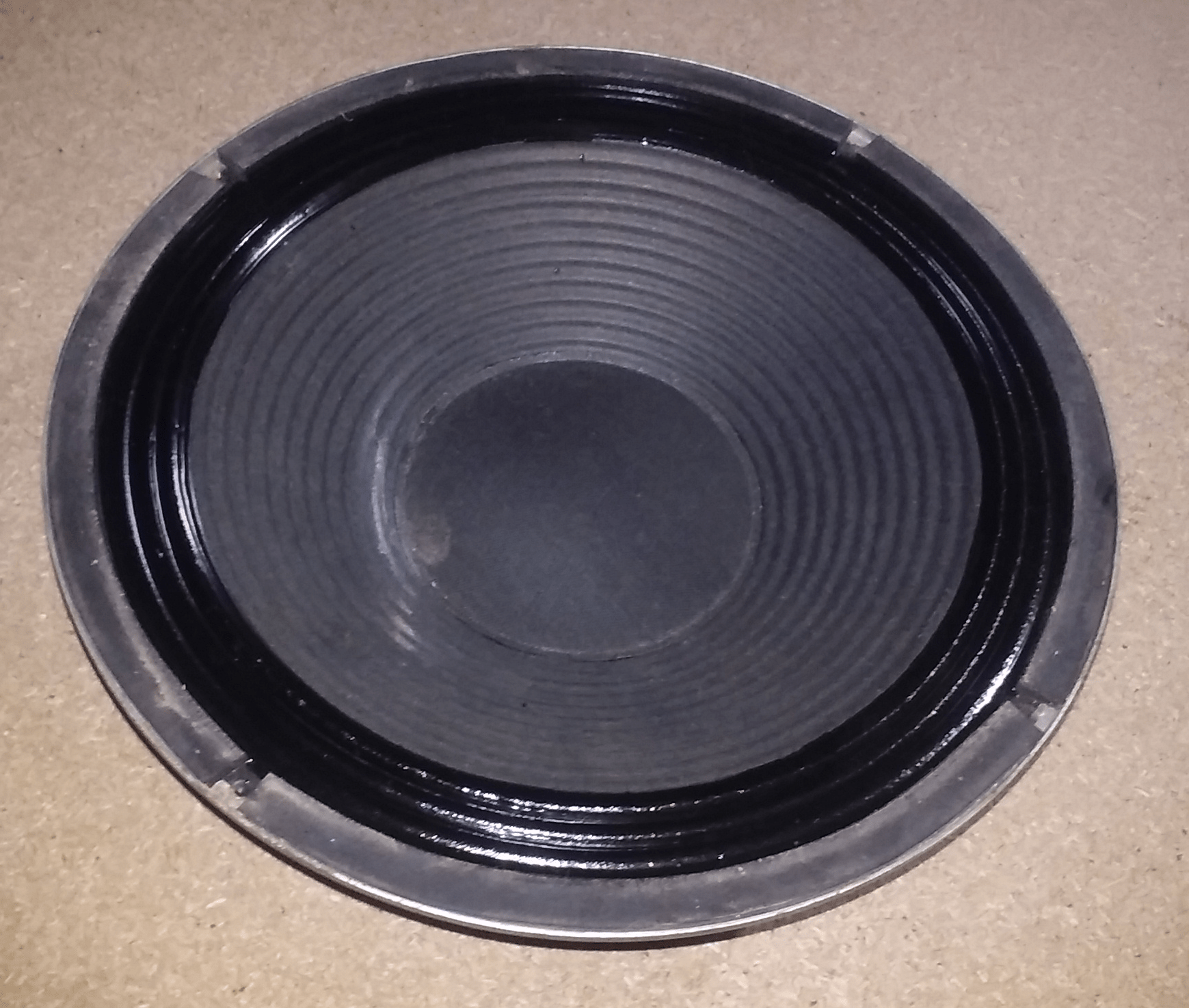

As of weight, in my particular case I also make the speakers themselves, so as light as possible in their class.
Here´s my own 10" 80W version, physically similar to Jensen C10Q-MOD1050-Celestion Tube 10, etc.
Only 1600 grams / 3.5 Lbs.
No significant savings going NEO, which in any case I can´t magnetize 🙁

No spell needed, I answered in another thread (the flat speaker cable one) showing these same speakers that on this exact same "mechanics" (frame, magnet , polepiece and plates) I can build MANY speaker versions, changing the "soft" parts: cone, suspension, voice coil, adhesives.A typical 40w 10" runs about 3.5 lbs. What is the spell you put on these, and how long will it last at 80w?
With same frame, 6.35mm plates, 102x15 mm magnet and either 32 or 38mm polepieces, in an extreme up to 45mm ones, I regularly build speakers from 12/15W paper voice coils for old "Alnico sound" to 20W Nomex ones to 50W Kapton to 80W Aluminum former (which stands and spreads heat better) to 100/120W woofers with aluminum or epoxy fiberglass edgewound copper or aluminum ribbon windings, in different lengths.
"Alnico sounding" ones use real old school "speaker cement": nitrocellulose based, while for higher power ones I use Swiss made CIBA high temperature oven cured Industrial Epoxy, as tough as can be.
