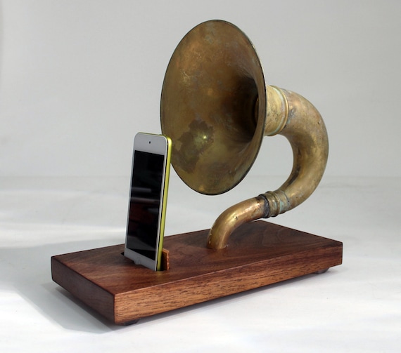

this one's been done as well...
the only two i can say anything about are the "drum speaker" and "i phone horn".
the "drum speaker" i heard sounded good.
and "i phone horns" are just passive means to make the phone speaker louder so much of what you get depends on how the horn is implemented and initial speaker quality.
i've heard a few sound quite good which is why i'm cutting up foamcore to see what i can come up with.

Let´s see what are we talking about.
Just as an example, other string musical instruments behave in a similar way, an acoustig guitar body IS both an enclosure, with a given internal volume filled with air, walls, and a vent/hole which makes it resonant at some low frequency which can be easily calculated.
It also has a "speaker" mounted on its front, which is the whole vibrating front panel, excited by mechanically vibrating strings , which transmit such vibrations through the bridge.
The tuned cabinet resonance adds a peak at a low/mid low frequency; without calculating I would guess around 150/200 Hz, to increase "depth/warmth" .
Now if you cover/block said hole with a speaker, all you get is an untuned cabinet, with a flimsy front wall to boot, which will add unexpected resonant peaks and dips .
Will it sound good/better?
In general, doubt so, except by chance, but you might like it, only way to be certain is trying.
