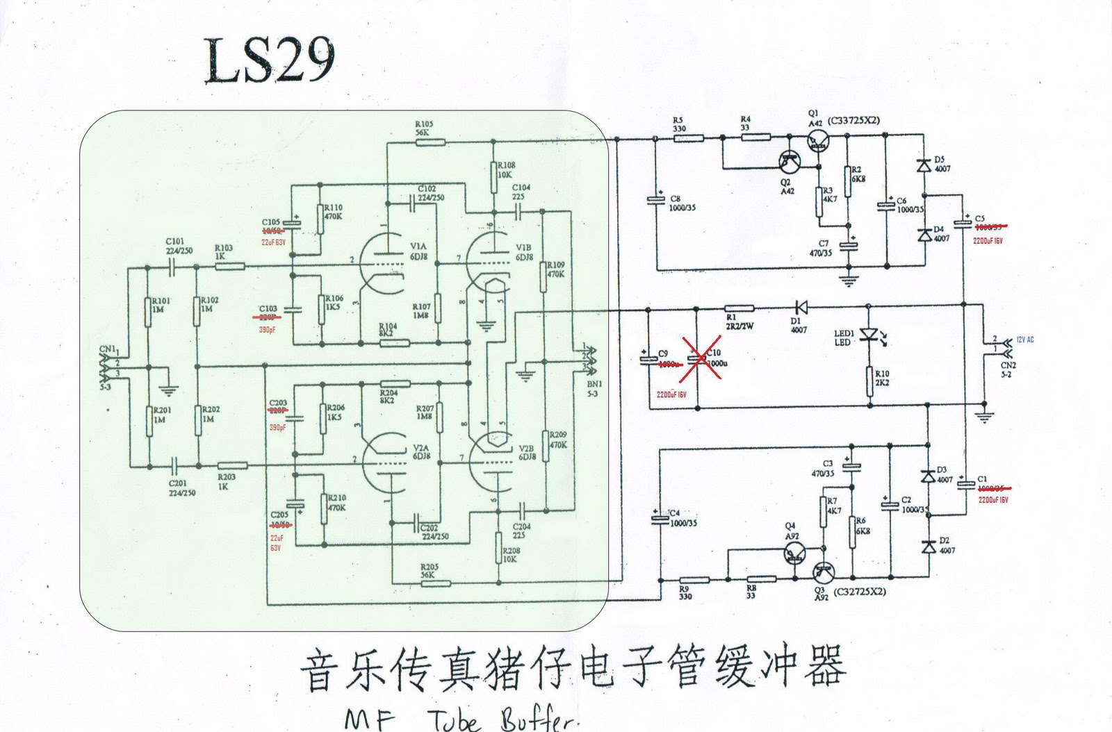

Very flattering opinions about this toy printed solid and authoritative audio- periodicals. However, which is located inside the small "keg" of well-known producer, who was being let out from 1995 through 1998 and order 170 usd in reteyle confronting I will try to explain in this article.
First of all the diagram:
Diagram of buffer (one channel)
Lamps 6922 (it 6DJ8, it THE Ñ23P- EVAS). Transfer capacitances - polypropylene (Taiwan, for 3 rubles), resistors - 1% metal-film, S2-è. As can be seen from diagram - two cascades in the class "A", envelopped by feedback.
Power source
The filament power supply of lamps is achieved by an odnopoluperiodym rectifier (diod+emkost'+tokoogranichivayushcheye resistance). Very module of nourishment - primitive quadrupler of the stress by no means _ of audifil'skogo _ quality, which ensures the supply voltage for the diagram of the order of '0-"0V from the transformer with the stress into y2V.

if you are refering to x10-d v1, i would say it is a normal anode follower + cathode follower sort of thing. the v2 is something different which use tube as a front differential amp with aid of TR ccs sort of thing. and a TR current gain stage.
Some say it use the same schematic on x-can v2 and v3 as well. I don't really know, but seriously to me, v2 is totally outperformed by simple headphone amp using simple opamp config like c-moy kind of thing - by miles. Though I haven't tried v3 but as schematic is almost the same I would think it shouldn't be any better.
Wonder why these gears won so many prizes as it didn't sound nice at all. and many say v3 sounds a lot better than v2 I really can't see why. :whazzat:

Hi, all!
Do not open a new topic, I want to ask a question about tube buffer x10-D .
Is anyone tried this tube buffer with Russian tube 6n23p-EV (russian military), if he tried to play, is giving a good sound?😕🙄
Here's schematics:😉
thank you!
